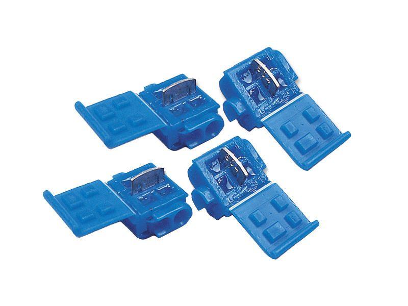

Very easy to do. Did it on my Pathfinder w/ Bose.
- Run power as you normally would
- For remote- either tap into fuse or the remote wire on the amp
- Since there are no RCA jacks, you'll need a line output converter, which you can either tap into the speaker wires coming out of the amp or tap directly into the speakers themselves.
And that's it. Done.
Just keep in mind, while it will sound pretty good, an aftermarket head unit will sound 100x better...
You can probably google the amp schematics to help figure out the wiring.
I used wire taps similar to these instead of splicing any wires.
