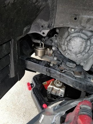

Here's a pic, courtesy of one of the veterans from this forum:
Part no. 31726-1XE0A. Ask deleaer and see if beelineparts.com has it
