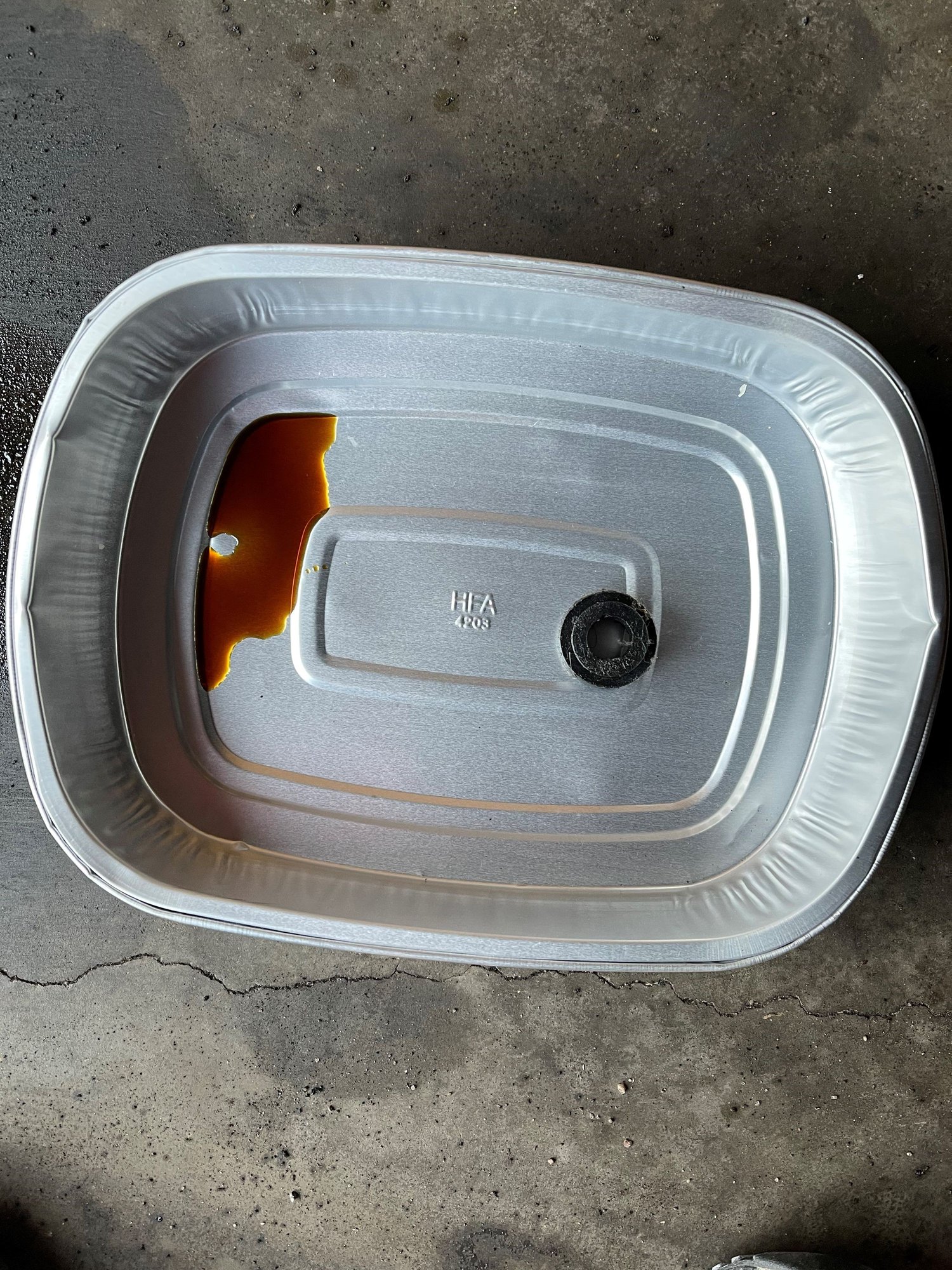

Hello Max family,
Forgive me if this has been brought up somewhere but I cannot find it. I have a 09 Maxima SV sport package. I noticed this past Saturday morning that some oil is leaking from my car. it's not alot. I will say that morning that I noticed it there was more on my garage floor. Again, not alot but more than on the attached photo. It's leaking from somewhere on the passenger side of the engine. I have attached a photo. Does anyone know what this might be? I don't have access to lifts and whatnot and was too lazy to get my jack out and do that to see where it may be coming from. Lol! Any info would be greatly appreciated.
About this much every day since I noticed it.

"I don't have access to lifts and whatnot and was too lazy to get my jack out and do that to see where it may be coming from. Lol!"
Go get your jack and look.

The Black piece you have in the middle of your pan is part of plastic "rivet" or connector. The male piece has a head and tail and would fit into that female piece to secure a plastic piece to the frame. It wouldn't have any impact on oil leakage.
The oil itself looks clean leading me to believe it is from the oil filter or the drain plug (perhaps whomever change the oil last forgot to install a new crush washer??? Unfortunately, you will have to crawl under the car to look or take it somewhere you trust.
If that all looks fine, the next step would be around the valve covers but I would expect the oil to be more "dirty"
Let us know what you find.

That sounds logical. And yeah I just put that piece in the pan because it was a tad breezy and didn't want the pan to move. My car is at my mechanics now. I'll update when I hear from him.

Happy to report my mechanic said it was the plug. he noticed the washer was missing from it. Whew! You were spot on Lt. BUT I will be stopping by the spot where I got my oil changed bout a month ago and asking why they didn't notice that and or how they forgot to put the washer back on. Didn't have this issue before I took it there.
