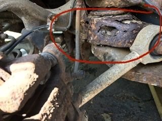

Hey everyone! I have a bit of a problem! I have a 2009 Maxima. It has been sitting for several years.
I’ve been doing someone work on it recently and noticed my rear crossmember where the Radius Arm connects is rusted all around and is hollow. How do I go about replacing the whole crossmember? I can get a bare one for about 500$. Or one with everything already attached (bearings, hubs, control arms, etc) for 1000$
Is it a job for an average diyer or should it be left to the pros? I’ve invested about 3000$ in repairs so far so kinda don’t want to trash the car but also don’t want to spend a ton at a shop or stealership.
Thanks for any help!

Man, she is a crusty one! A hoist, torch, and solid pry-bars are in order for this job.

Yes it is haha so what if I don’t have a hoist or a torch? Haha
I’m just working in my backyard. I was going to put it up on jack stands, take my exhaust out and work on the bolts for everything but worried my power tools aren’t up for the job since they aren’t air powered. Any other suggestions? Haha
I called local salvage yard I can get just the “K Frame” for about 500$ or the whole unit (wheel bearings, control arms ect) for about 1000$
So if I can tear out my whole suspension then the other one should be good to bolt in.

Man, this will test you patience but you can always try. There is no harm in that and that can, as you have alluded to, save you some money.
I would have someone look at the rest of the car to make sure she is worth all that work. You don't want to commit all that time/money to discover there is a serious structural issue with the integrity of the body of the car.
Go get your penetrating oil and start soaking every bolt/nut you're gonna have to deal with. I would liberally spray them 3 times. Give them a day to absorb the penetrating oil between soakings. Also take a wire brush and scrub down every exposed bolt/nut to remove any surface rust. You want the least amount of resistance.
And an impact gun will be your friend here. If you try this without an impact gun, then you'll run a serious risk of breaking bolts....and you don't want that.
Safety: make sure have have some redundancy for your jack stands. Put your rear tires under the car near you and the sub-frame so if she goes, then you're safe. Just remember that the tire needs to be in a place where you could put a jack stand so it can sustain the weight of the vehicle.

I don't think you'll break the big bolts...it will just the little dinky ones. 15mm head and smaller are the ones to worry about. The big ones will be fine. Use a breaker bar on those to break the torque and then zip them off with your impact gun. I have a heavy duty 1/2 inch x 18 inch breaker bar which is rated at 500 ft/lbs. Its great. (https://www.princessauto.com/en/1-2-...t/PA0008753659). If you can get something like that, then you should be okay.
