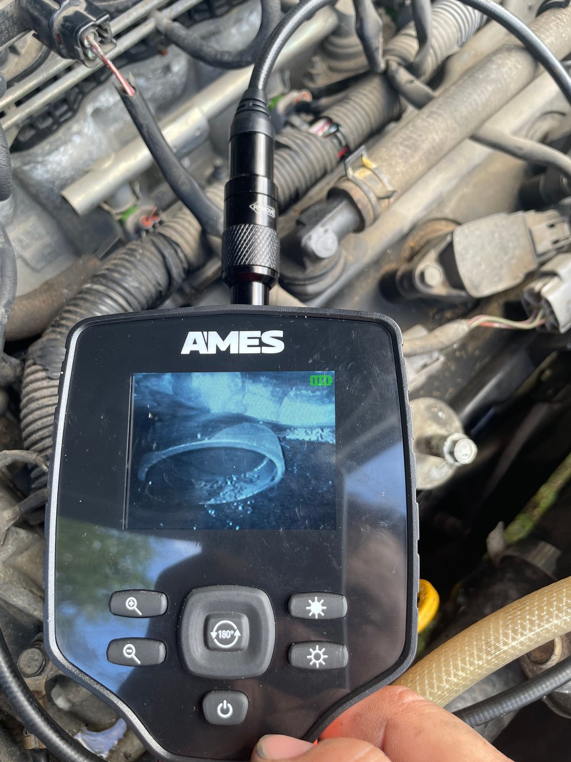

I found it
All was good but in February was a very bad weather, it was freezing and I found a water plug out I’m not sure if that’s the name but now I mes to figure out how to change that plug, any ideas?

Need to remove the head
Originally Posted by LtLeary
Doing it while the engine is installed will be fun...you need to remove a lot of "stuff" to get good access to the freeze plugs. But once you do, this you tube is pretty good
How to Replace Freeze Plugs | Freeze Plug Installation Tool - YouTube
thanks for the video, now I have a better Idea to change the plug, but I need to take de head off to change it, that’s bad haha
