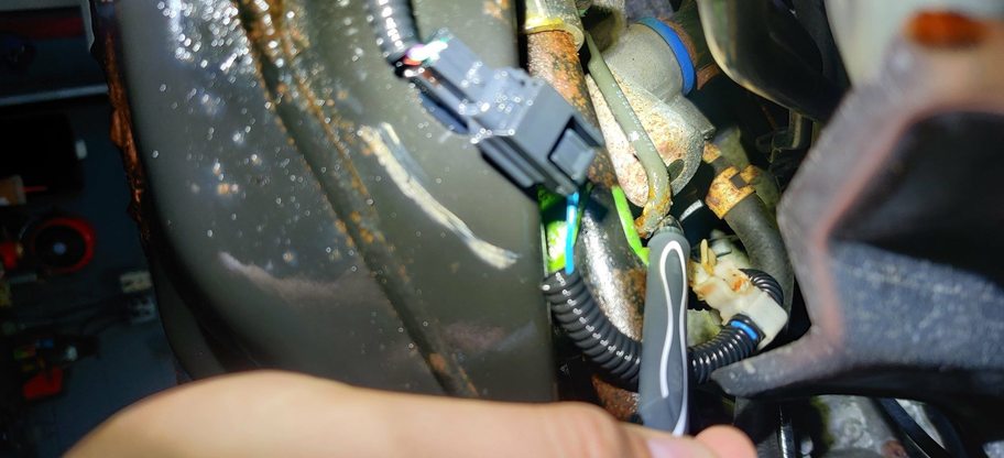

Thanks guys. I talked to the dealer this morning, spoke to the service manager, who was at least able to explain better. According to him, the line on the gear assembly itself is what popped off, likely due to rust and then pressure of the system. And said that can't be replaced so that's why they have to replace the "full rack". Asked him to send me a picture (second below). Appears not attached but hard to tell? So my last question ... think that's valid? I'm thinking it might still be worth it to tow to a mechanic I trust as the overall cost to replace (even if that's actually the problem) will still be a few hundred cheaper (including tow/diagnosis fee).

IMO - having anything repaired at the dealer is always the most expensive and my last resort. If you have a mechanic that you trust, you can always call the place and explain the situation to get a quote. That will save you from towing the car for nothing. This is more than just a brake job. So not all mechanics will want to touch it.

Rust sucks. That line will be a flare fitting. If the line is rusted out but the fitting can be removed from the rack, then just replace the line, the rack is still fine. I'd pull the old line, cut and bend up a new one with SS tubing, throw a couple matched flare fittings on it and call it a day.
Worst case scenario, depending on where you are and yard accessibility, go pull a used rack from a yard. Could probably even pull just the line.
