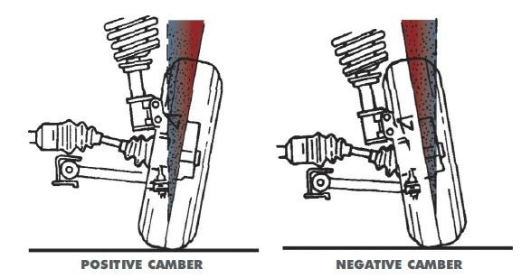

Take it to a legitimate alignment shop (you might have to research this). Have them document the specs. If it is out of factory specification, then you have to determine which part is contributing to that. A shop that actually specializes in alignments is going to be able to find that out for you. Worn springs/struts will typically result in cupping of the tires. This video might help you narrow it down, though -
I've had the inner front tires on my car wear out in two instances: (1) front passenger side ball-joint was shot and (2) passenger side front strut-mount was shot. Both resulted in negative camber. In my case, the ball-joint caused wear to both front tires, whereas the strut-mount only caused wear to the front passenger side tire.
Replacing struts/springs with non-Nissan parts is always going to result in a different ride quality. Some will be softer while some will be harsher. The ride with Monroe will be softer while KYB will be harsher.
Looking at the picture, you can see how if a part fails, then the weight of the car is going to force the car into a position of negative camber, which is going to wear the inner side of the tire. Find that compromised part.
