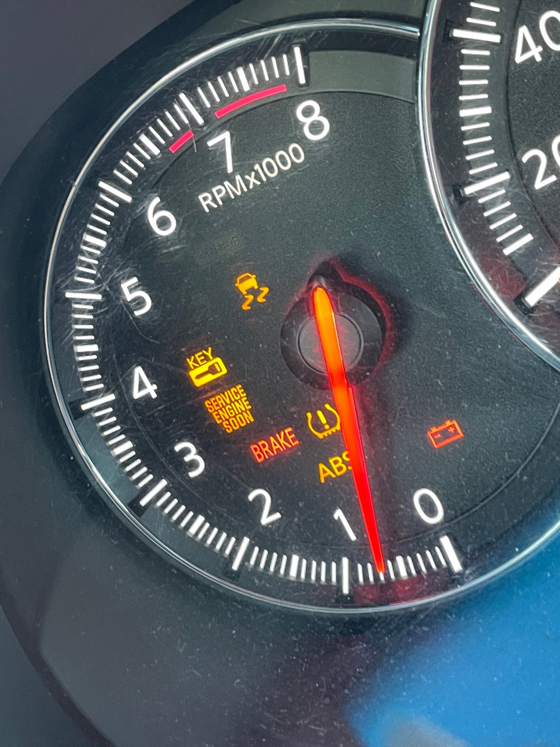

Have 2012 Maxima. Vehicle starts and allow for a brief rev up of engine. Then will not respond to the gas pedal after initial startup. Very strange behavior! Vehicle will then continue to idle just fine with no issue at all. Just will not respond at all to the gas pedal being pressed down after initial startup. Security issue? Can’t be a fuel pump issue I don’t think. See the attached pic of the dash board too. Almost all light are on.
Dash lights

Get a voltmeter and let us know the voltage before and while running at the battery. Looks like (and I am speculating without readings) you may have an alternator issue.

I'm with the Lt on this one, most likely a bad alternator.

Our 7th gens are really susceptable to voltage anamolies..a lot of weird things can occur if it doesnt get what it needs. But, recall that we are just spitballing here. We need more data to be sure.
