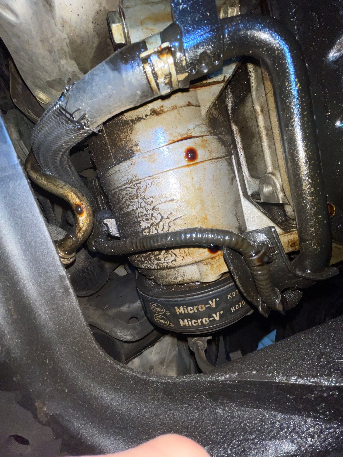

for the life of me i can’t figure out where this oil leak is coming from. the a/c compressor is wet all the way down passing the oil pan.
i already cleaned the underside of the engine to see where it’s coming from and only the compressor and the oil pan and parts of the control arms were wet.
A little background on the car itself 14” with 238,000 miles on it. So i know seals & hoses are gonna start to fail me soon. i’d just like to know where this leak is coming from. thank you
to anybody that replies. (P.S pls don’t shame me for the fram oil filter it was the only they had in stock at the parts store that day. i already got the mobil 1 filter ready to go)

Bank 2 valve cover is what's leaking down the front of your motor. It's the corner above the alternator.

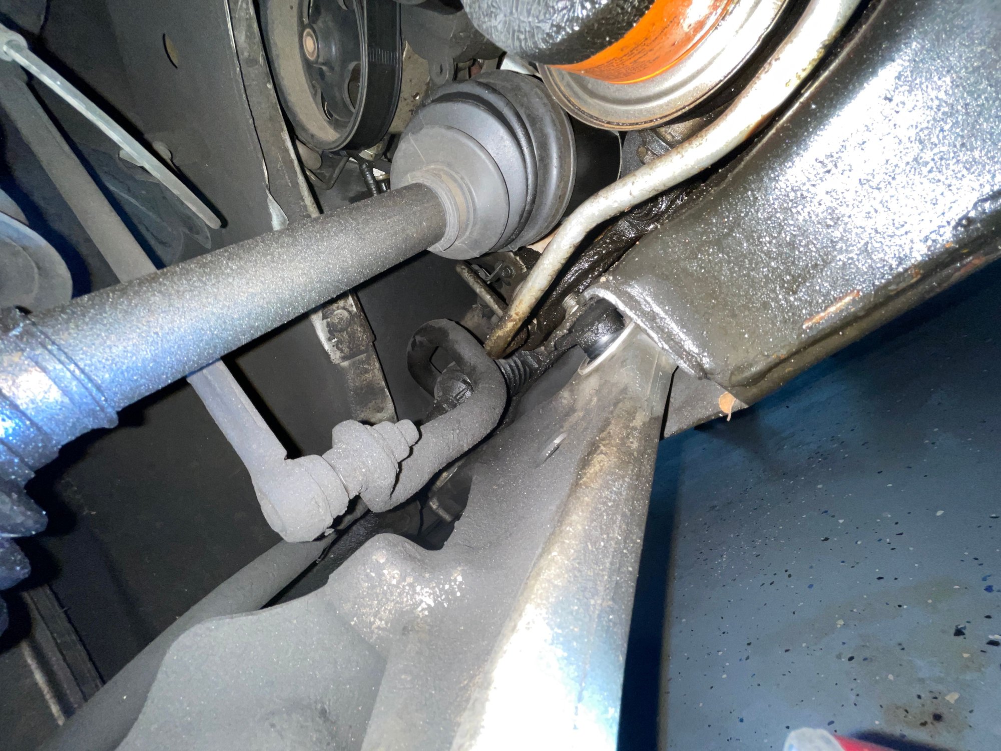

Axel seal comes next - I have to DIY on list (spray down w brake cleaner, drive a few miles, then check that axel seal)
i changed out both axels last year but when i pressure wash everything and i mean literally everything i’ll report back my findings. thanks again for the help i really appreciate it.

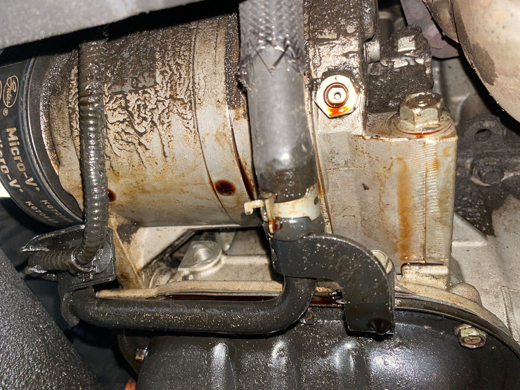

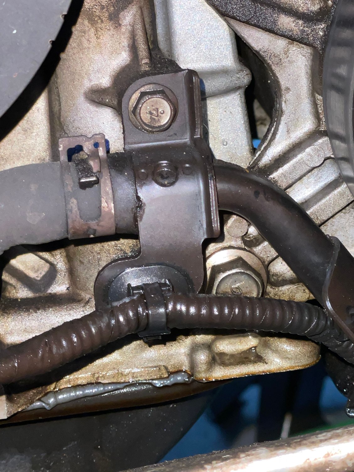

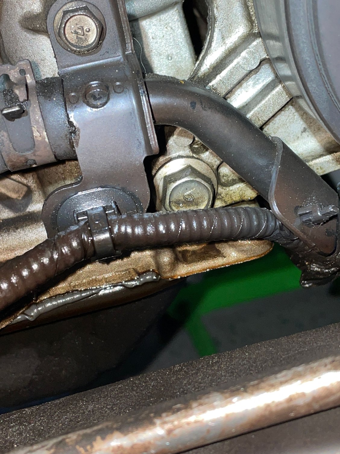

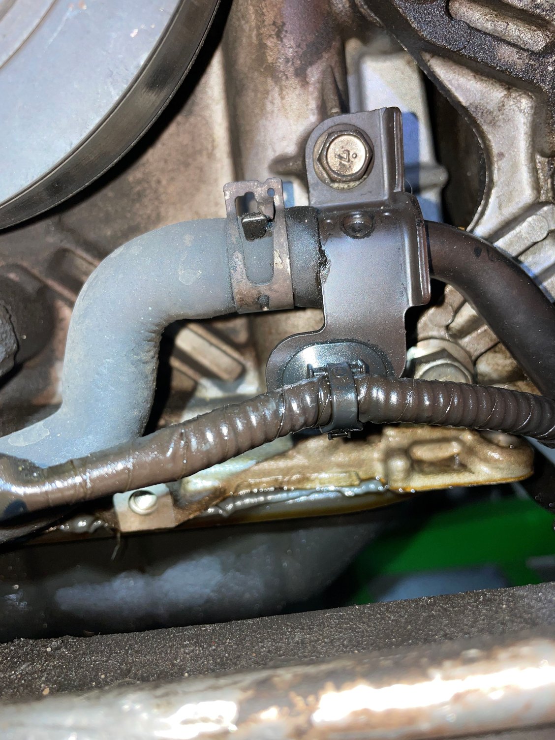

well fellas, i think i found the culprit, the oil pan gasket. everything around where the gasket meets the block is wet and everything above it is dry.
what do you guys think?
everything around both the valve covers are dry.
although i’m 90% sure it’s the oil pan gasket, how does the oil make its way to the compressor?
i can upload more pics if need be
EDIT: just found out nissan doesn’t use gaskets on the oil pan. Just using RTV will be enough ?

RTV is what the factory service manual calls for. Looks like it's so bad that it's leaking under pressure and saturating everything. The grey sealant squish doesn't look factory. Can you get underneath it with the engine on and watch it leak?

Ok reporting back after being under the car while its on, i didnt see no drastic oozing coming out from the oil pan but i did notice that it did ever so slightly get saturated where the RTV is at. I believe it starts to become more prevalent once the RPM's go up and its under load.
As of right now i got my big-*** shop fan pointed right at the oil pan so it can cool down and i can atleast re-apply some fresh RTV while the new pan arrives.

What's wrong with the old pan?
RTV is applied during part installation. Pull old pan, clean both surfaces, Apply Ultra Grey to pan, install, 24hr cure (at least) done. Permatex The Right Stuff is insta-cure. The black stuff.
The FSM calls for an 1/8th" bead on the pan. I can post the FSM dox if you want, but it's not rocket science. Well, maybe it was for whatever monkey screwed it up last time.

Understood. Thanks man you've been very helpful. i’m starting to take off the 10mm bolts now.

btw i got the job done & it’s been 24 hrs to let the RTV set. I’ll soon see if that was where the leak was coming from.

Clean the oil leak area again.
Wait a week
Report back your findings.
Good news the leak stopped its been about 2 weeks and haven't seen any leaks or the oil seeping through the gasket. Although i did get a different type of gasket maker. I ended up buying "the right stuff" because i didn't give the first gasket sealer shown in the picture above enough time to dry. I ended up dropping the oil pan twice in the end after the first day. Since applying the right stuff i havent seen any leaks. A BIG THANK YOU to everybody on this thread for helping me out! couldn't of done it without y'all
ayeimjustmartin is offline
Old 03-05-2022, 02:57 PM
ayeimjustmartin's Avatar
Join Date: Jul 2021
Posts: 27
The reasoning behind me thinking about running thicker oil is cause of my high mileage, but youre right im going to stick to 5w 30. I woulda thought that by now due to the mileage my rings would start giving way and i would be burning oil but miraculously im not burning oil yet! *knocks on wood*
Thanks again for your help buddy! You were a big help!
Old 03-05-2022, 04:40 PM
User1's Avatar
Join Date: Jun 2018
Posts: 2,448
Cool! Permatex is the way to go. Use it on anything on any car that calls for liquid sealant. Engine looks a lot cleaner too, that's always nice.
