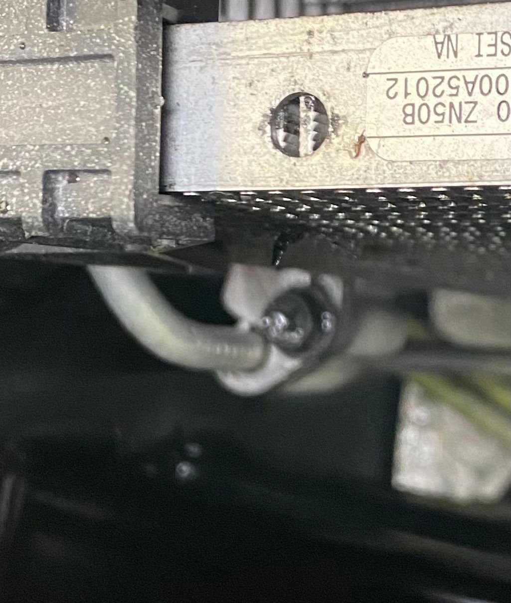

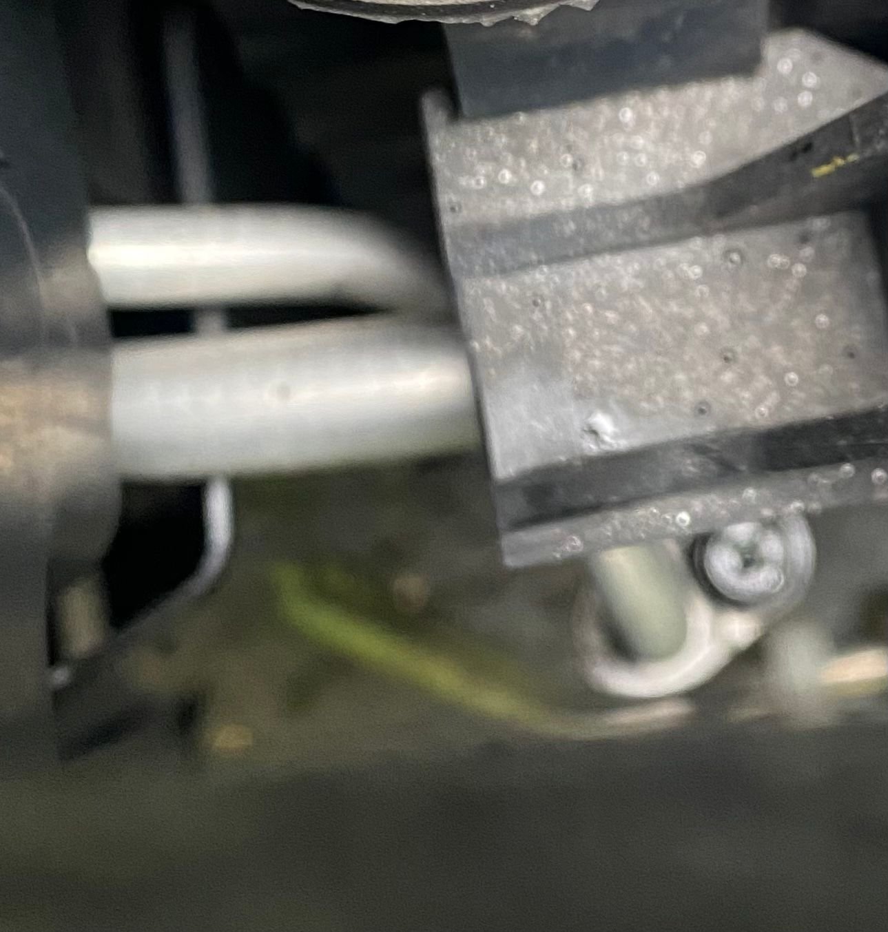

My daughter’s 2010 SV is leaking coolant and it appears that it is coming from this line set? It was raining all day, blew it dry and I believe it’s coming from here. All though, maybe the radiator has a hole and it’s spraying fwd on to it. The lines are in front of the AC condenser. I just can’t tell and wanted opinions before I go ripping everything apart. She has no heat too.

Use a pressure tester on the radiator and you can quickly tell where the leak is.
Having no heat is a symptom of low coolant.
