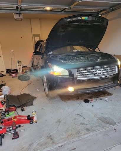

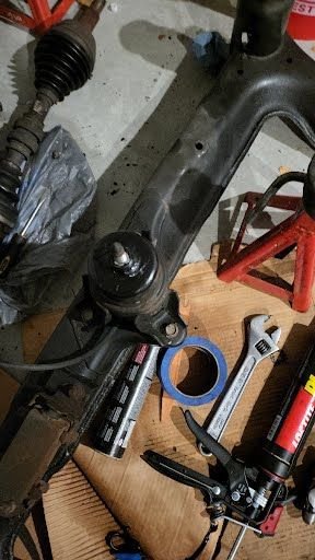

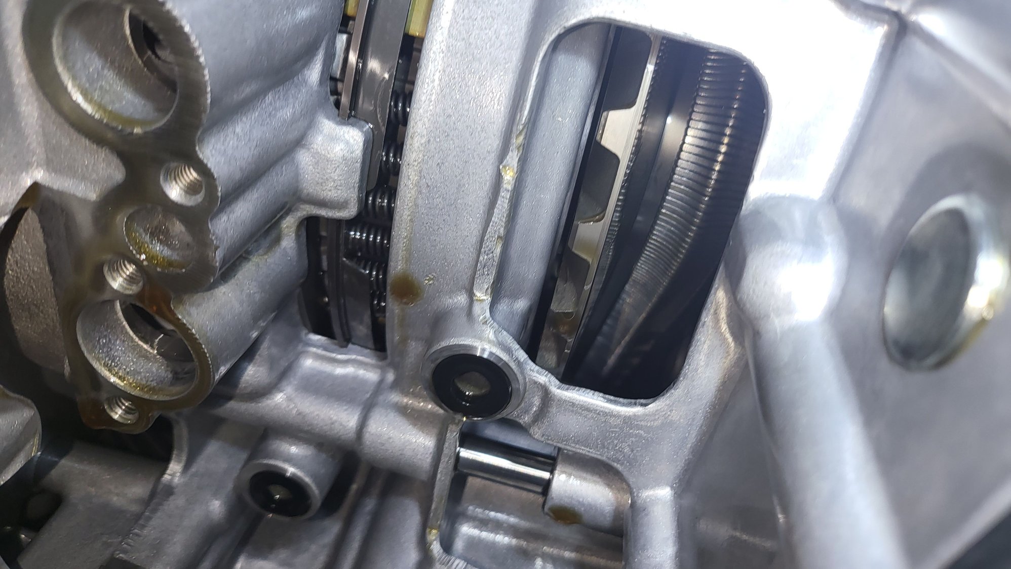

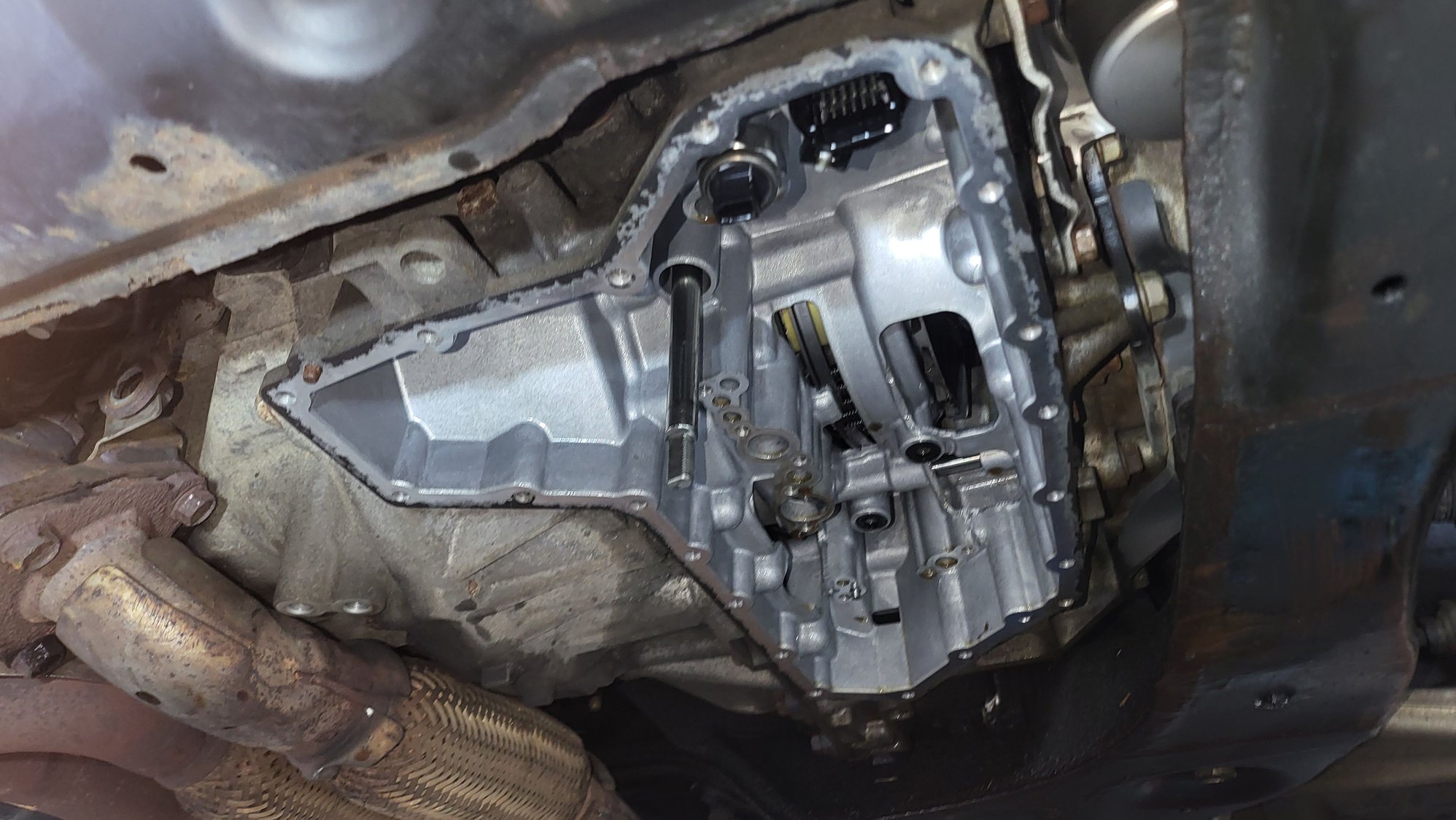

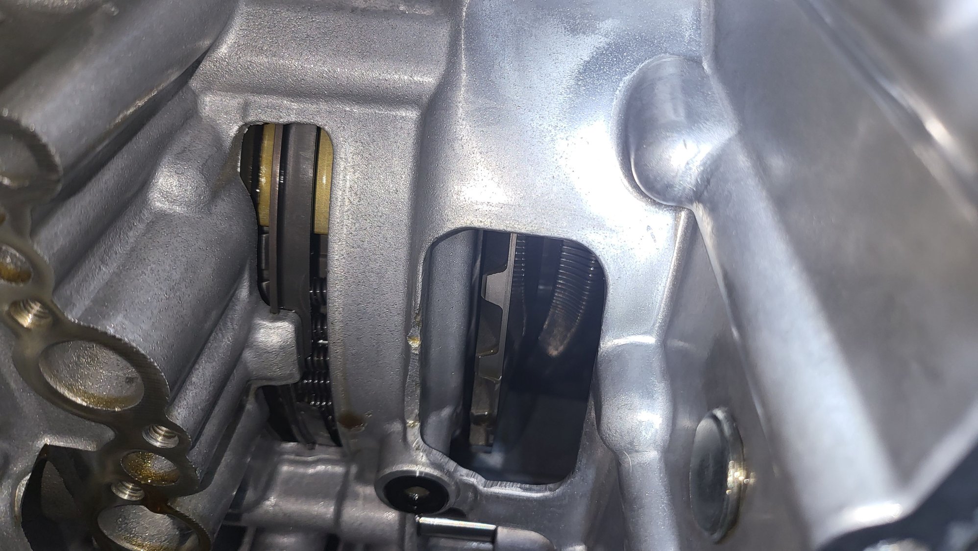

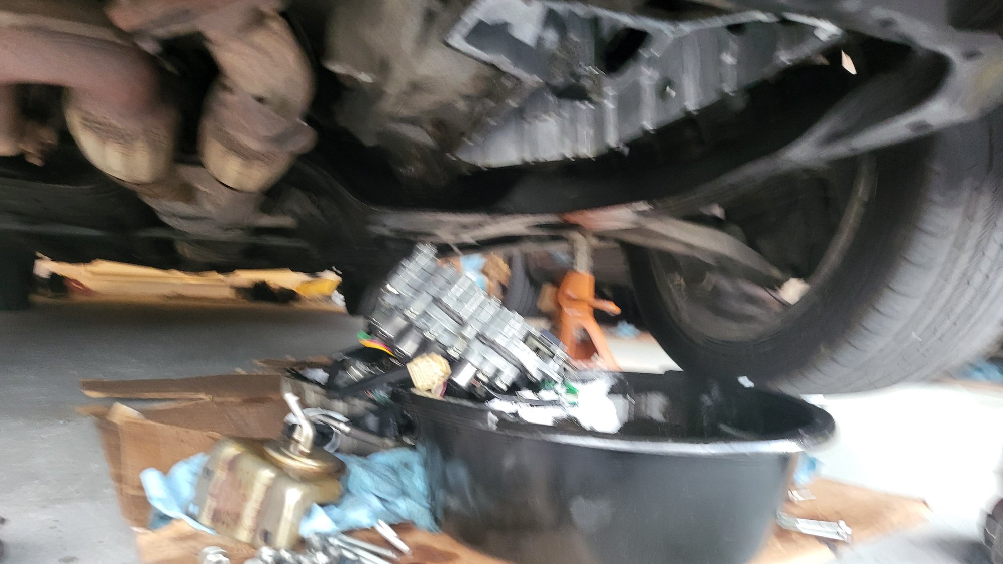

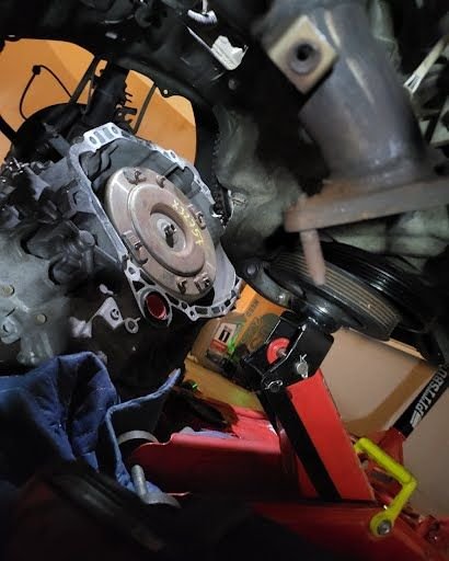

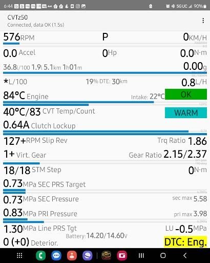

here are some pics of the cvt app and the old trans and the poly mounts.
I also cracked a little bit of the block putting the new transmission in : (.
But So far so good! also you can see that the virtual gear goes past 1 now! The car pulls nice and a much more solid feel with no vibration in cabin and no more yanking and banging from the old mounts lol.
