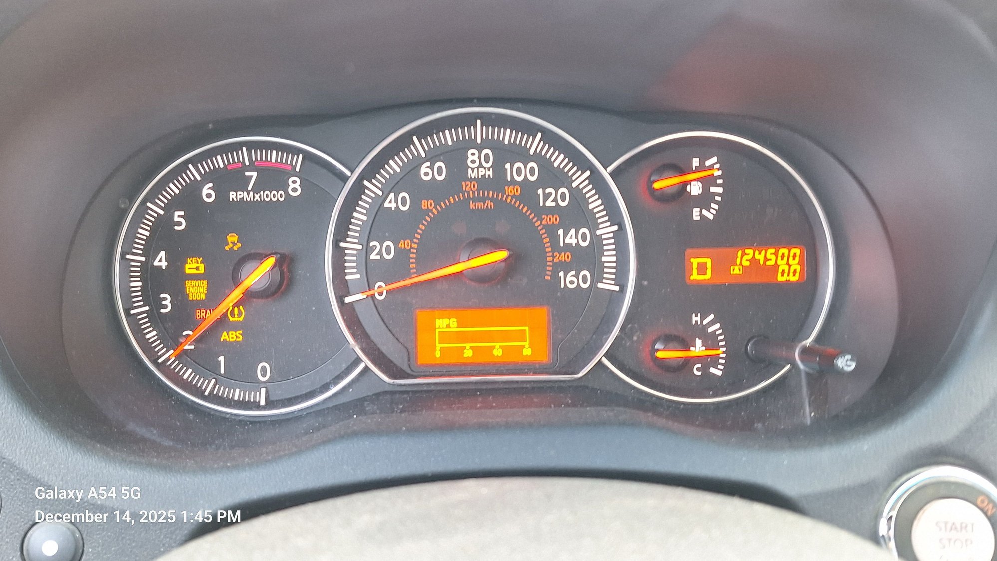

Hi everyone, any help is appreciated.
I took my 2011 maxima to Walmart to have 2 rear tires installed and 2 new tpms sensors installed as well on the same rims. They had to program the new tpms sensors. When they where done and I got the car back several of the lights on the rpm guage where lit up and the speedometer was not working. Since then, i've changed out the VSS twice and have replaced all four a b s sensors/cables and it still has not resolved the problem. Below is a picture of the dashboard while on the highway. This model is a platinum edition. I don't know if that has any relevance to the issue. There is no wheel speed sensor that i'm aware of only the ABS lines and the VSS located on top of the transmission, which like I said earlier has been changed twice to verify the 1st new replacement wasn't faulty.
Not sure what else to do or where to look. Any help will be appreciated.
Thanks.

First this I would do is a battery disconnect for 30 minutes to reset the computers. While the battery is disconnected check your brake fluid level. Low brake fluid level will trigger the brake and anti-skid light that are shown. Your check engine light is on so have the codes read for faults and go from there.
