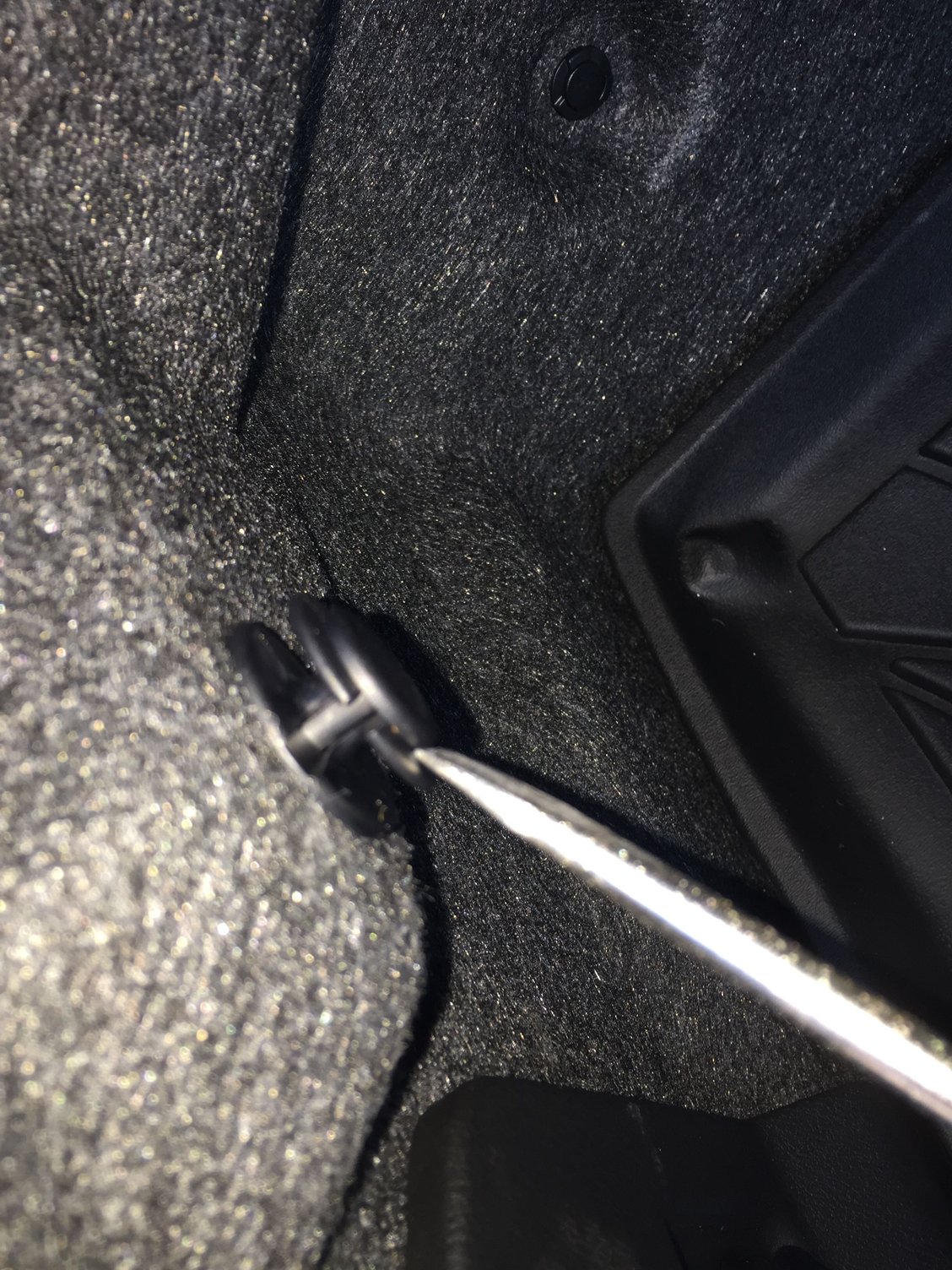

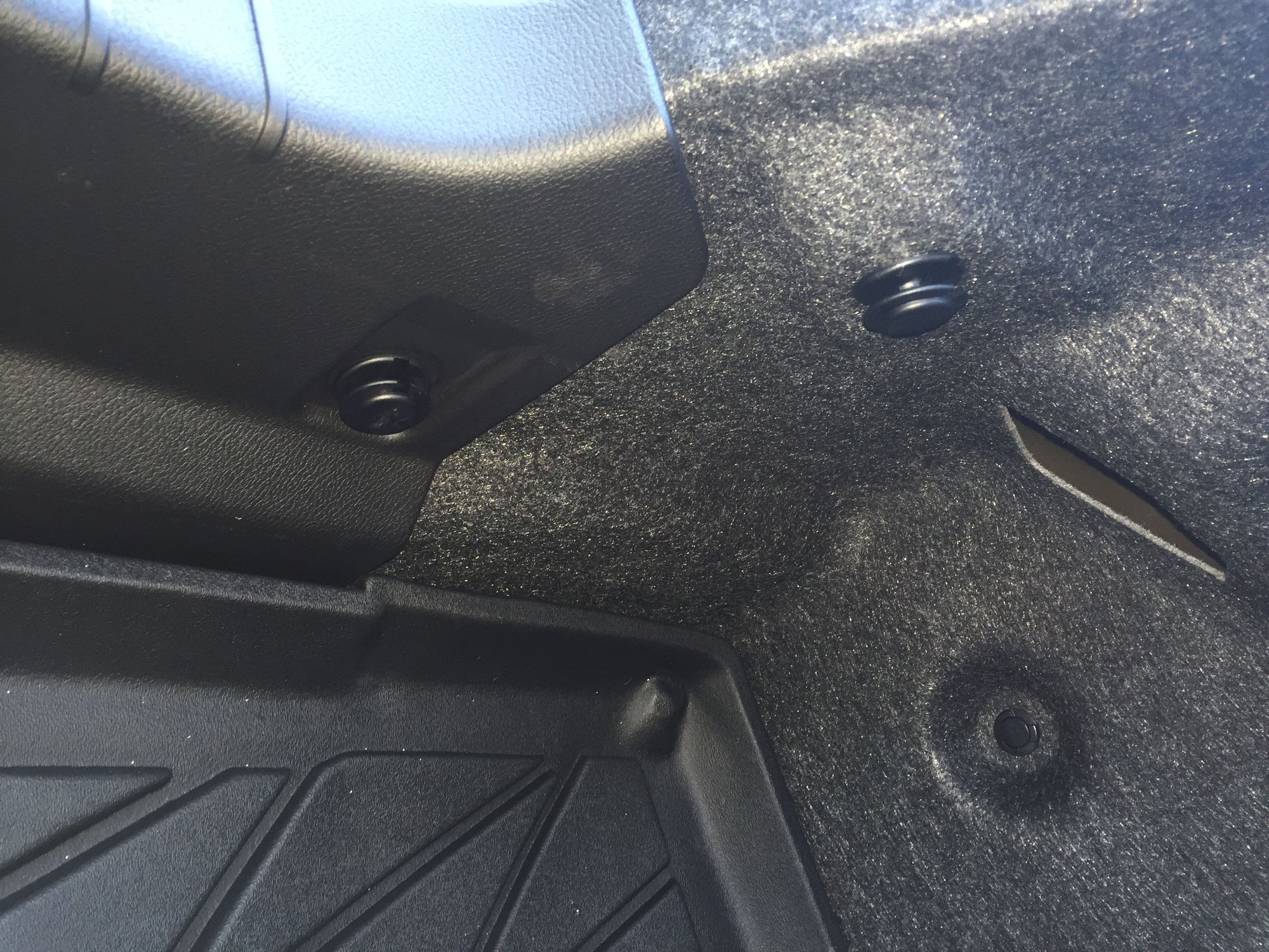

Locate the two tabs shown here.
Use a flathead screwdriver to pop this tab up off its base...once popped up, you'll need to put your screwdriver between the base and the trunk liner and remove the base part.
