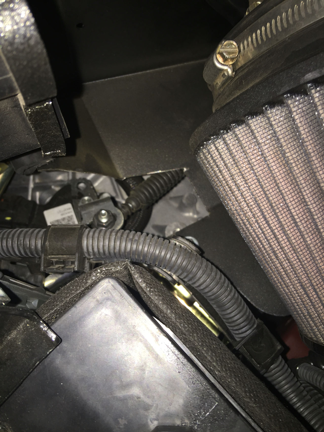

You have to cut a piece of the guard by the shifts cable the intake is made for 2012 i did that on my

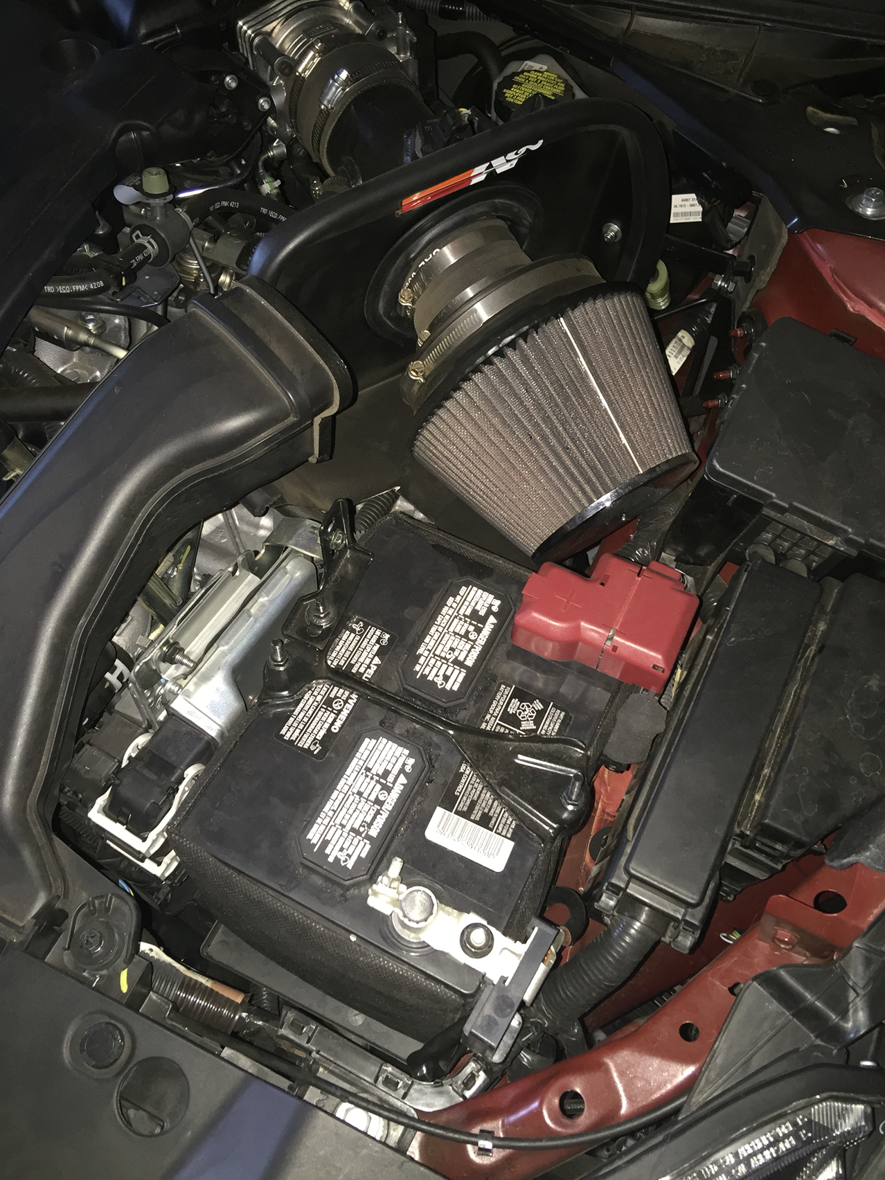

Here is a picture
Attached Thumbnails Help!  Installed K and N intake-photo340.jpg   Help!  Installed K and N intake-photo508.jpg

You see the part i have to cut if you want to add the stillen pulley let me know so i can give you the belt you going to need stillen dont have not try it on 2016 yet but i did that belt is hard to found so make sure you have before you donthe pulley

Yes you have to cut it remember this intake is not for 2016 that is the only thing you have to do to make it fit it will make a big difference and sounds good
