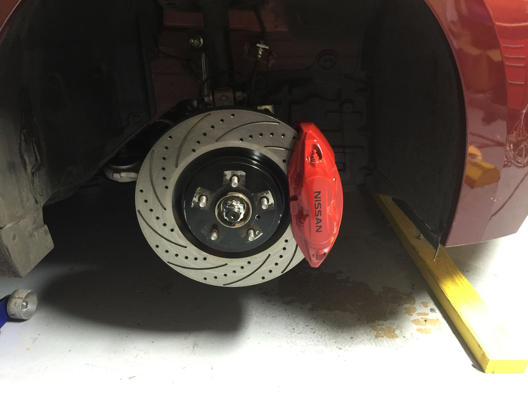

Yes i just did my front and back there is only 2 people with that kit here on the furum so far on a 2016 is not that bad to do it

What did you use to paint them?
Old Feb 22, 2016 | 06:07 PM
A36-SR's Avatar
Joined: Oct 2015
Posts: 476
From: Arizona
Ceramic high temp paint with high temp nissan decals, stop tech drill and Slot rotors and brake line.

You can get a set of calipers on ebay and rotors they bolt on like stock the only hard part is to cut the rotor guards just because the the rotor are bigger then stock and you need short bolts to bolt the brake lines to the calipers
