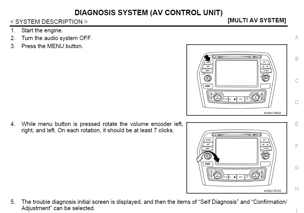

Hi
I found an option to update head-unit software vie SD.
to access update menu, follow the instruction (found it in FSM):
then select confirmation, then system update.
my unit's version: 139
I want to test if we can update our units, and install android auto+apple carplay without replacing it.
Can someone with a newer version,that has android auto and apple carplay, backup his SD card and upload it for us? i will test it on my unit. it is non-Bose version. (you can see from the dusty unit, i have nothing to lose )

After some research, we need a software update files like this for maxima units
It's for LCN_2kai unit
