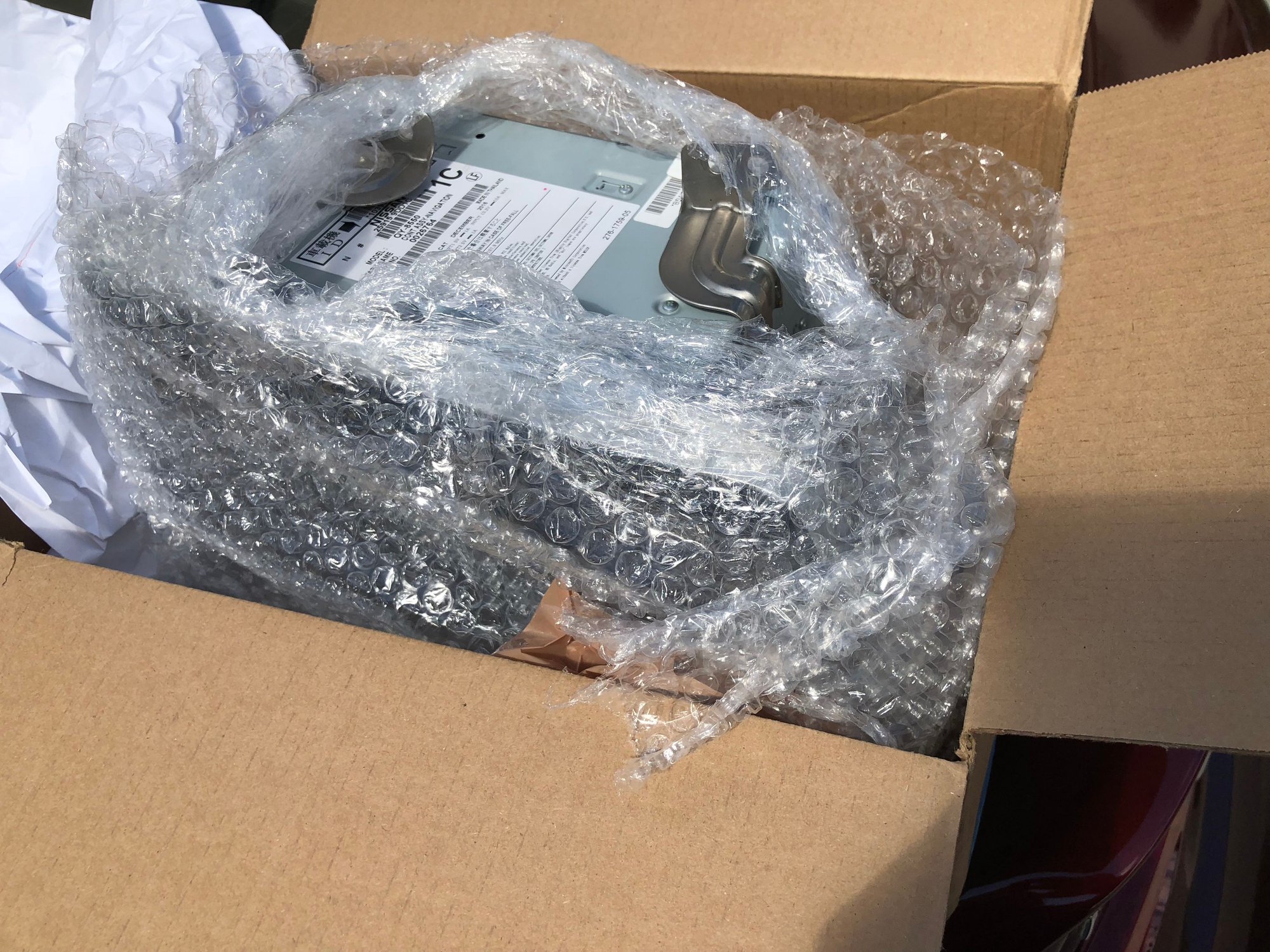

Eric Fontana's Avatar
Joined: Nov 2017
Just arrived!
It just arrived today, installing tomorrow, has an SD Card in it.
Old Jan 20, 2018 | 11:23 AM
  #213
Joined: Nov 2017
Angry No joy :(
Took about an hour to remove the original unit, installed the one from eBay, doesn't power on. Had to put the original unit back in.
