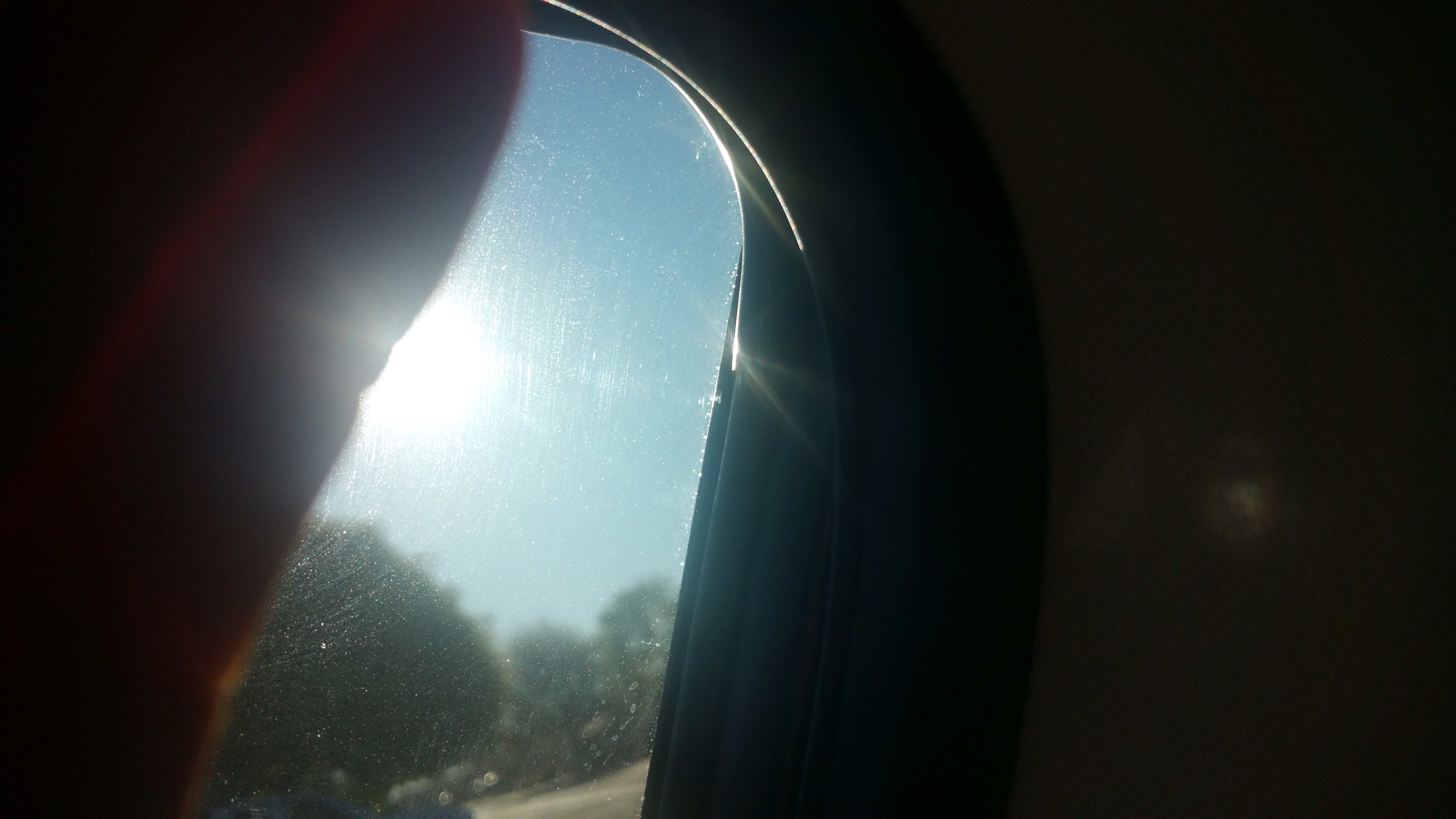

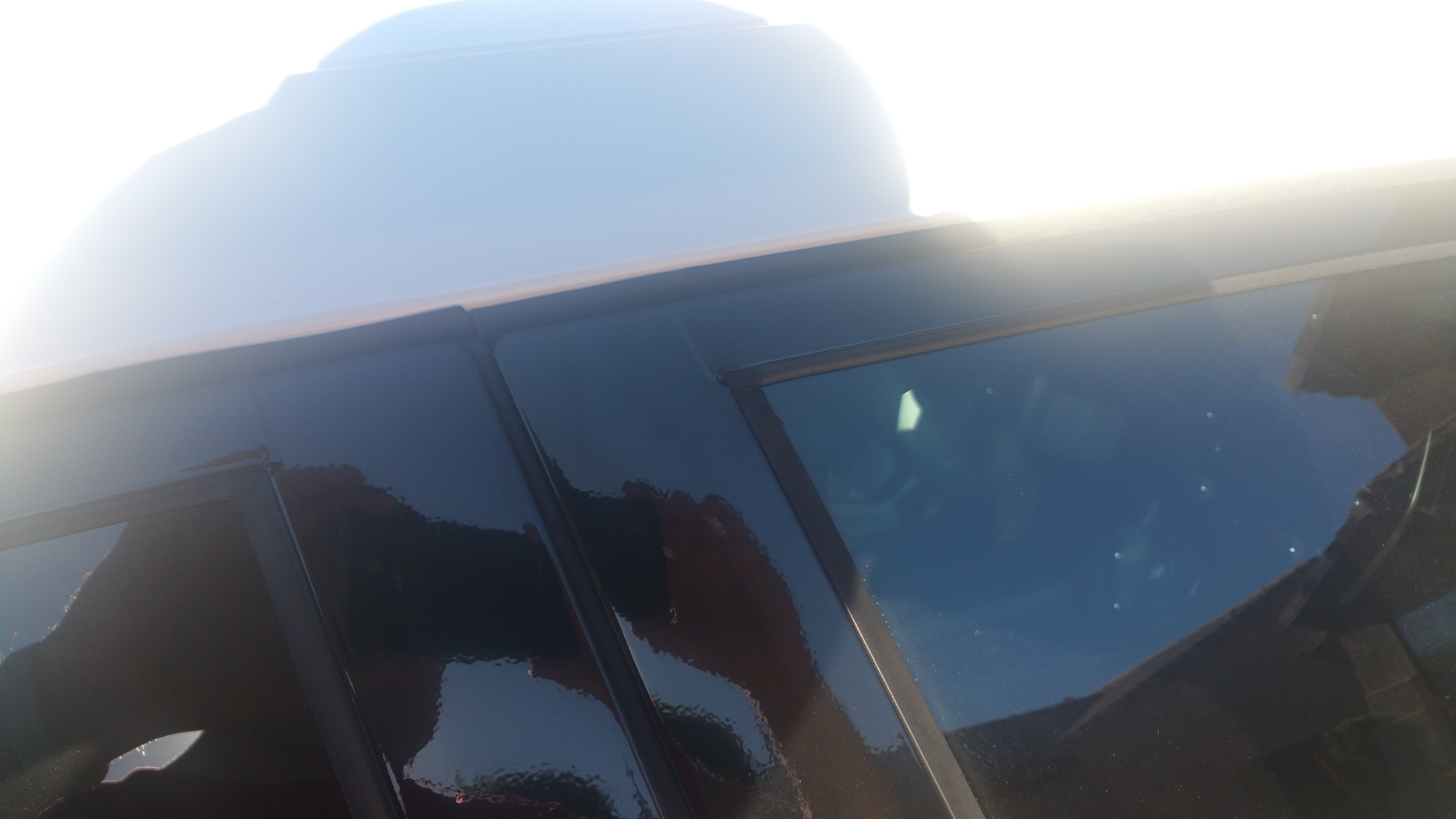

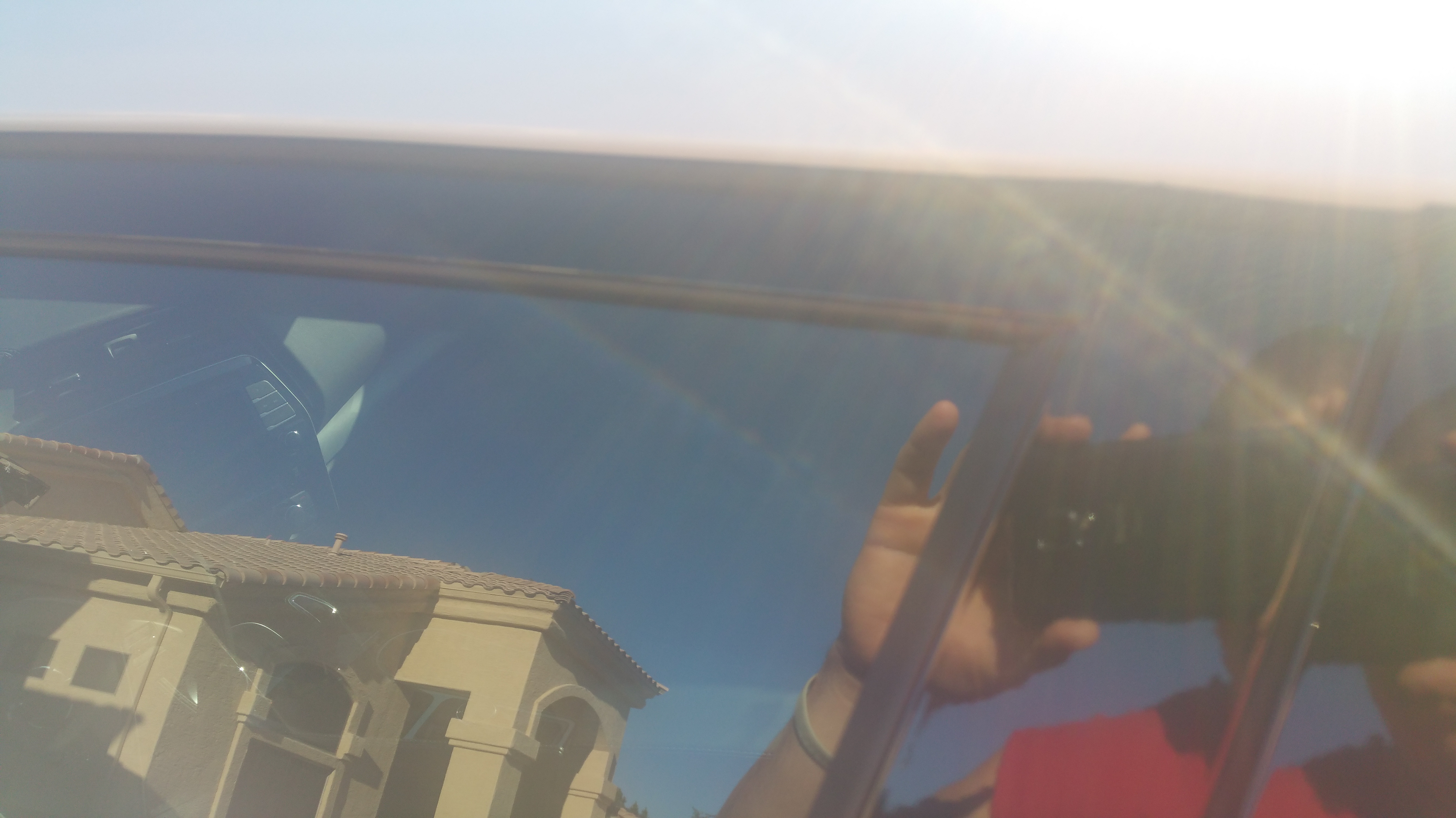

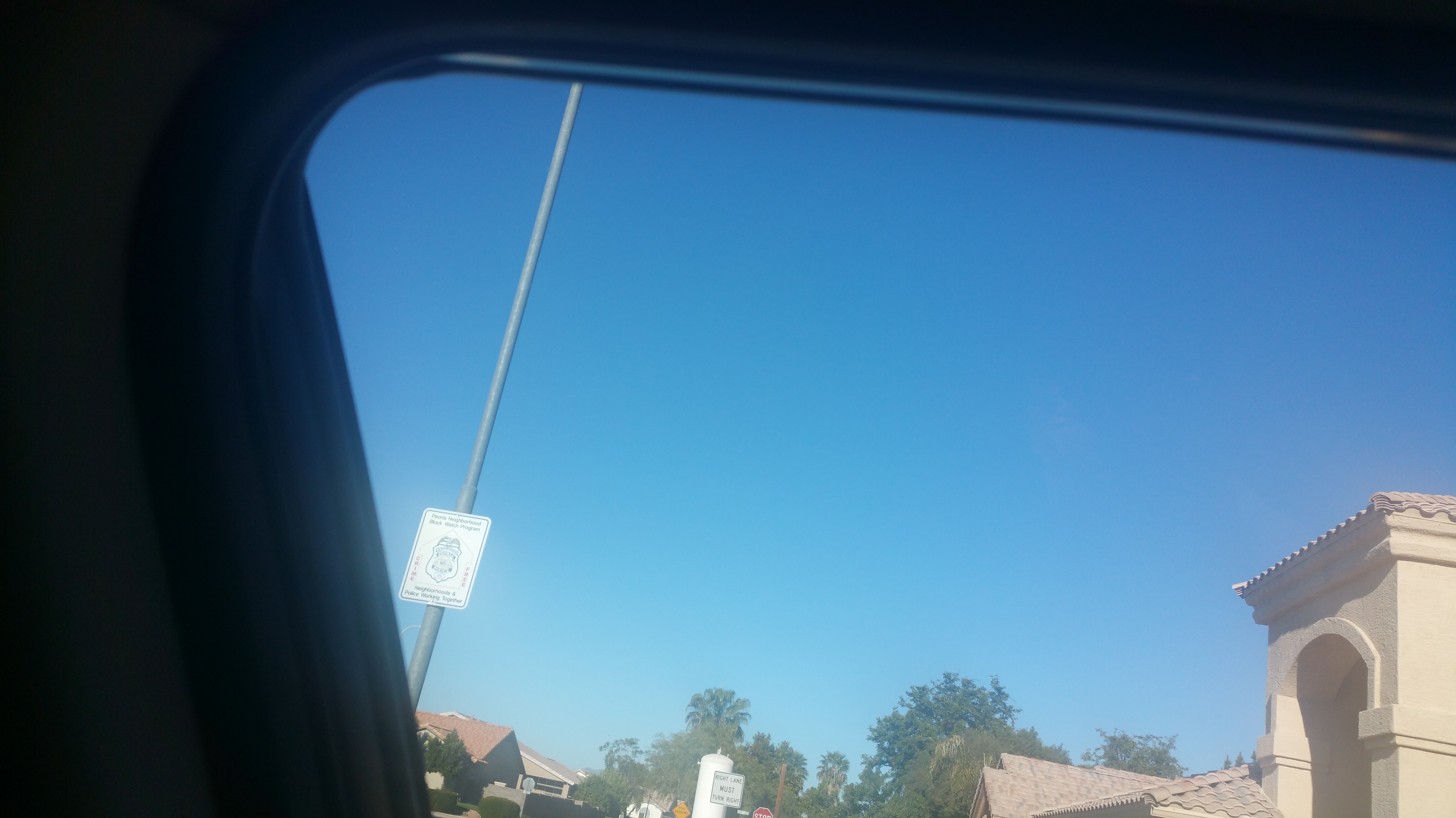

Well ladies and gentlemen for what I put off for a while I have finally accepted and come to terms with. My car isn't perfect. So as most of us do we drive with the music on and rarely with it silent. Well I finally did that a couple times on the freeway. And I notice that air whistle sound really pick up inside between 60-80 mph. At slower speeds you can't hear it. And from my vantage point it's all coming from either the front or rear passenger side or both. So I had my dad drive and I sit on th passenger side and sure enough it's pretty noticeable. The hard part is where is it coming from exactly. So I took a couple pictures of what I think may cause it. I took two of the inside and outside of the car. And the same for the passenger side. And from what I can tell on the passenger side the lining of part of the rubber bulges out and doesn't seem flat like on the driver side. Also on the outside of the passenger door if you look close that corner doesn't seem to sit flush either. So I made an appointment for Tuesday to drive with a master tech. Anyone else having this issue or maybe ha not tried it yet?

I would check all the black trim panels around the windows. Those are all heat wrapped vinyl and sometimes the vinyl peels up at the upper corners. That could cause a noise between the trim and door gaskets. Good luck

UPDATE: So I went to the dealership yesterday and took a test drive with a Master Tech and head foreman of the whole service department. I drove first then he did so we could have two perspectives. He told me I can make a couple adjustments, but these cars are designed pretty quiet and of course really aerodynamic. So anything above 80 all bets are off. I have test driven a couple Maximas previously before buying my car, but when you drive them with a Salesman there is usually constant talking and or music playing so you hardly get to test out the dead air of the highway. Long story short he adjusted what he could and it does seem to help. But I think my ears just aren't used to what a Maxima sounds like vs what I had before an Altima.

My first guess would be that somewhere one of the doors has insulation that is not in full contact with the door opening when the door is closed, leaving a crack where the sound of outside air gets in. If the sound is worse on one side, the problem is probably on one of the two doors on that side.
I created a similar problem when I put rain guards at the top of all four side windows on my 2009 7th gen, and it took me weeks of trying different shape deflection molding on the side of the car near the base of the windshield before I found a shape that nullified the whoosh caused by the rain guards.
Finding an air leak around a door can be difficult. Maybe having someone else drive while you take turns in each seat with all air circulation (AC, heater, etc) off and try holding a single sheet of something very thin (toilet tissue?) right at every spot along the inside edges of every door, and it you see the tissue move at all, there is probably a tad of air getting in at that spot.
