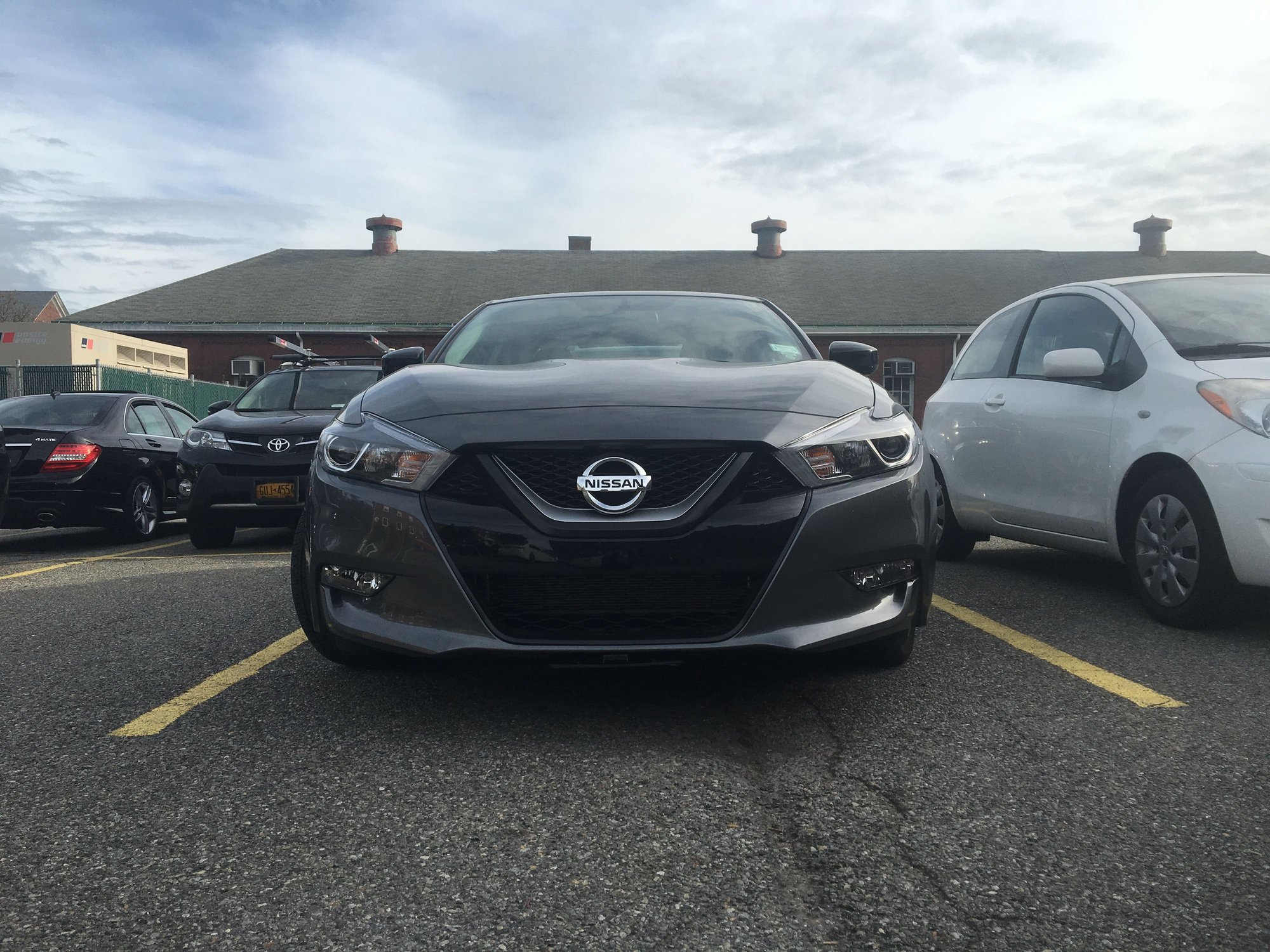

Can anyone give me a guide on how to/what to use on painting the front grill of the Maxima to gloss black? (Vmotion and nissan symbol) I do NOT want to plastidip it. I've seen user CNTRT paint his but he isn't replying to my pm. Using his car as an example. Would I need to scuff the vmotion and nissan symbol before primer/paint? And how long will this last because I dont want the paint chipping/peeling in just a couple weeks/months

Sorry, I didn't see your PM... I used Plastidip, and glossifier. I've driven through a few snow storms with salt and debris hitting the front of my car and it still looks great. I also plasitidipped my old Rogues grille and had it like that for a couple of years and it still looked great... Plastidip holds up extremely well when applied correctly. Doesn't chip or peel...Now no offense, but considering that you're asking if you should scuff the surface before priming, that tells me that you're not experienced with painting, and you should not use real paint for this job if you're doing it yourself. It will not look good and it will not hold up well or be durable.To answer the question though... yes, you need to scuff/sand the surface before priming.

No offense taken! Yeah I have zero experience with painting it and have only read some things. I thought yours was painted because of the gloss look it had. I was trying to avoid plastidip because of the dull look it has, but yours looks very nice with the glossifier. Might just take mine in to get professionally painted, but was just trying to see if I could save some money doing it myself don't want that 'orange peel' look if I painted it myself. Do you have more pictures of it in better light? Does the plastidip + glossifier match the gloss black of the front grill?

With the glossifier it doesn't match 100%, but it's pretty close in most conditions. It's more satin black than straight up gloss, but it complements the OEM grille pretty well. Definitely good enough for me, and I'm VERY particular. I'm driving right now but I'll post up a bunch of pics in a couple of hours

And 2 pics of my previous car... 2015 Nissan Rogue... Blacked out the grille, emblem, and chrome strip on the lower front bumper with Plastidip and glossifier. I've been using plastidip for years... I even did my entire 1992 Jeep Wrangler with it (anthracite grey not black)... It looks great when done correctly. A lot of people just don't know how to use the product for the best results.

Nice! It's a good look man.. you did a good job. Could hardly tell the difference, it's a really close match. Will probably do mine once the weather warms up.. hopefully this weekend and I'll post pics. Any tips you could give me? Never plastidipped before but I know to do layers.. want it coming out as smooth as possible. (dont want orange peel look)
