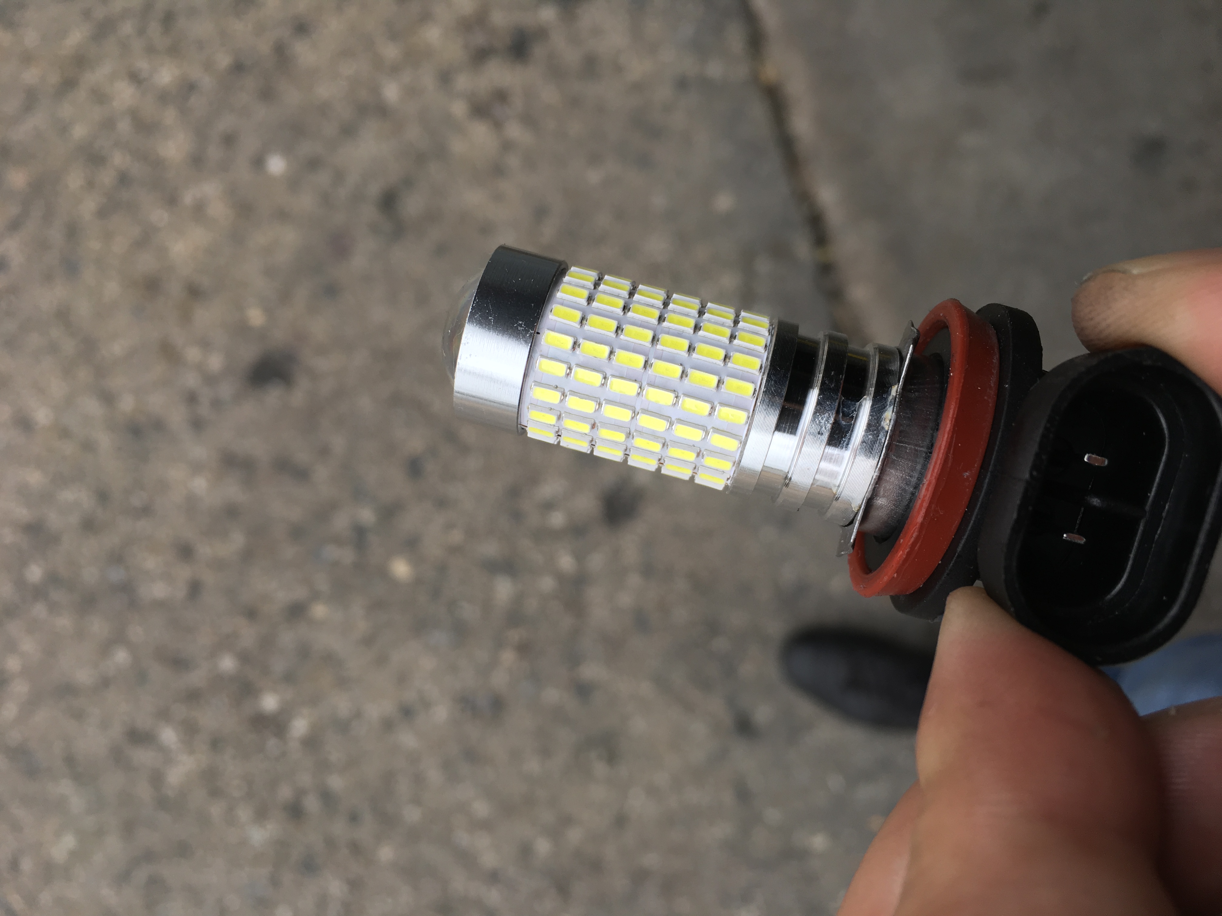

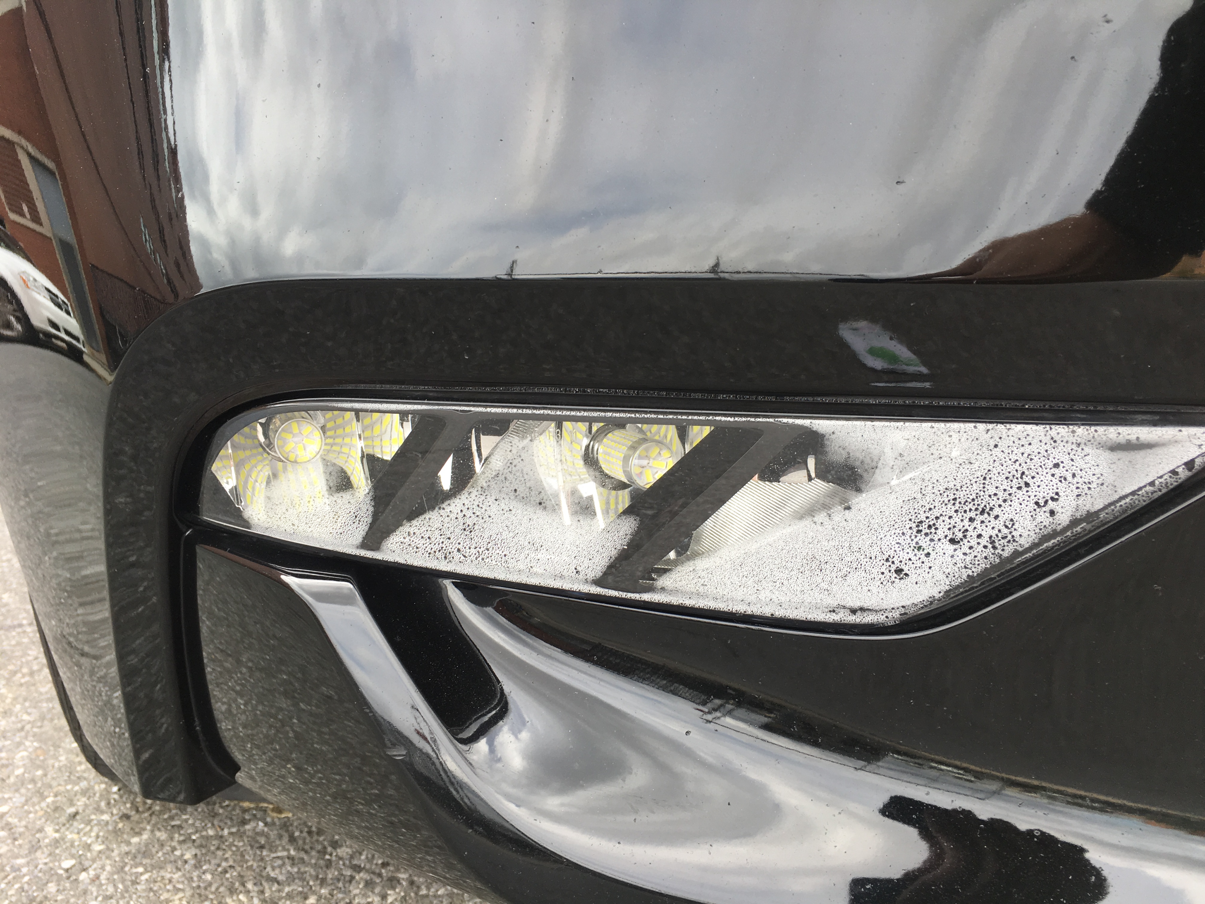

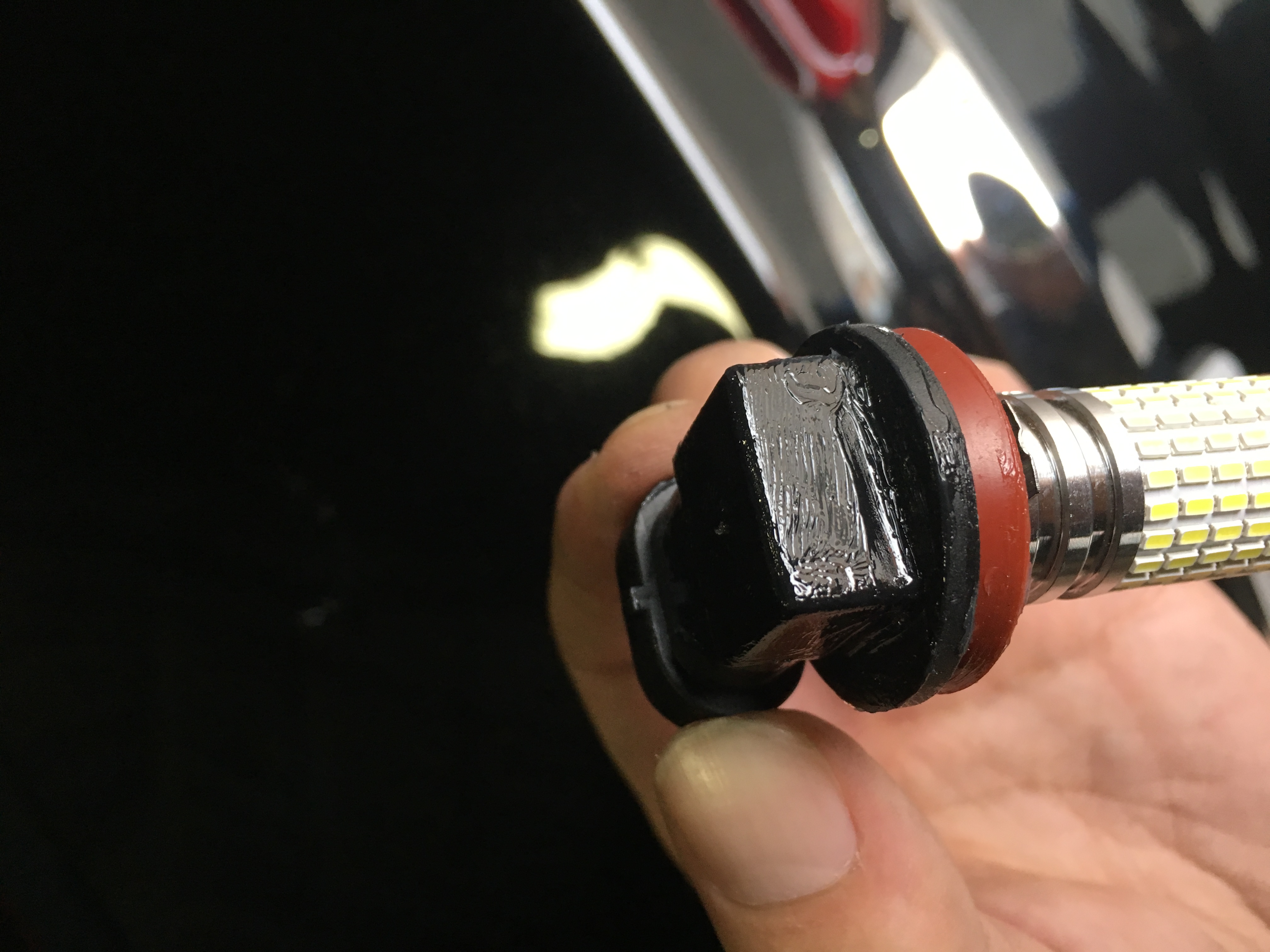

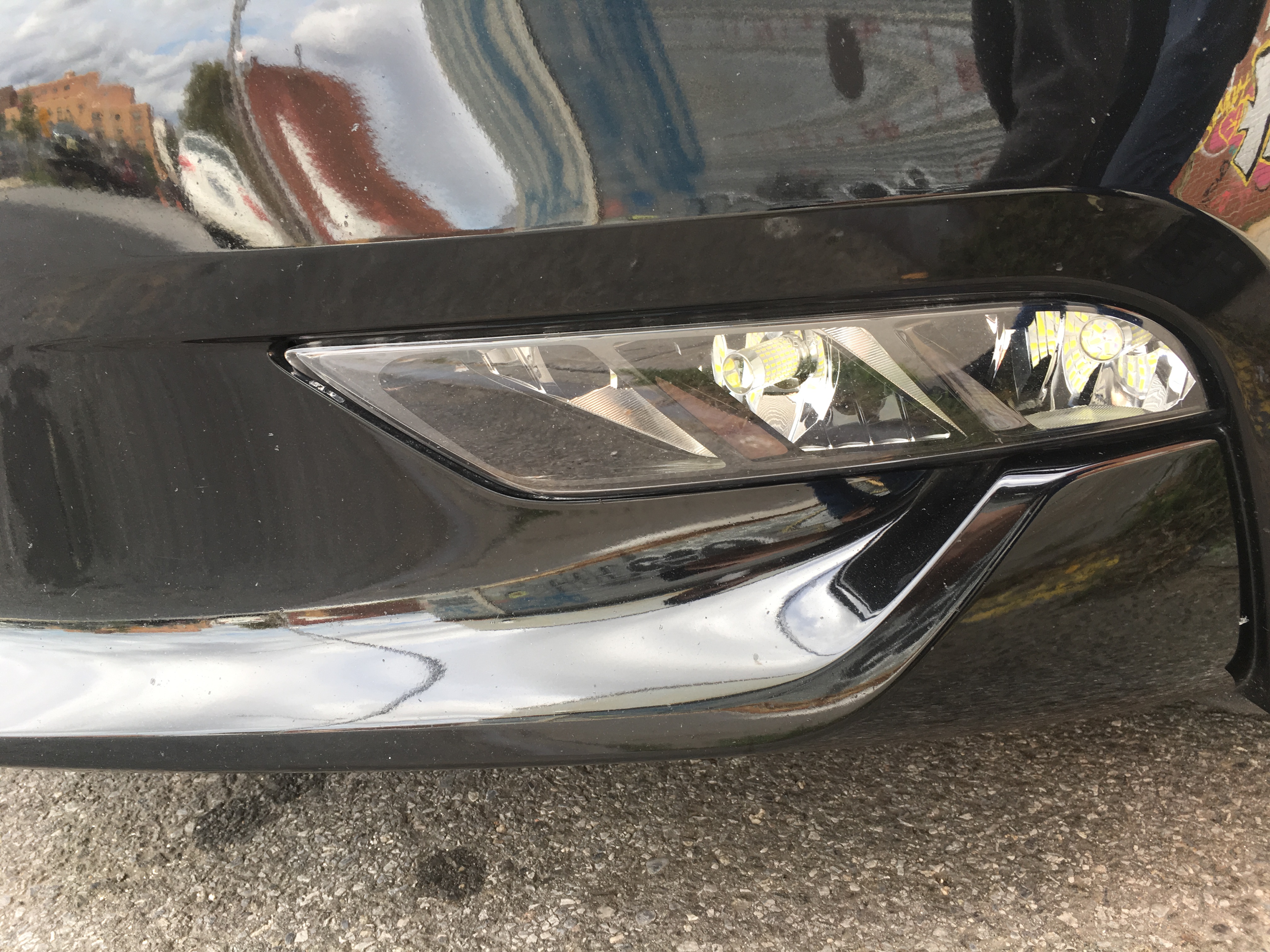

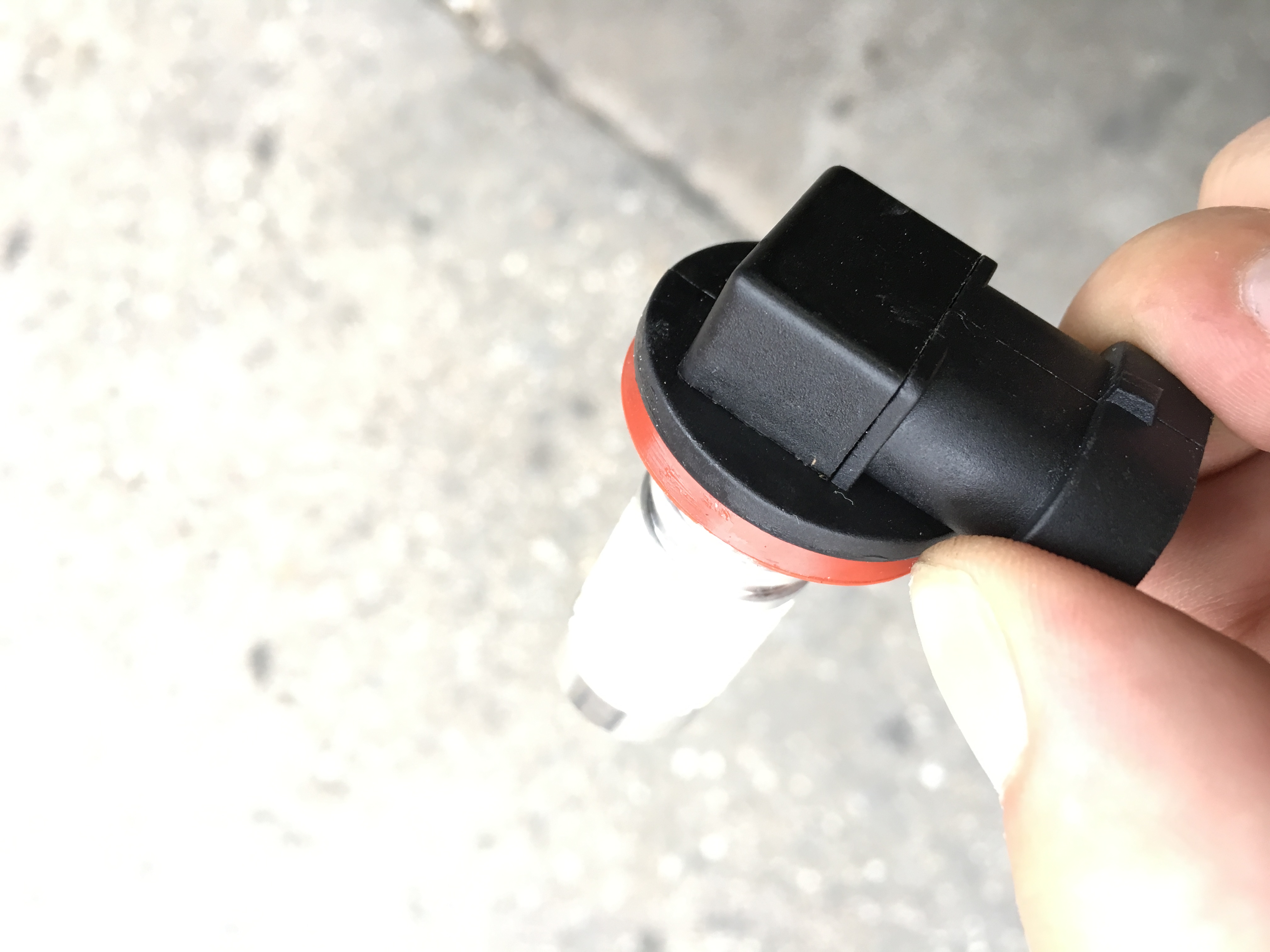

Hey, been messing with this issue the whole weekend. The guy in the other thread said that he drilled some tiny wholes in the housing and he had no problem ever since. Some people claim that fog lights has to have air ventilation in the housing.
Left one had a bit of condensation in the morning now it’s clear. The right one thought still have it. I applied a good amount of silicone because I have spotted very poorly designed flow in JDM products. I believe that the housing is made up with multiple plastic pieces. See attached photo. I think moisture gets inside the fog light housing through led bulb not around it. ( see 3rd pictures for water marks going out of the bulb)
