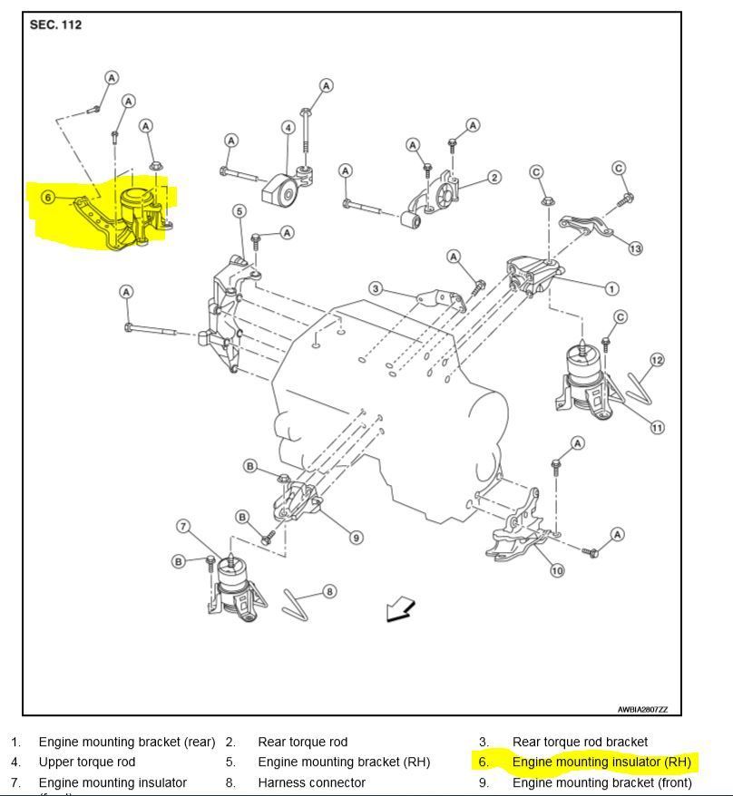

If all of the aforementioned you checked and had no success check the Motor Mount/s, Maxima's since the 5th gen are notorious for a clunking noise over bumps especially the front passenger side when the Motor Mounts start to go bad.

Well the interior parts of motor mounts start to deteriorate/crack with age and sometimes they just go bad on new cars had it happen with 3k miles on one car, and it is not impossible to happen on a car produced 4 to 6 years ago!

Thanks for all the ideas...I do have 85k on the vehicle. I checked the service manual for mounts, looks like there are 4 (left, right, front, rear) getting to some of them is quite the procedure. Note that this clunk only seems to happen when road bumps hit the front passenger wheel.
No prob, yes that's when it happens mainly over bumps and that is about the mileage that they start going in many cases if they survive a normal life. The one on the passenger side which is considered the front on the Max since it is transverse is the one that goes bad usually first and causes a clunk. Yes you are correct some are harder to get to to check mainly the one on the drivers side which is considered the rear one which u have to take a lot apart to see and check and the one closest to the firewall.

Passenger mount is easy to view from the top, just remove whatever plastic BS you need to see it. Beyond your ruling out the suspension, and negative on the mounts, I'm stumped.

So you are saying to check this one? I do not see a guide for that one in the factory service manual, only the front and rear which appear to be actual front and rear.
Check the one that is on the passenger side once you open the hood, it is just to the left of the drive belts.

OP, also check part #4, it's even easier to see.

Part 4 - I could move it slightly laterally, seemed to move well. I got a pry bar to very slightly move up and down, the rubber all looks in tact and I did not hear anything.
I see part 6 but have no idea how to test that one. I cannot get a pry bar in there to move anything, any tips?
I also pulled up and pushed down HARD on the passenger front fender area to really work the strut, again, I did not hear anything.
Man, this noise 1is driving me crazy though!

Although not out of the realm of possibility, I just really don't think it's the mount. Another check you could do that, if passed, would rule out the mount for me, is to watch the #6 mount while having someone start the car, rev it a few times, and see if you see anything funky. I doubt you will, and that would be good enough for me. I still think it's a rod-end/ball joint of some sort (tie rod end, lower control arm, etc.) suspension/chassis related. Without being in front of it, or knowing more about the 90k mi history of the car, I just don't know.
