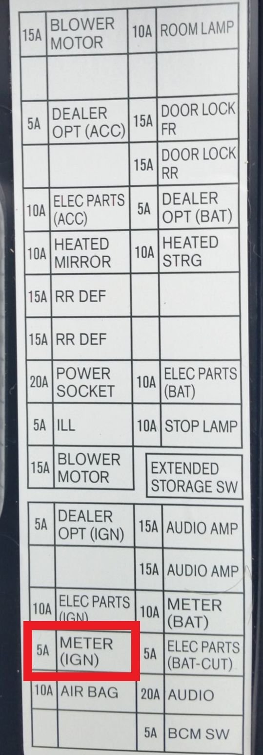

I was working on a 2016 today and it did the same thing while I was trying to figure out some other wires up front... with the outside temp sensor disconnected the cluster showed -22 but when it showed no numbers and the climate controls weren't working I knew I had another issue. turns out the 5 amp meter (ign) fuse blew when I was testing the horns...the car was in a minor frontal collision and came out of the body shop with more problems than it went in with...
