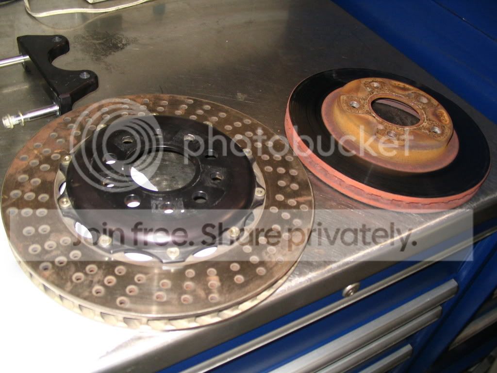

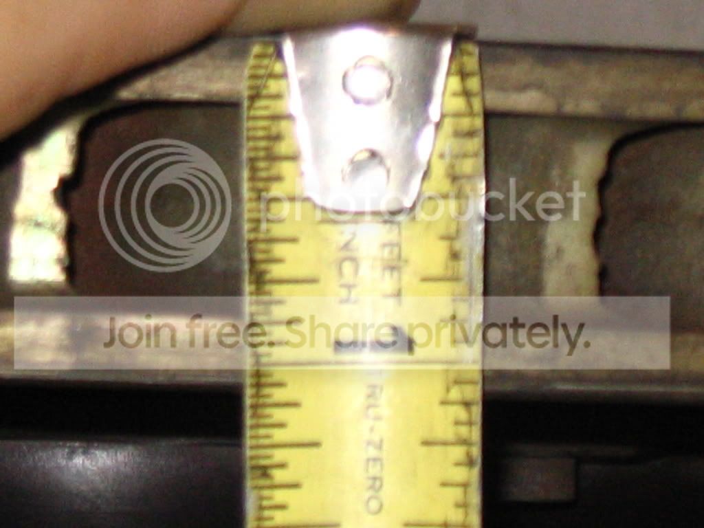

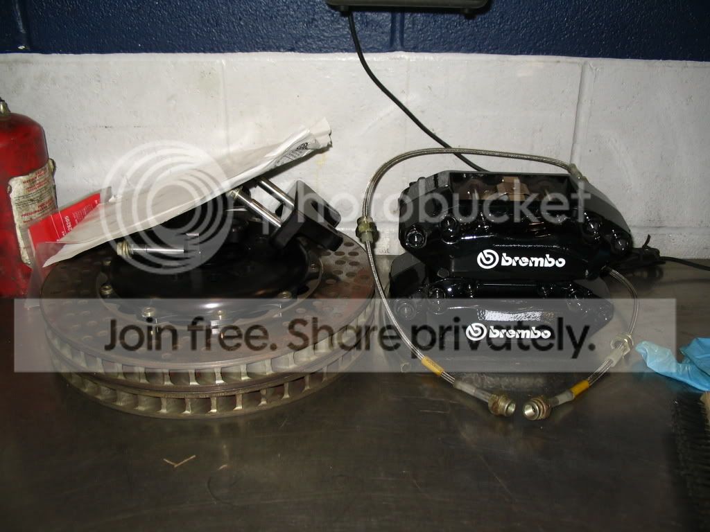

Ok well I just got my Brembos and I got wood. Bishes are huge, yet so friggn light its not even funny.
According to my digital scale used for shipping, each rotor is 12.65lbs
Here are the pics showing you the size...
12 7/8" diameter and 1 1/8" thick.

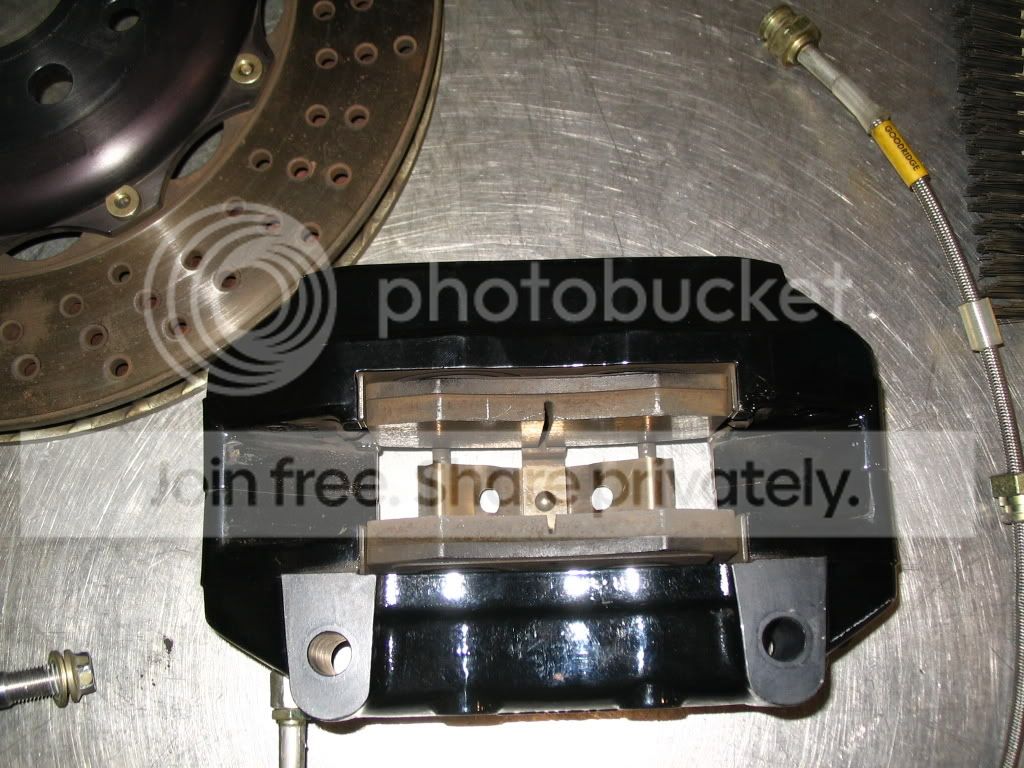

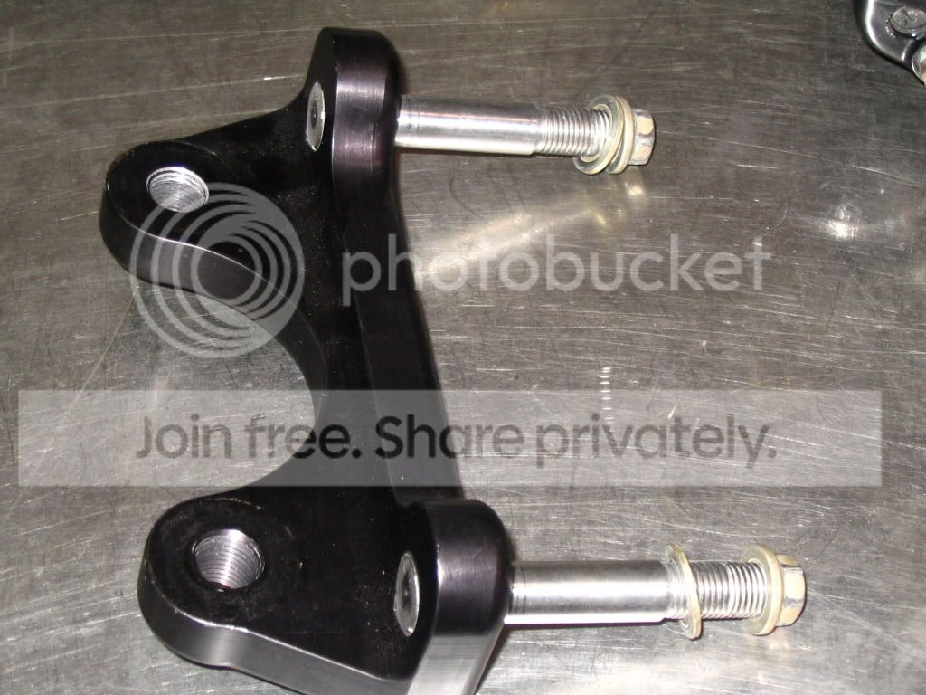

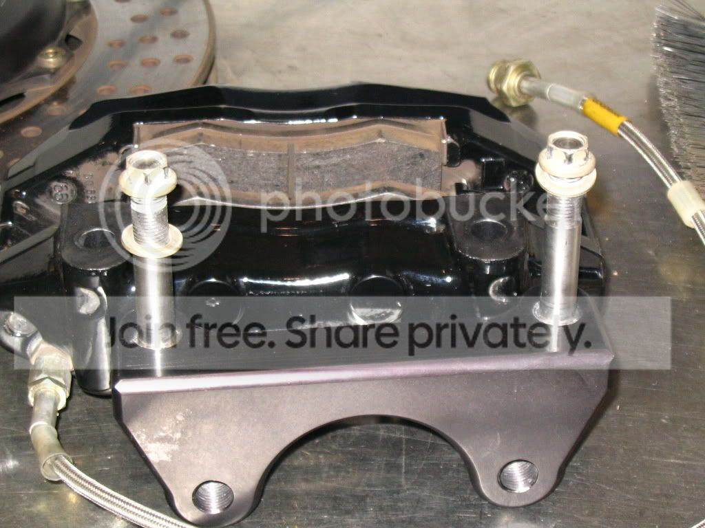

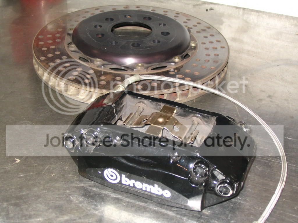

Shots of the caliper mounting brackets and calipers themselfs.
Brackets are made out of aluminum with studs holding the brackets to the calipers.
Each LOADED caliper with pads is 6.25lbs and the caliper bracket is 1.25lbs.
SS lines are made by Goodridge.
Plenty of brake pad life left, the kit hasn't seen day light in about 2 years. I'm going to mount it after work (at work now) and see how it fits behind my wheels.
Excuse my missing bumper cover, its off getting repainted

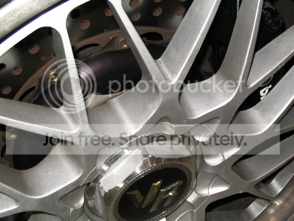

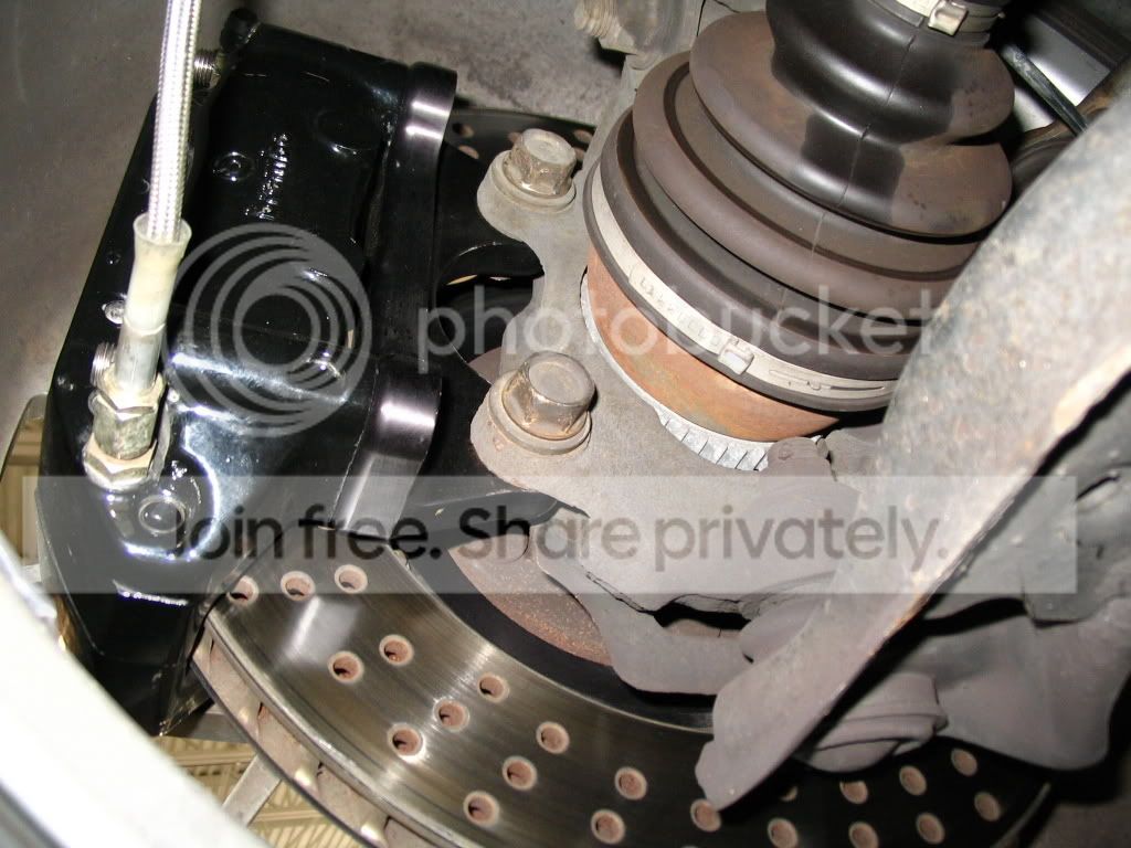

Few pics of them installed on my car... just finished the job.

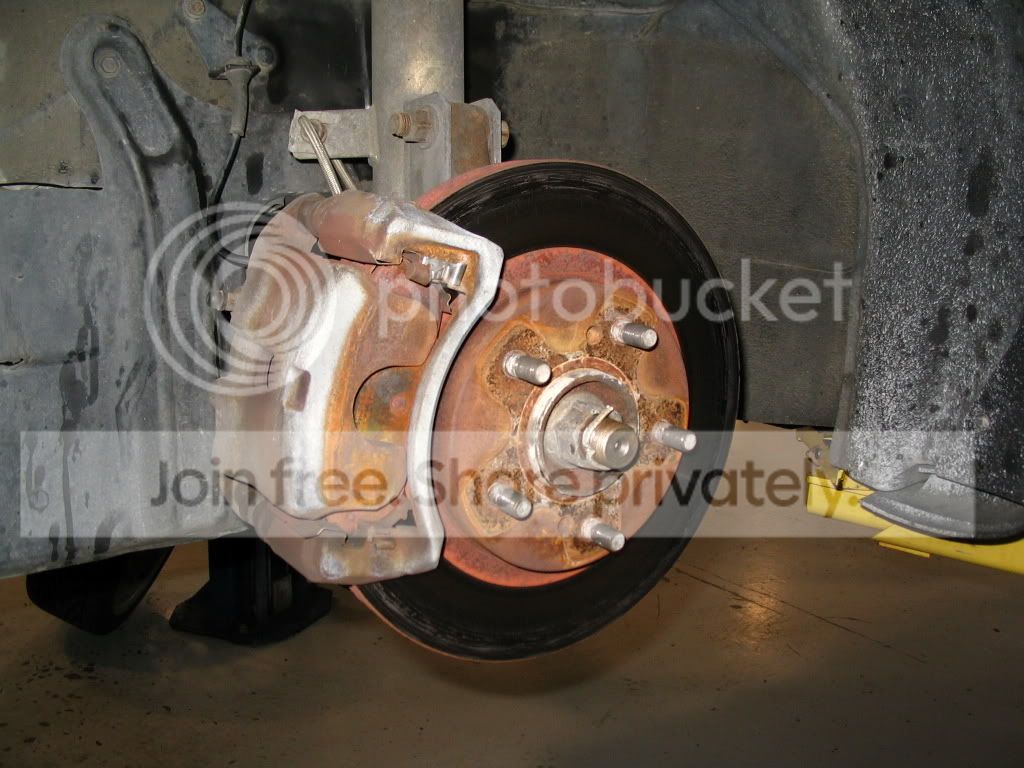

And now onto stockers...

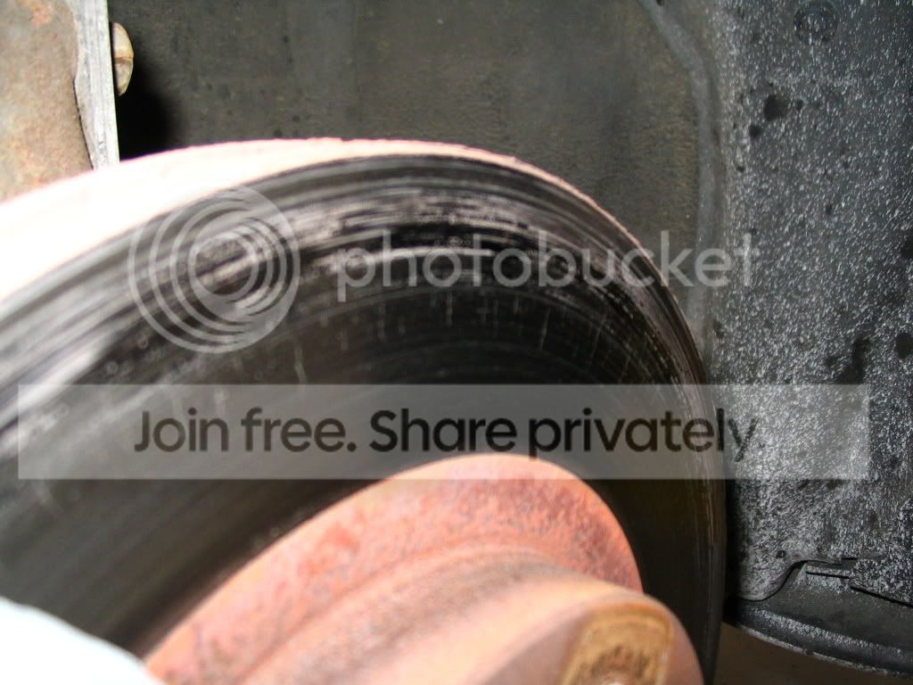

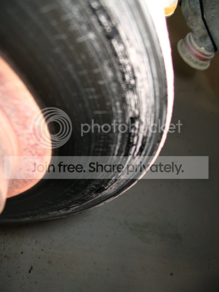

Stock rotors with Hawk HPS, they are about 12 months old, use on the track few weeks ago. There are stress cracks everywhere on the rotors and the brakes make all kinds of funny noises while driving.
Brembos are awesome, the pedal is so still compared to OEM... and they bite from high speed like no ones business. I didn't drive more than few miles with them because I have no front bumper on the car.
Its getting a make over just for Maxus, plus the 177K mile paint on the front bumper was showing its age big time.

Originally Posted by irish44j
Mike, interested in the offset of the rotors....how do they compare to stock?
Also wonder about the possibility of using those calipers with matt's 2-pc 6th gen rotors....pretty close in size, wonder if offset is the same. I've been getting annoyed with the z32 calipers and all the flex they have...
You know what, I didn't compare them much to the stockers as THT was in there telling me to hurry up and put a Quaife in his Maxima....
I will have to measure the rotors out for you.....
THT has the same identical wheels as mine, I can measure his stock rotors vs my Brembos and give you an idea on the rotor offset.
I do have the stock rotors laying on my tool box at work, I will do some measuring out on them too.
I can tell you the calipers are solid as a rock, the pedal feels direct and very firm compared to my OEM calipers. They grab like its no one elses business.
I need to score a set of STi calipers and see if they will bolt up. I know for a fact that the 04+ TL Brembo calipers WILL bolt up to our knuckles as the bracket spacing is identical. They just bolt right up to the knuckle vs my kit which has the brackets with 2 studs.
I'm going to give these a good review in about 2 weeks, I plan on hitting the track with the car then.

So far the Brembos are quiet, and bite hard with excellent pedal feel. I will have to give em some miles over MAXUS weekend.
You can't even see them on my car due to my wheels.
