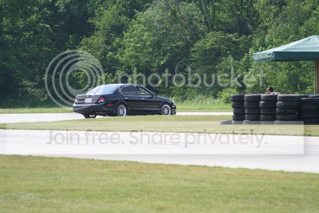

I will tell you that- Ksports and D2s are junk. I have riden on those "coilovers" and they ride like ****. They are do not have enough rebound capability.
I am currently getting some custom balljoint and tie rod relocation adapters for my car.
The pic in my sig line is old, my car isn't slammed to the ground. I do scrape on small inclined with my SFCs but I can't complain about any bump steer or anything.
Corner weight and aligned, car is a blast to drive. I've never driven a Ksport or D2 car that rides and handles better.
This is a 50MPH turn.... show me body roll.

^^^^ Need a better turning picture cause that doesn't show a thing.

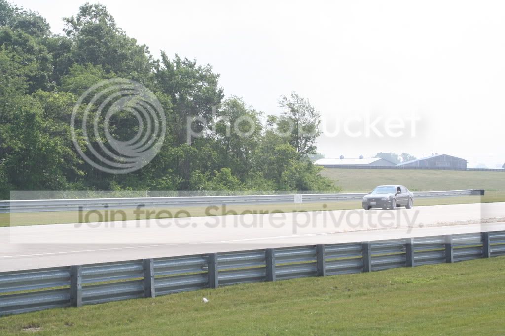

Thats as good as it gets.... and i don't feel like putting a video up online. Pic was taken from faaaaaaaaar away from that corner. Basically up to 110 down the straight down to 80 through the 1st corner and then drop down to 2nd and power out of corner around 50-60MPH shifting as soon as I was out.
I don't mess around with suspension work.
Pic of the suspension "unloaded" booking it down the straight at about 105-110MPH.
