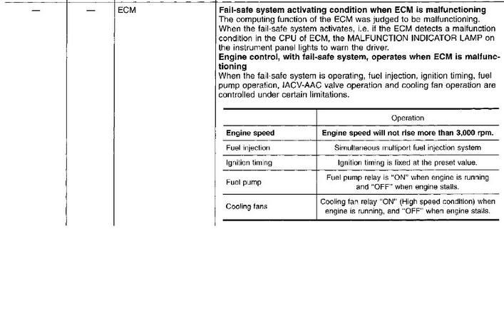

That would be ECM-failsafe mode.
- revs limited to 3K.
- fans on all the time
- DTC codes not accessible
In a nutshell, your ecu is toast.

Old Jun 27, 2006 | 07:04 AM
eng92's Avatar
Joined: Oct 2002
Posts: 1,199
From: Ontario, Canada

From the error desciption given in the FSM, it appears that the cpu chip may be the source of your problems. It may be a socketed chip that you could replace from a donor ecu, IDK.
Possibly JWT would give you a deal to transfer your existing daughterboard into another ecu.
