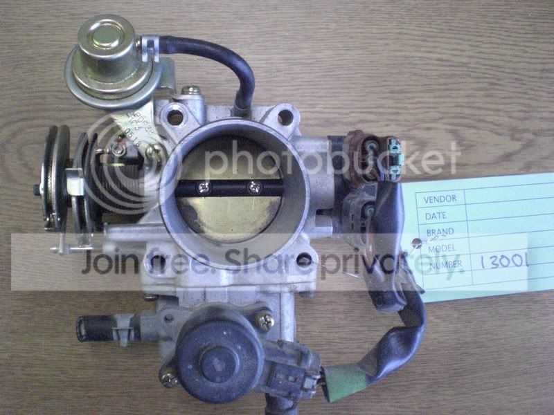

Oh, btw:
Notice the canister and hose on the throttlebody just to the right of the throttle cables? That's what I'm talking about.
Oddly enough, there's no hole on this throttlebody where the hose would hook up to, no hole for the support bracket of it near the throttlebody's opening (both these holes simply don't exist...there's a "spot" for them, but no hole; the hole looks like it was simply never drilled from the factory). Also, the 4 holes on top of the throttlebody for the canister to bolt to aren't thread, either So even if I were to put a canister on, I don't think I could get it to work.

Only the '00-'01's had that style, the 4th gen's fast idle cam was built into the tb using coolant pasages, I was going to attempt to attach the 5th gen style onto a drive-by-wire 3.5 tb, but gave up, it would be near impossible, on that throttle body it would be much easier though.......... But yes, you can use a 4th or 5th gen tps on that tb.
So the throttle stop canister was indeed for cold-start idle purposes? Why doesn't mine have one, then? It doesn't even have the spots/holes for it, let alone just missing the canister and hose.

Actually on the 00/01 tb's that had it it would 'tap the gas' for you every time you started the car, hot or cold, as soon as the engine starts the vacuum signal pulls in on it and it is no loger touching the throttle. The throttle pictured is a pathfinder, as far as I know the canister only came on 00/01 tb's
Actually it's an 00/01 throttlebody pictured. That's Irish44j's car and he does not have a Pathfinder throttlebody. I'm like 99% sure mine isn't a Pathy throttlebody, too
Now when you say "tap the gas", do you mean it would simply push on it for a second and then let go, or what? And during cranking/startup or after that?

Sorry I was a bit confused and didn't really look at the pics that well.
When vacuum is not applied to the canister (engine off or wot, but wot wouldn't matter anyways) the plunger pushes out on the litle gold part pictured with the hole in it causing the tb to be opened just a little more, a second after the car starts vacuum reaches the canister and retracts the plunger and the tb closes.

here's a better pic..

[img]https://i30.photobucket.com/albums/c328/hukaiwen/13001-01InfinityI30VQ30ThrottleBody.jpg[img]
Good for future reference to anyone who finds this thread later.

it's probably rubbing or the angle the cable comes in is weird. just use the 5g cable bracket.
I don't think it's rubbing. I also have it coming in at a straight angle, I made sure of that. I think (like I said in an earlier post) that it may be because I have the cable so tightly bound together. It comes out of the firewall, pretty much makes a 90 degree turn towards the passenger's side, then does an almost 180 into my bracket, then another maybe 45 to the throttlebody. It's not rubbing on anything, I know that.
I'll be getting a bracket eventually. Dave B has had it on order for me, but it's been on backorder for about a month now with no ship date in sight. I also have a WTB thread in the 5th gen forums but no one has shown up.
Old May 11, 2007 | 04:41 AM
Tatanko's Avatar
Bacon Lover
Posts: 7,662
From: State College, PA
Originally Posted by krismax
i took the hose off and then used the set screw behind it to set my idle to any rpm i desire its that easy
I would, but I don't have any of that
