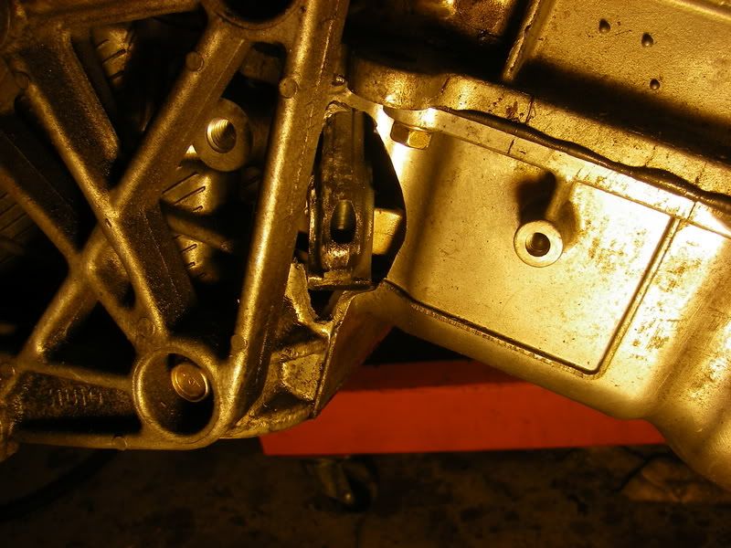

Okay just pull the motor out. It looks like a rod bolt on cylinder 2 came undone. When I took a look this morning, I could see the bottom part of the rod is just poking out the upper oil pan. Its intacted but no rod bolt present. I pull the lower oil pan and there are metal fragments that looks like bottom of the piston. I called my friend who did the install on the short block and I'm taking it there to tear it down completely. I will update more later and I have pics too.
Old Jul 19, 2007 | 04:38 PM
  #110
jcy98maxse's Avatar
Turbo is too much fun!
Joined: Apr 2002
Posts: 2,515
Sorry for the crapo quality, damn camera phone... but as you may able to tell, the bottom (top section) basically skipped out of the crank, over the main bearing beam and punched a hole into the upper oil pan. The rod seems to be in one piece as far as i can tell but won't know for sure until I pull the oil pan. The rod bolt thread is still good, the mating surface b/w the top and bottom is still smooth so this leads me to believe the bolt backed out and cause this...

So the bearing cap is still there, being held on by the other rod bolt?
Old Jul 19, 2007 | 05:04 PM
  #112
jcy98maxse's Avatar
Joined: Apr 2002
Posts: 2,515
I don't know, I haven't tear the upper oil pan off yet since I'm moving the motor to my friend's shop, I don't want to tear it out completely before I get it there so theres no room for him to talk if it turns out to his fault. I'm presume its still in there since the hole isn't really big enough for much debris to come thru and its not in the lower. It'll be Monday when I take it down there.

Posts: 2,515
better pictures:
