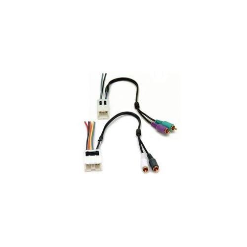

does the metra harness use 1 pair of rca's or 2? i was under the impression that it needed 2 but the picture looks like it would just take 1. can anyone clarify this? thanks!

70-7551 takes two pairs of RCA's...front and rear

idiot proof harness i guess. how much would one of these harness run on average so i can know if its a rip off price or not.
http://ec1.images-amazon.com/images/...V36804953_.jpg
from that picture i probaly have to match output wires as well then... I have no problem doing that just wanted to know how much is involved.

You're not matching output wires, you need to color match the power wires.

that picture shows 7 wires total. given that fact i need + / - and 4 speaker wires that totals 6... is the 7th wire an extra ground? also there are 2 grey and 2 black. i'm assuming 2 blacks /grounds red/power yellow,orange/front grey's/rear.
is that picture of what i'm getting exactly? reason why i'm asking is because i dont want to run into any issues.

+12, ground, accessory, power antenna, etc.
Take a picture of the harness you receive if you're really having an issue. I have no idea why there's a gray wire hanging in that picture.
