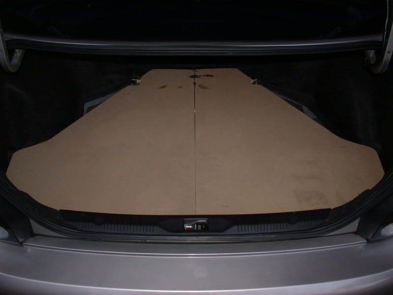

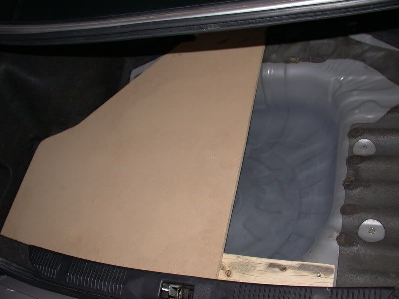

Maybe this will help:
Take out the stock carpet, trace it onto 5/8 MDF, Cut MDF in half (allowing you to get it IN your trunk). The wings will have support toward the front of the car, and on the sides next to the tail lights, but no support in the direct middle rear. Cut a 2x4 to match the length, and cut it in half or trim it for a better fit, screw the 2x4 down, screw the wings to it. Also, toward the front of the car are 2 bolts that stick up, you may need to cut notches for the boards to lay flat.

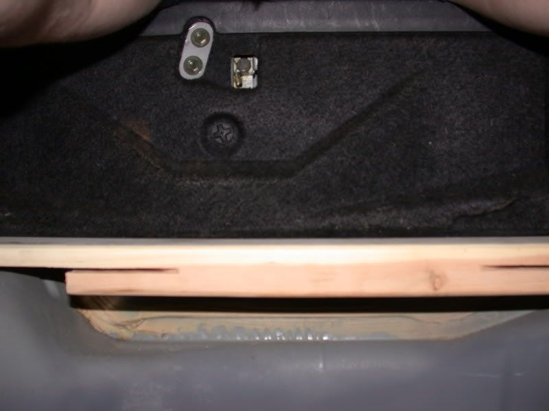

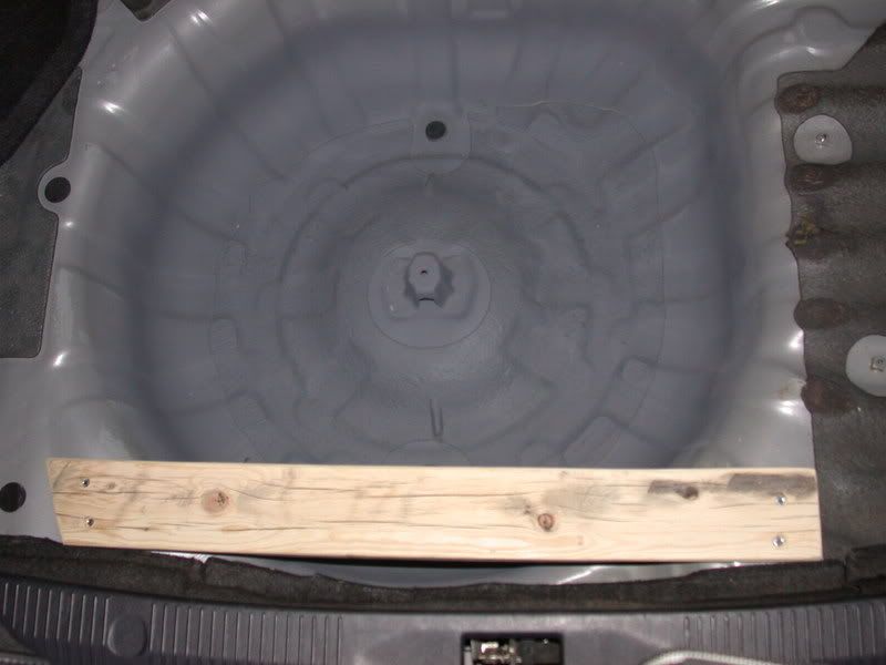

http://www.cardomain.com/ride/185151/3
check this floor out about half way down the page...i didnt know if he was on the org...

You screwed into the trunk?
Guess since you live in AZ, you don't really have to worry about rust issues too much.
Old Mar 17, 2008 | 08:15 PM
SuBXeRo's Avatar
Joined: Dec 2003
Posts: 548
From: NJ and AZ
wow thats actually a good idea lol, if he used stainless steal screws it shouldnt be a problem. I would just seal up around the holes with silicone just to make sure. That idea is good if u dont plan on having any bowing in the middle, even mdf will bow at that size over that much me thinks
Old Mar 17, 2008 | 09:39 PM
daesonn's Avatar
Joined: Jan 2008
Posts: 79
From: phoenix, AZ
Notice the gray primer in the spare tire well? Thats actually a rust repair I had to do myself. When I bought the car a few months ago I didn't check the spare tire well until a week or two after, and it was filled with water and rust...turns out the right rear tail light was leaking, not properly sealed when it was repaired from a rear end collision.
