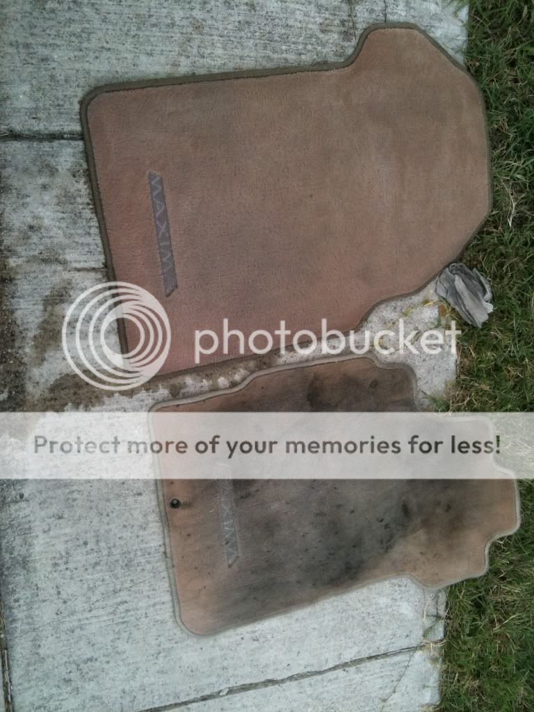

GRIOT's GARAGES CARPET CLEANER. I have had tons of **** in my rugs. They are the original rugs that came with the car, 160k miles! nelledge showed me this stuff, reallly surprised me. best stuff for carpet cleaning. Not expensive either!
http://www.griotsgarage.com/product/...eAscend&page=4
Before and after, they were both equally dirty. oil, dirt, and food stains on these rugs! ugh.

damn dude, thats nasty!!! i would never let my carpets get that dirty.

DAMN that cleaner is awesome. and yes, I can't beleive you had such old dirty carpets LOL
