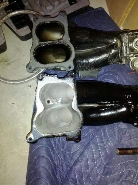

Attached Thumbnails 267.4hp/232ft lb  Auto 5.5 Gen-eelbow.jpg

So from the last run (262) you done the elbow port, 09 TB, and 3" testpipe? that was 267 now.

3.5 inch maf
09tb
elbow
3inch test pipe
mounts
yeah peak carried to 267 and change. but from 5500 its picked up nicely up to about 14hp in higher revs. lost some on lowend but it flattened out the tq curve some. My ssim is opened up really well, and the new changes may have called for too much flow. may have them make another for the other elbow and change that on the dyno to see the difference if the porting helps, but im actually happy with how it sits for now. My main look was to get more on top as playing with the vmanage will dial in low and midrange. still on the lookout for a resonably priced used unit.
The next "great big" thing will be the addition of a vmanage, a 75 shot, then retuning for olf and calling it a day. think ive peaked with this motor setup, take some time to enjoy it, and get the minor maintenance issues corrected that have been niggling at me.

The elbow, test pipe, throttle body, bigger maf. 3.5 interior diameter over 3
