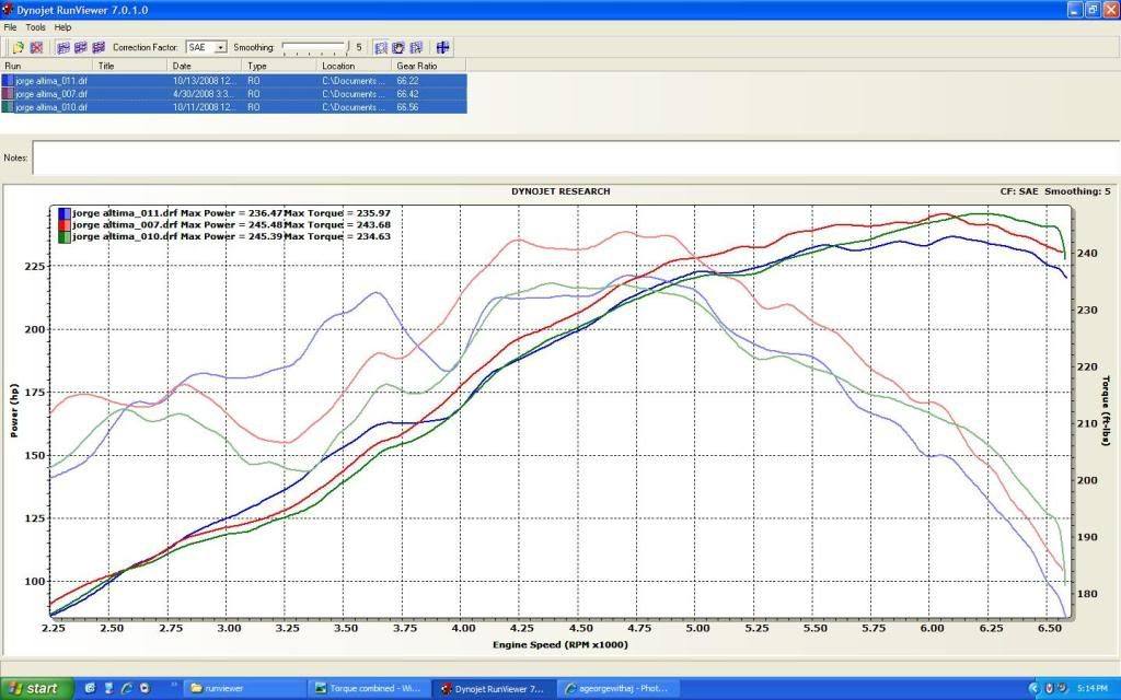

Check out these classic dynos from NissanClub:
Blue=stock
Red=VIAS delete, NWP BOP (What I currently run)
Green=SSIM
Looks like the SSIM is the worst combo below 6100, and by a good margin. I don't know about you, but I spend most of my driving below 6100 rpm, so the SSIM isn't even a consideration. I do miss the mid-range torque hit of the stock setup, but the gains above 3800 rpm appear to be enough to tip the scales in favor of VIAS delete and NWP BOP. Do you have dynos showing different results?
It sounds like I could get most of the benefits of the 09+ motor by just installing the heads and IM. Can someone explain why 02/03 Maximas hold their power all the way to redline, but mine falls on its face? Is it just to how Tilley set up the cams? Maybe I should go back and run stock VIAS with no NWP BOP to regain my low end, and then put on 09+ heads and JWT cams to get more on the top? 09+ motors still run VIAS, right?
EDIT- I should mention that the car needs to be able to pass emissions testing every year, so not having codes (EGR, etc...) is very important.

Originally Posted by 95naSTA
Or you could always do the SSIM to get your torque to hang out for longer.
This implies you have to choose between picking up midrange or getting your torque to hang out for longer. I'm well aware of SSIM midrange loses.
You quoted yourself there, I'm not sure what you're referring to. Can you clarify?

From: Philly
You put together a post about how the SSIM sucks for midrange. I never said it didn't and I alluded to the fact that you would have to choose between midrange or it's top end gain.
