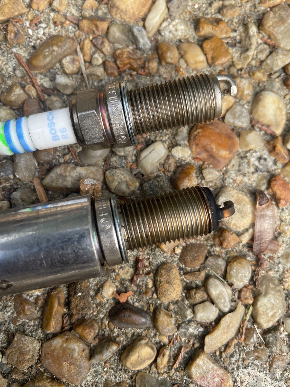

The plug from cylinder 2 is clean and other plugs look slightly worn. What isn’t cylinder 2 getting correctly
Old Nov 17, 2023 | 08:43 AM
Yeah, but you just recently changed the spark plug in cylinder 2. Were any miles put on the car since the replacement?

Also, here is a good chart for reading spark plugs.
https://ngksparkplugs.com/en/resources/read-spark-plug

Found the issue someone replaced the coil harness with an aftermarket one. I’m going to cut a factory one off and replace it. Also remove intake and replace injectors and plugs with OEM coils and ngk plugs. Owner had Bosch in there smdh
Old Nov 17, 2023 | 11:09 AM
Nice detective work.
I was gonna say, wha'ts with the Bosch plugs? NGK all the way.
