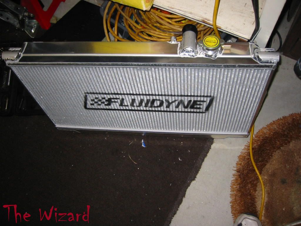

HKS 30-way adjustable coilovers
Fluidyne radiator

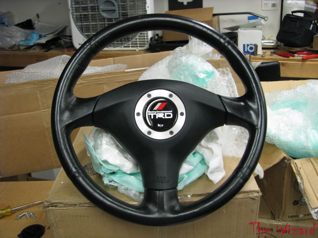

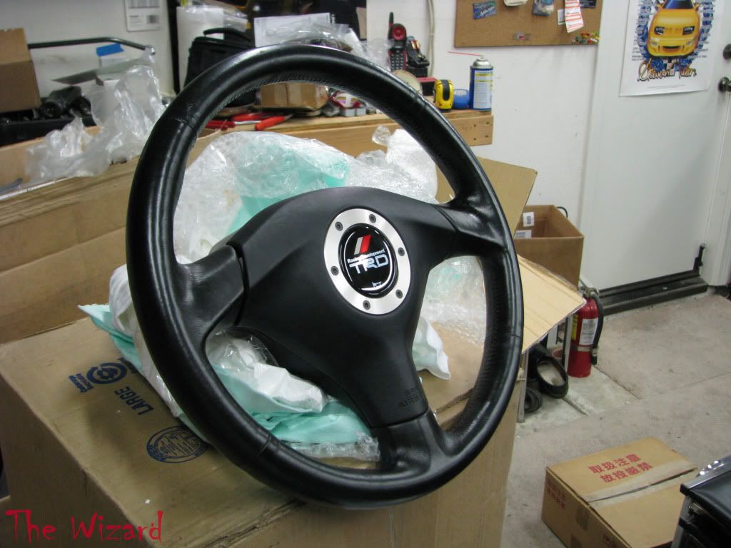

Old pic showing the Grandma Camry wheel
It's replacement. Hard to find discontinued TRD steering wheel with airbag

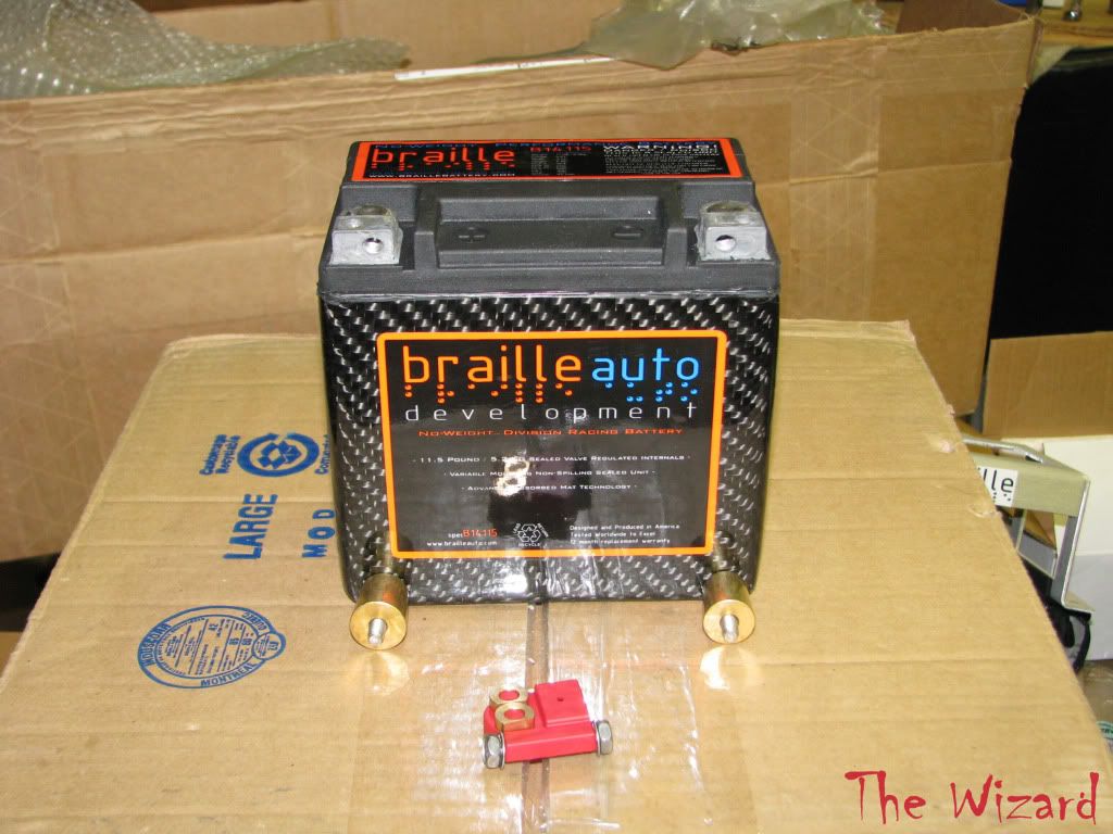

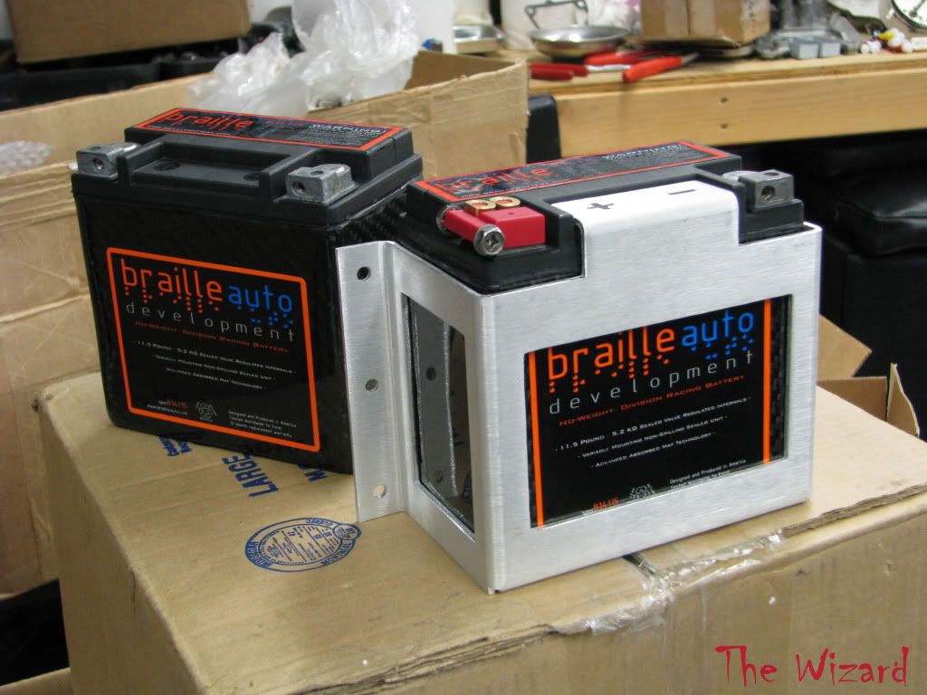

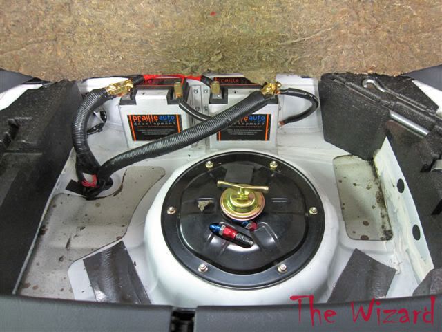

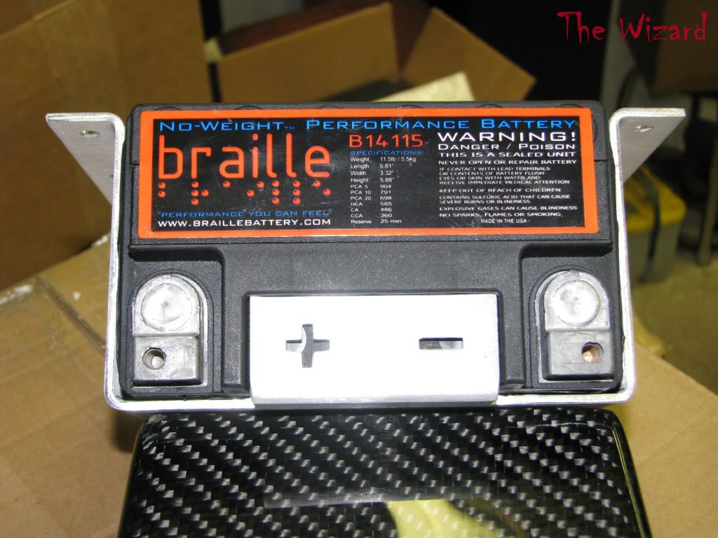

Battery had to be relocated to the trunk to accommodate the massive 4" charge piping etc
I'll be using two of these bad boys with custom brackets.
Old Nov 6, 2009 | 01:41 PM
  #124

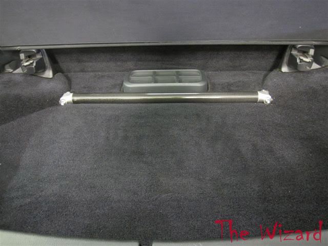

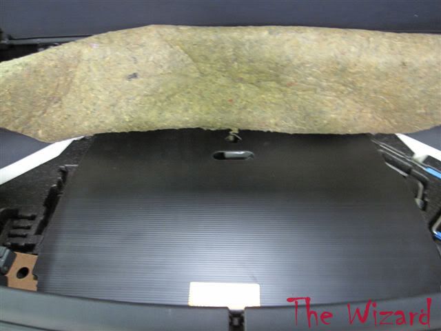

Batteries installed and hidden from view.
No obstructions FTW. OEM panel fits like it should
OEM carpet in place. Cusco carbon fiber rear strut tower bar can also be seen in this pic.

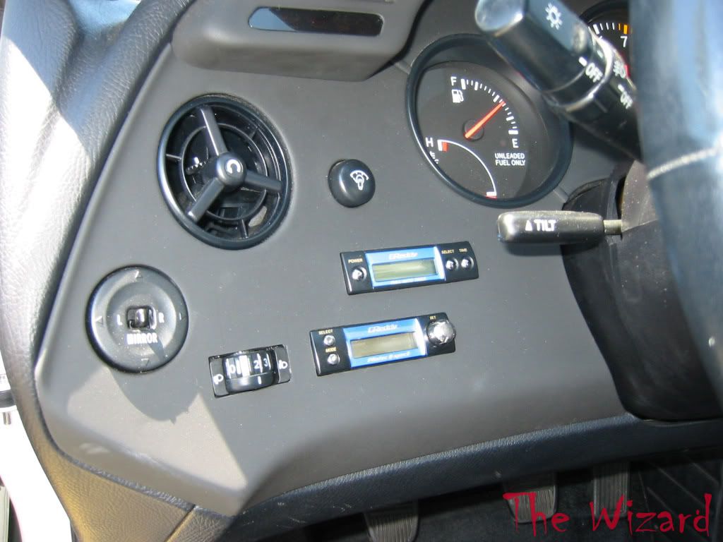

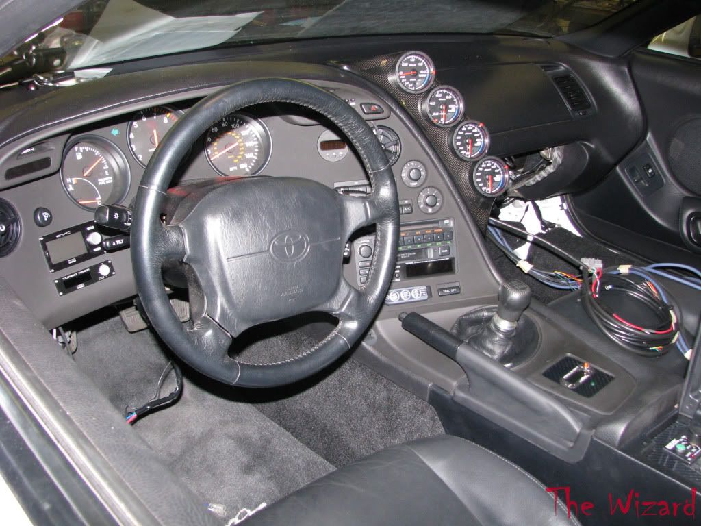

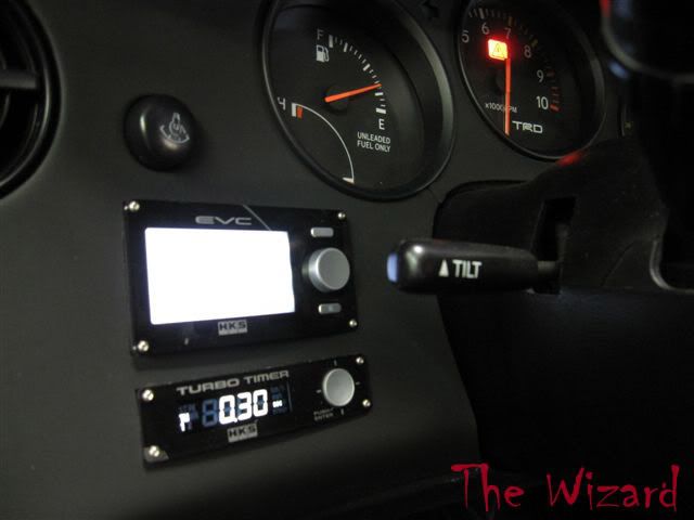

BEFORE
Greddy Boost controller and Greddy Turbo Timer. I installed them this way to mimick the layout of the AC controls
AFTER
HKS EVC Boost Controller. Best boost controller period. HKS Turbo Timer is shown below it.
Work in progress picture below

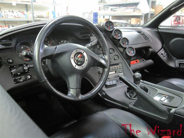

Titek Carbon Fiber gauge pod on the side of dash.
DEFI Advance CR Gauges (extremely hard to find in stock, luckily I found them from some vendor in Australia) are as follows:
Boost
Oil Temp
Oil Pressure
Water Temp
Features about DEFI control unit.
  • Interactive communication advanced system is implemented.
  • ADVANCE Control Unit can control up to 7 Defi-Link Meter ADVANCE CRs at a time.
  • Gauges can be controlled from distance with the included switch unit.
  • Opening and closing modes can be selected from 2 variations.
  • Warning by buzzer sound when the warning LED is on (buzzer sound can be turned on / off).
  • Peak value and warning value during driving are stored. Driving data can be stored and replayed up to 3 minutes.

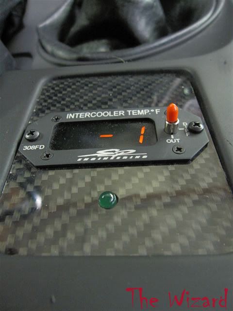

Custom SP Engineering intercooler gauge (inlet temp, outlet temp, and delta reading) surrounded in CF can be seen below the shifter. Other goodies in the armrest console. I'll get to those soon.

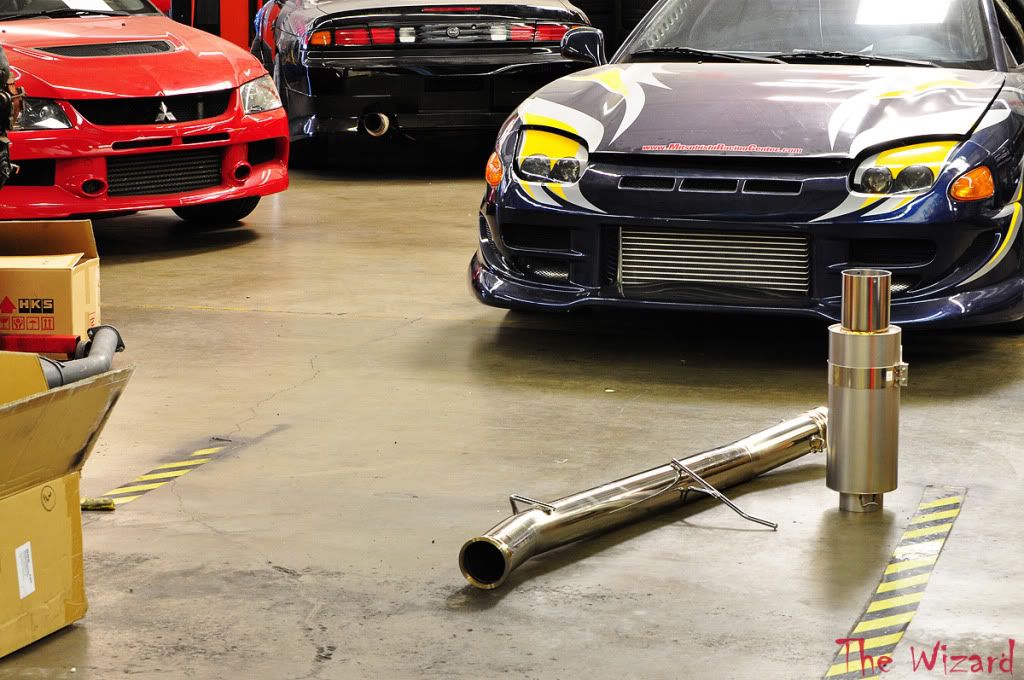

HKS 4" Titanium Exhaust.

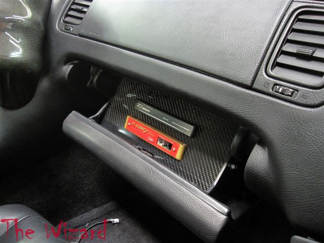

Vpro Engine Management system installed in Glove box surrounded in carbon fiber (on the bottom, DEFI gauge unit on top). This ain't no piggyback, this is a full standalone ECU computer. The EMS, 2JZ harness, mixture controller and all sensors set me back around 3k.
For those who don't know, it has proprietary software than only authorized HKS tuners can access. Much different than AEM where anyone can hook up their laptop and have at it.
Racelogic Traction control module (left)
HKS mixture controller (right)
Racelogic traction control is a pretty rare mod and had to be imported from the UK.
Based on the driving conditions, I can set the dial to help keep my back end in check. This, coupled with the TRD LSD I had installed (sorry, no pics) should keep me out of trouble. The Racelogic TC also has launch control as well (for drag racing purposes)
HKS mixture controller is tied to the Vpro EMS.
If I'm running 91 pump gas, I have the dial set one way.
If I put in 109 or C16 gas, I turn the dial to the correct setting.
So, at the turn of the dial, I have access to the different maps stored in the EMS. No need to hook up a laptop, upload new map etc

This cool this gadget is made by SPE. It's an air temp gauge. It has 3 settings. I can see the air temp before the intercooler (in), after the intercooler (out), or the delta (difference between the two)

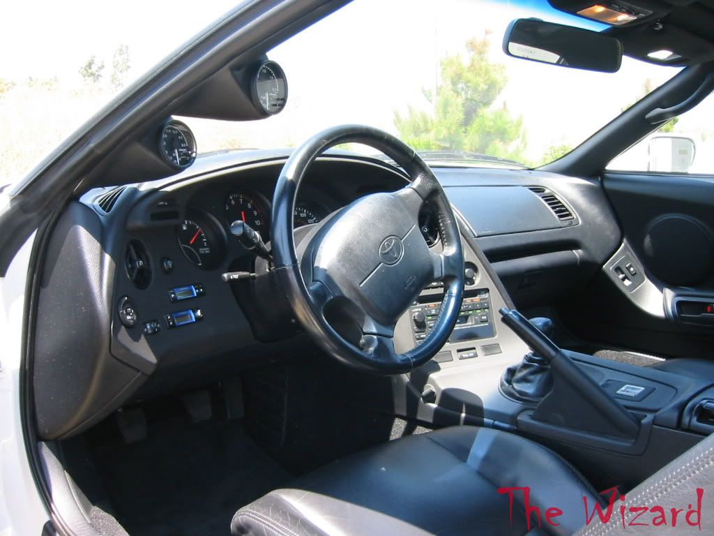

Granny wheel is gone, finally. LOL
Also, if you look closely above the right steering wheel stalk, you can the the HKS A/F knock Amp. I had a second wideband O2 sensor installed on the second turbo so now I can monitor the A/F ratio of one bank (one turbo), the other bank (second turbo), or the delta between the two. I'll ask SPE for a good closeup.

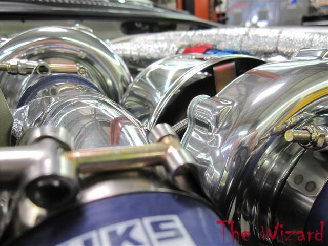

Here's a shot of the thermostatically controlled Greddy oil cooler. Custom brackets had to be fabbed by SPE for this trick install. HKS BOV can be seen as well.
Turbo time!!
Check out the reflections on all those polished pieces!

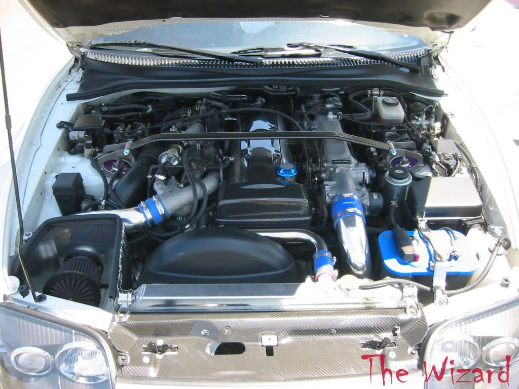

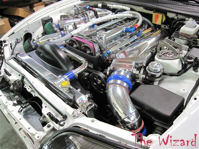

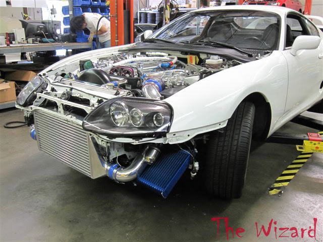

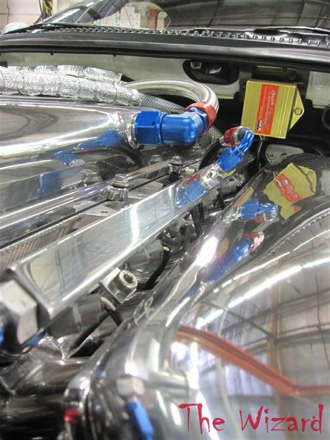

High res engine bay pics coming soon. These have have to do for now. Enjoy.
BEFORE
AFTER

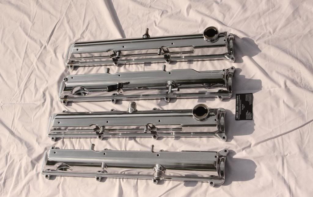

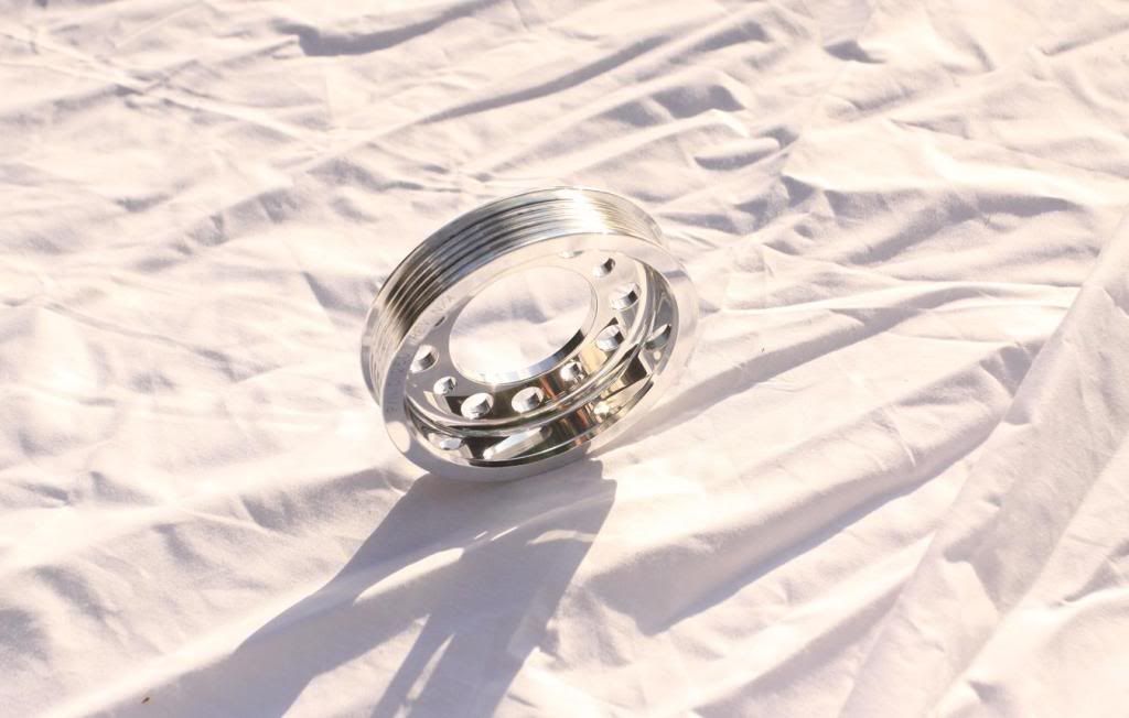

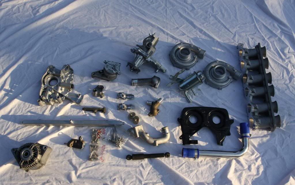

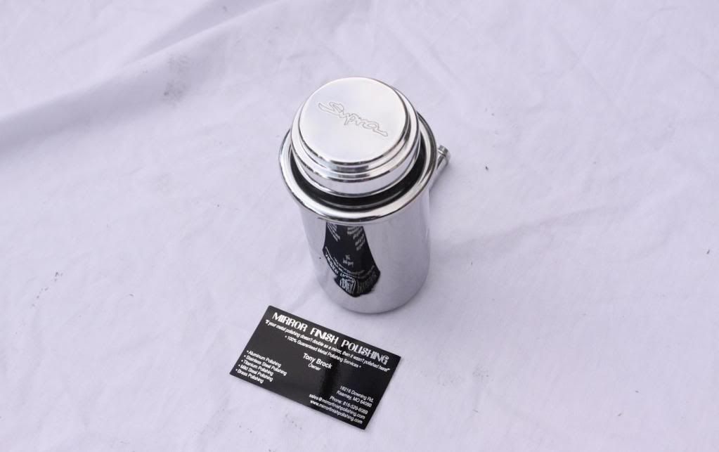

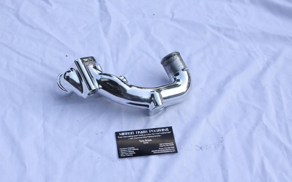

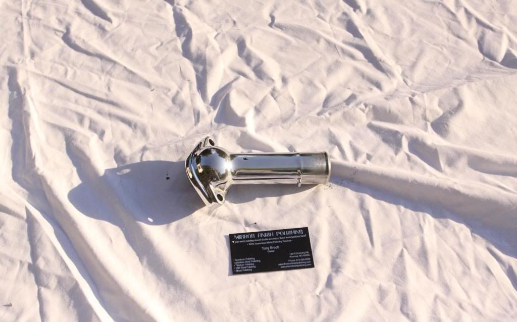

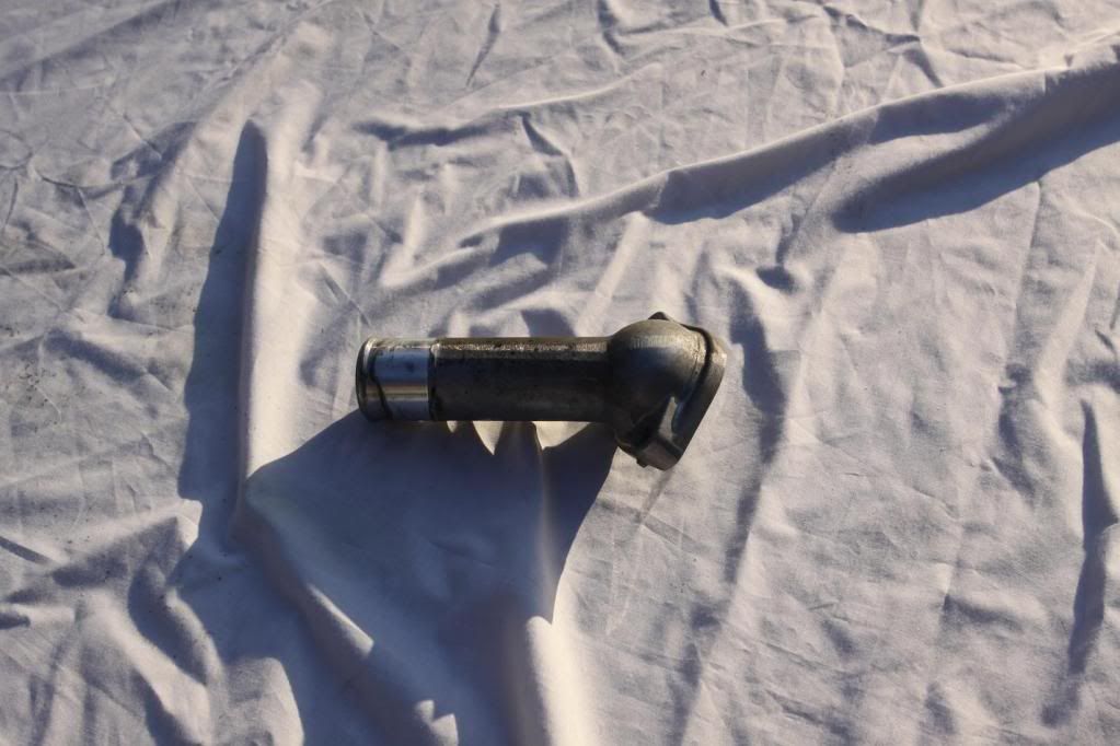

While I'm putting the final pics together, I thought I post some pics of the polishing work done.
This pic is about 1/2 the parts that were polished.
BEFORE
AFTER
BEFORE
AFTER
Old Nov 10, 2009 | 05:29 PM
  #149
BEFORE
AFTER
BEFORE
AFTER

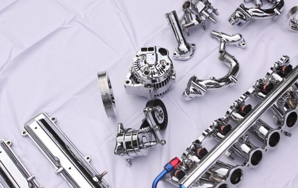

Old Nov 10, 2009 | 05:31 PM
  #150
Bling Bling!!
I even had two worm clamps polished
Alternator
Cam gear backing plate
Old Nov 10, 2009 | 05:34 PM
  #151

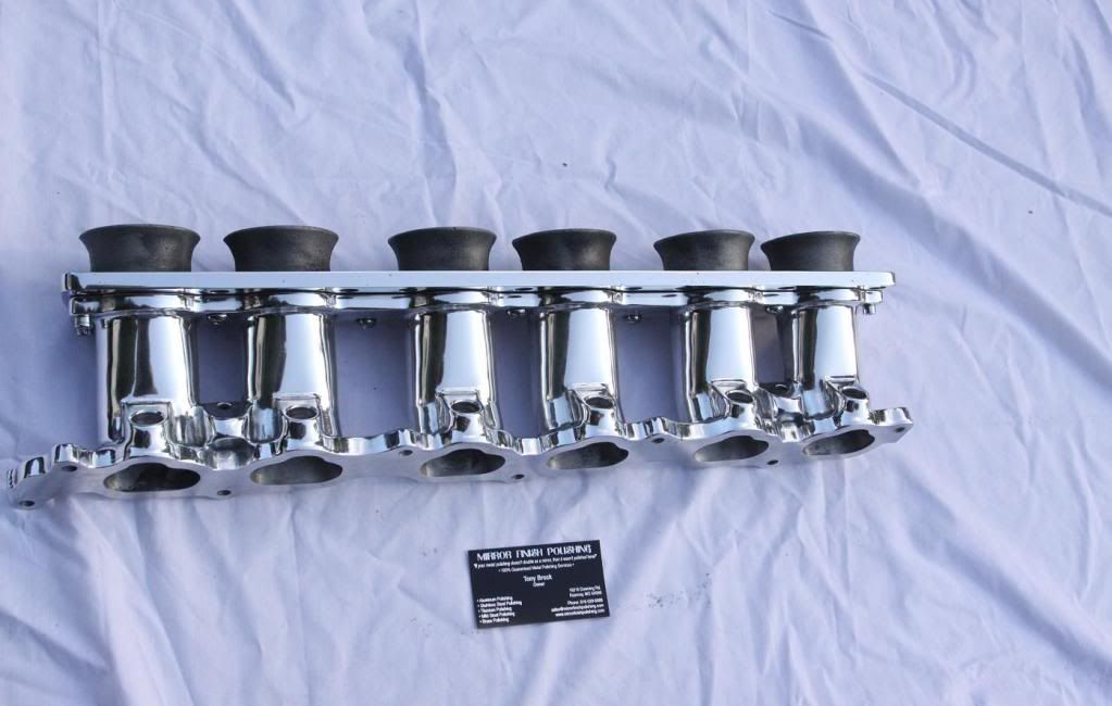

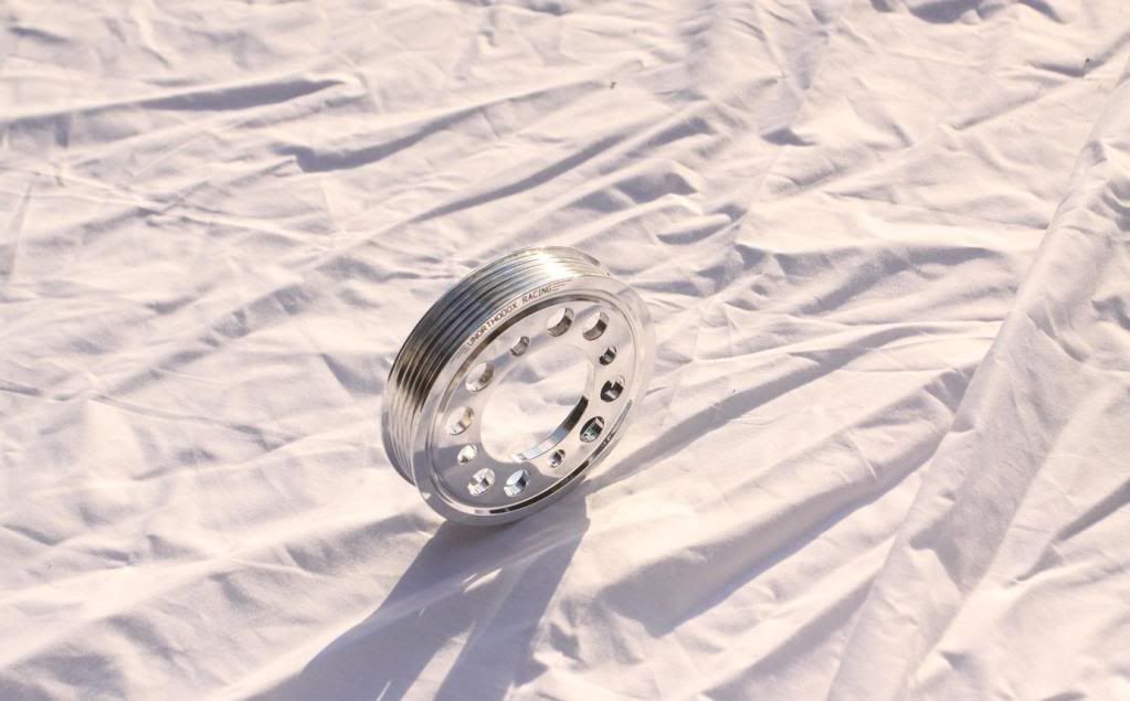

Veilside intake manifold runners
Pulleys

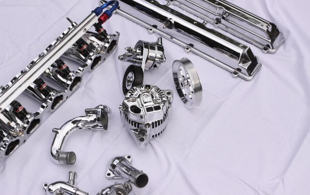

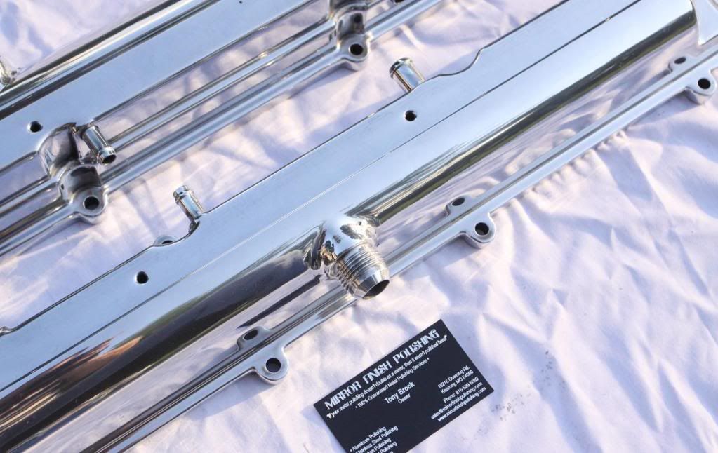

I had -12 AN fittings welded into the valve covers, grinded down the welds and all polished up.
Old Nov 10, 2009 | 05:37 PM
  #152

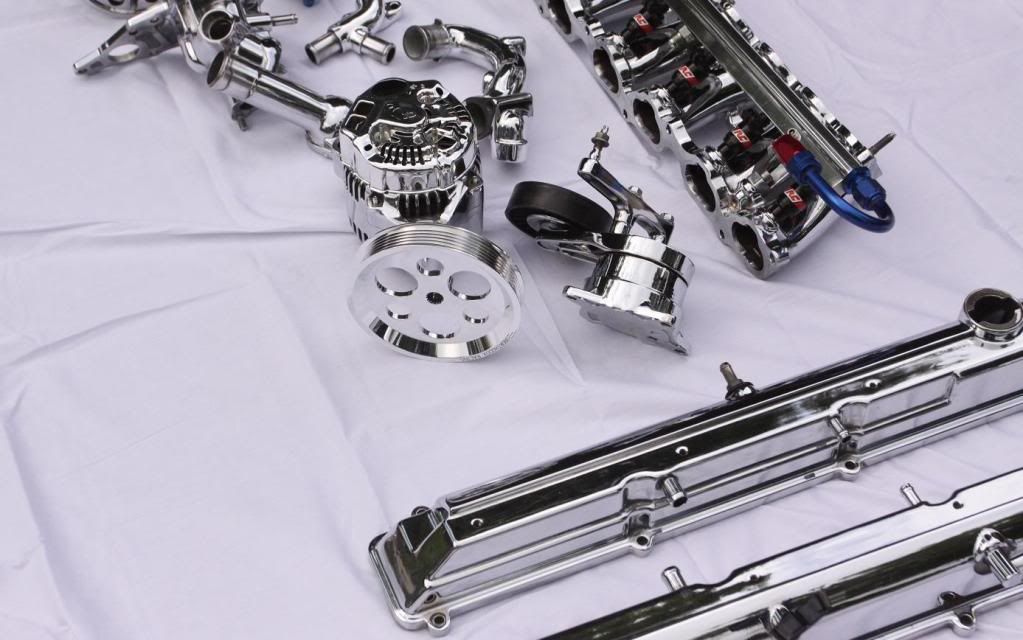

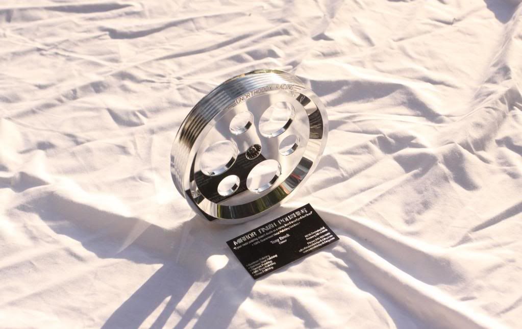

In the following pics, half the parts are chromed (not mine), and half the parts are polished. Can you tell the difference??
These pics illustrate that with the right shop, polishing can look just as good as chrome.
Old Nov 10, 2009 | 06:15 PM
