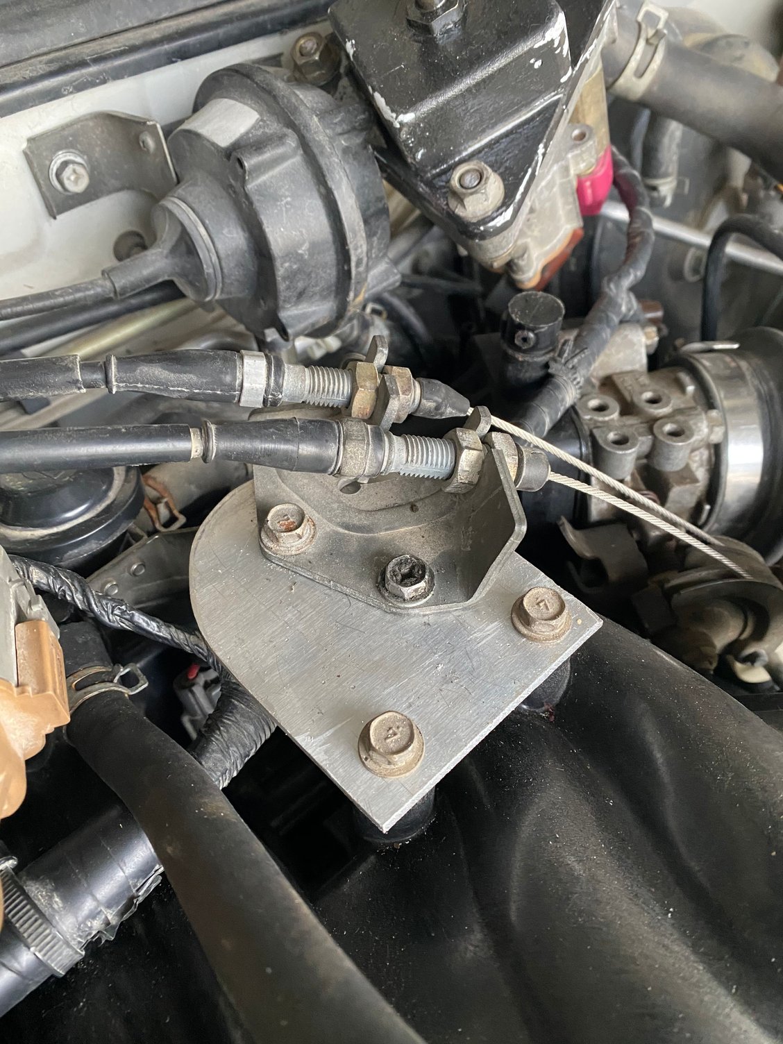

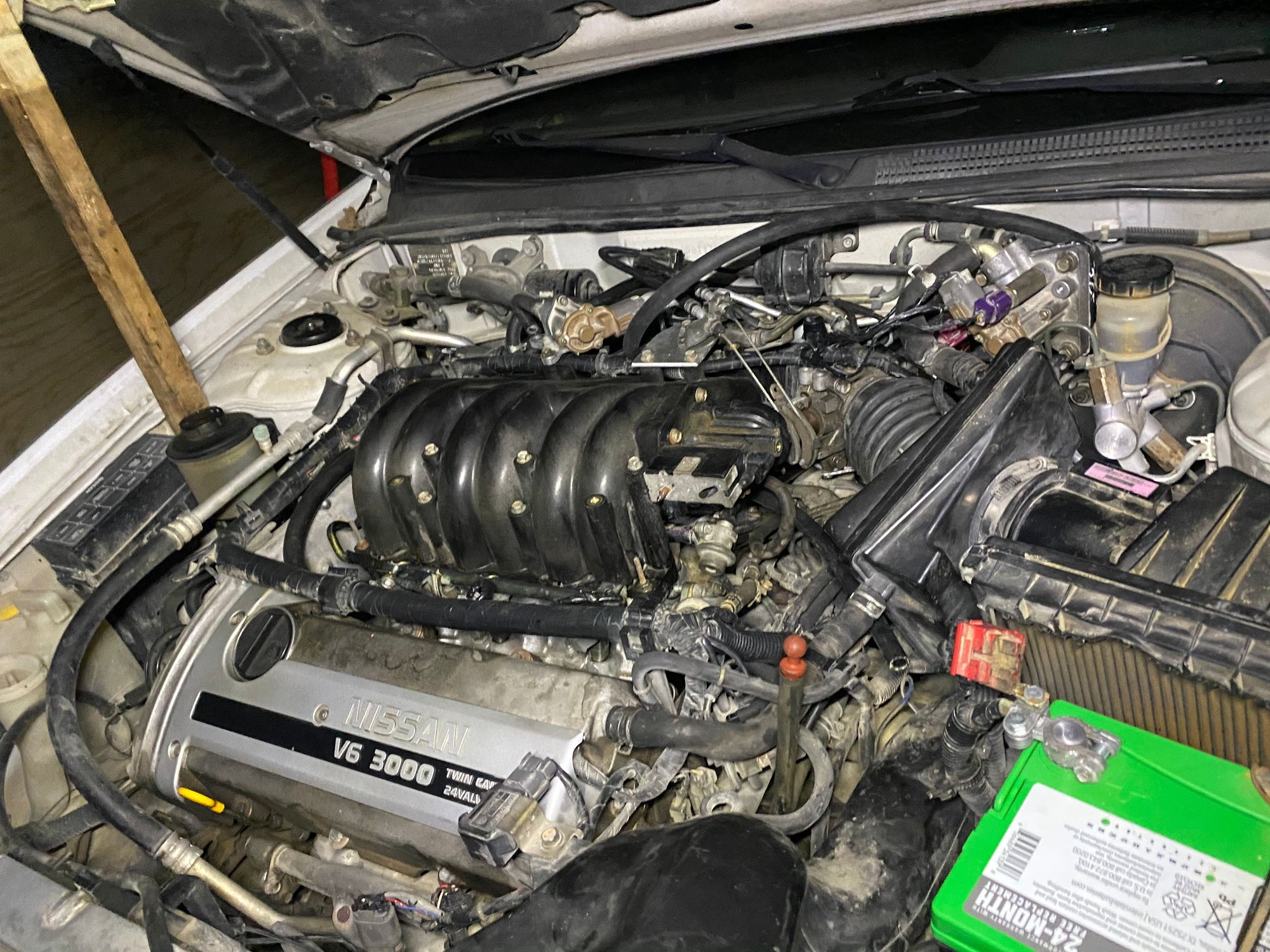

I used my factory air box and rotated it 90* so the filter is facing forward and hacked everything beneath the clips off.
PCV goes to a catch can in front of the battery and EVAP vents to atmosphere (I had an EVAP code prior to swap)

Throttle cable bracket
Engine bay before I wired in the RPM switch.
