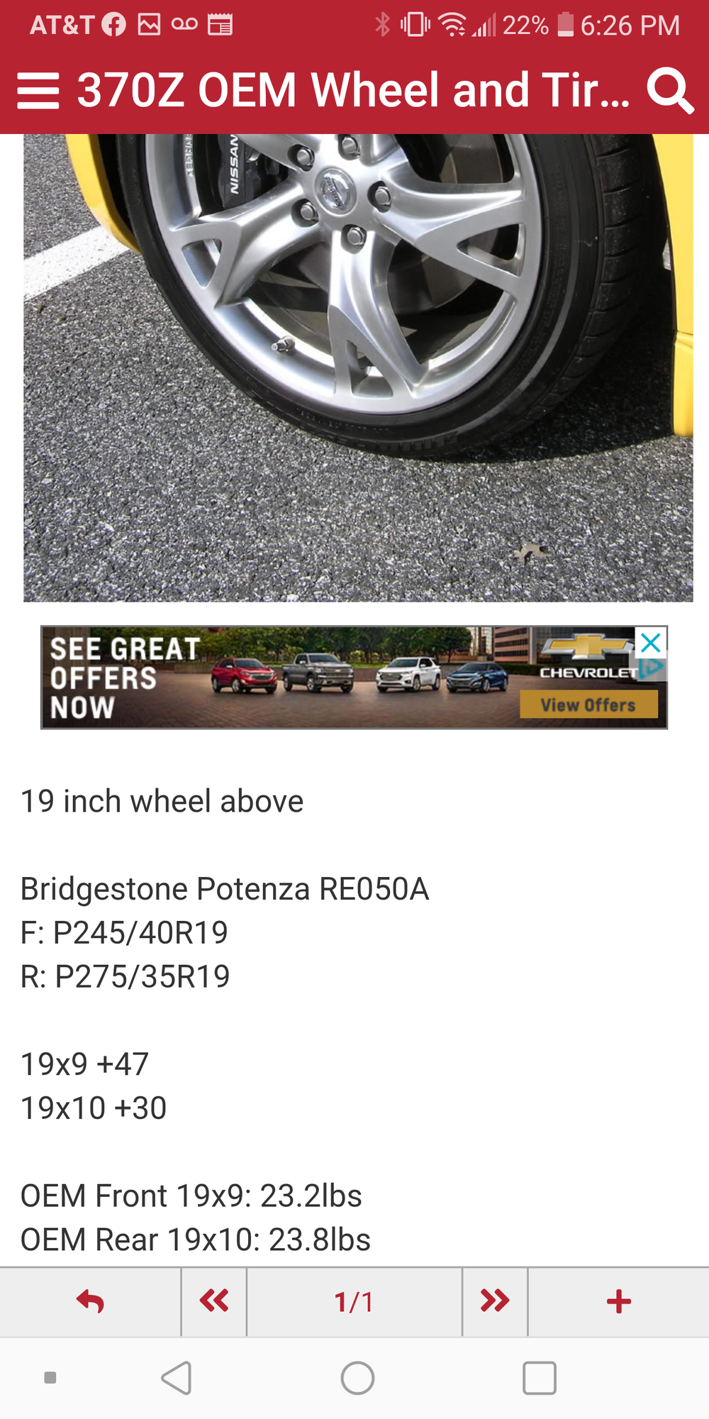

Too lazy to type on my phone. Here's a screenshot.
Wheel specs
Fronts have 25mm spacers (maybe 20, doooont quote me)
Rears are just direct bolt on.
Tires are 245/35 front 255/35 rear
Yes it rubs.

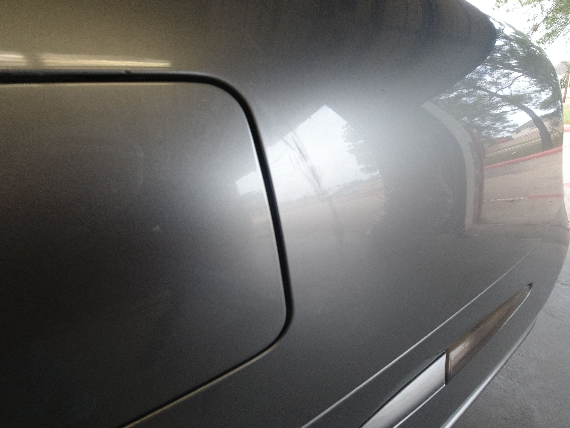

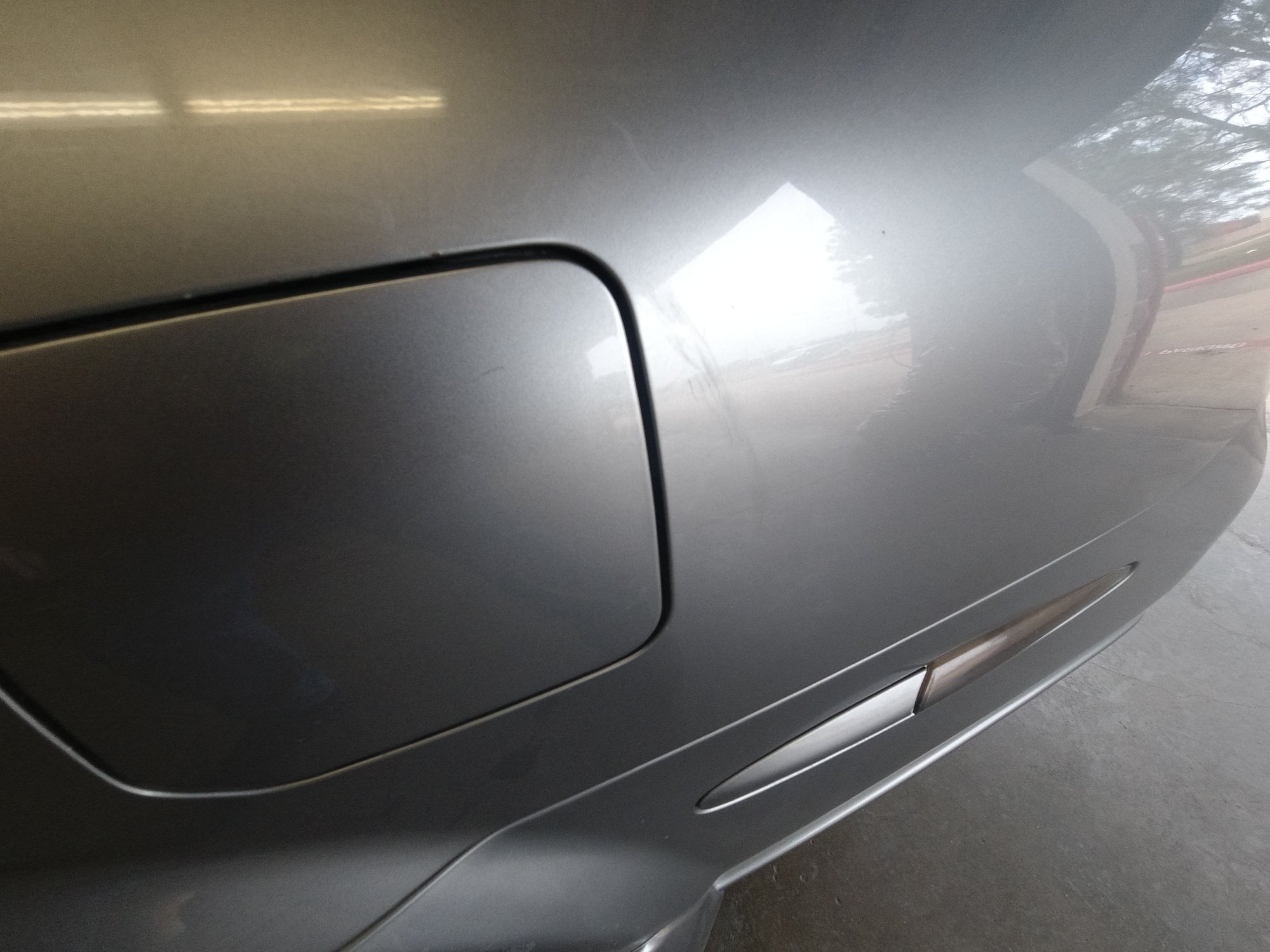

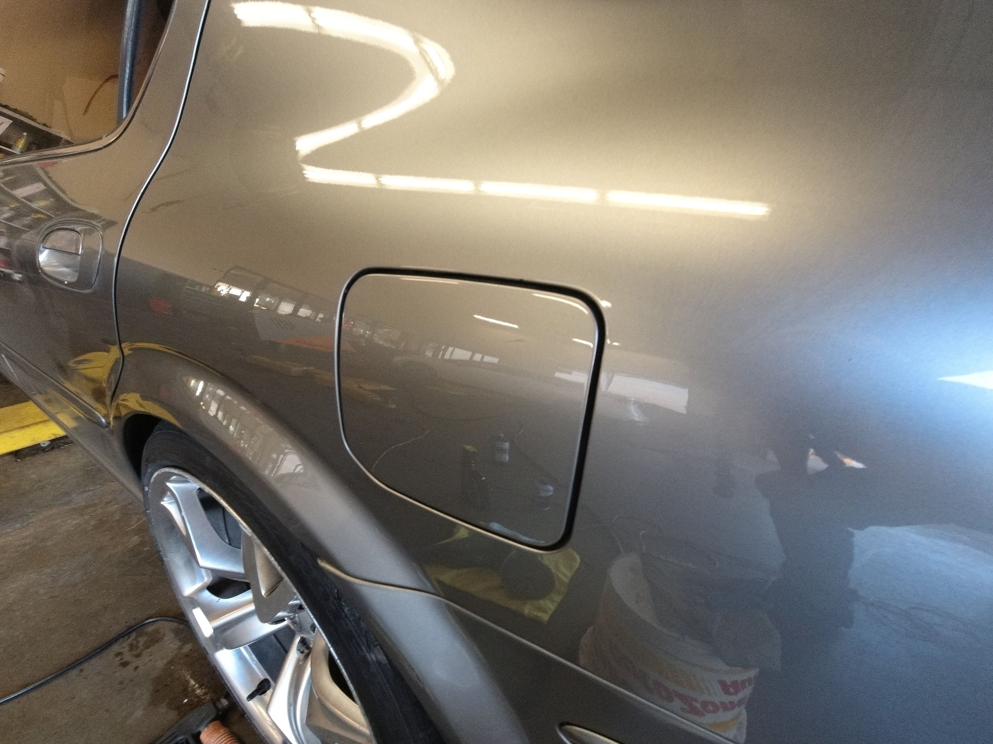

Took another shot at detailing today. I had some scratches from a gas can. Took a few passes with the dual action and well you tell me!
Andddd after

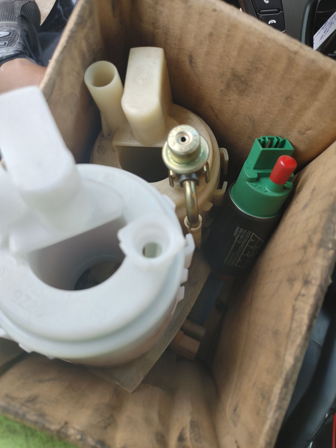

I am redoing the fuel system a smidge to accommodate for e85.
​​​​​i dropped off my injectors at a local injector shop to have them cleaned and tested. Will have details of that later. As for the pump..... I have a wealth of A33 spare parts so I took apart one of my old fuel pump assemblies, ordered a new oem filter and AEM 340 fuel pump (same one in ol' Red) and re-assembled the assembly. Here are some photos.
Parts used:
Aem 340 lph avm-50-1220
New oem fuel filter.
Original fuel pump assembly from the car (the car currently has the walbro 255 and assembly from my old i35).
Anywhoooo on top of all of that, I ordered a new air filter and bellmouth for the intake and welp that's all the time and money I have for the t00n.

I really can't take any credit.... It's definitely a drop in mod.
HOKAY! QUICK RUSH IN A HURRY TIME FOR T00N!
Fuel Pump? Good (see above post)
Lines? Thug life #stock.
Injectors? Clean, tested, functioning well
Air Filter? New, also purchased a 7" bellmouth. Staying with 4" Maf and Intake tube cause I'm not too terribly interested in spending MORE money on this car. Plus with the RPMS going as high as they're (7600) going, technically a 4" will make more peak power (note the usage of the word "peak").
Fluids? Topped and checked (Coolant, Oil, Power Steering, Gear Oil).
(That staticky haze is actually rain drops... Well that's how it looks on my laptop)
E85? First 6 gallons went in, the tank was surprisingly dangerously empty when I did the fuel pump (Only the internal baffle had fuel left lmaooooo - My sketchy mpg math was on point).
How does it drive? Fine..... However any time I try to add a little pepper to the gas the AFR gauge pegs out to 10....... But light throttle driving the AFR actually stays in the 14s
Summary (incase you're lazy or if you can't understand what I type, also a high possibility).
To clarify. I have a tune for a 4" intake on stock 03 injectors. I put in a new pump, fuel and air filter, and 600CC injectors and the car is drivable... However extended idle is..... Rough.... And whenever I try to do anything more than oh... 15% throttle afr starts sinking hard toward rich. This is strictly a limp the car to the dyno setup. I feel confident enough to drive to work, fill up on e85 (trying to work out any remnants of 93), and get tuned.

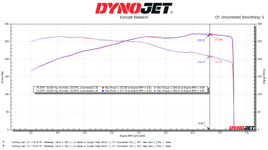

272/264 Dyno!
Well this ended up being a torquey bastid.
This emanage ultimate dip is bought to by using a 4" maf on the stock ecu.
I'm sold. Hybrid builds for everyone. No more fooley macgooley hr swaps
Next hybrid build will be quite rediculous in terms of lego blocking.

Mmmm, talk about area under the curve, that looks great! So this was straight E85? Post your damn mod list up, I can't keep track of all your builds and changes!
Old Mar 5, 2021 | 07:37 AM
  #66
aackshun's Avatar
Posts: 5,398
My current mod list is always in the first post on all my threads.
I only made two changes just now, the injector cc was incorrect and changed the first line to say tuned on e85.
