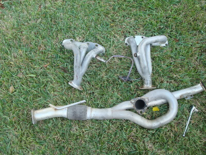

So your headers look like these...
Originally Posted by NmexMAX
That's interesting. How the hell did they accomplish that? Probably needed some modification to the stock y at the very least.
I'm assuming he has the eBay short headers...
I was assuming the same thing for now.

someone fill me in.. lol. Just bought the car a couple weeks ago. Thats what the craigslist ad said... hotshot headers, greddy catback with test pipe
Old Feb 29, 2012 | 06:41 AM
NmexMAX's Avatar
dot dot dot ...
Posts: 34,576
From: Santa Fe, NM
Pictures of said stock y-pipe would help.
