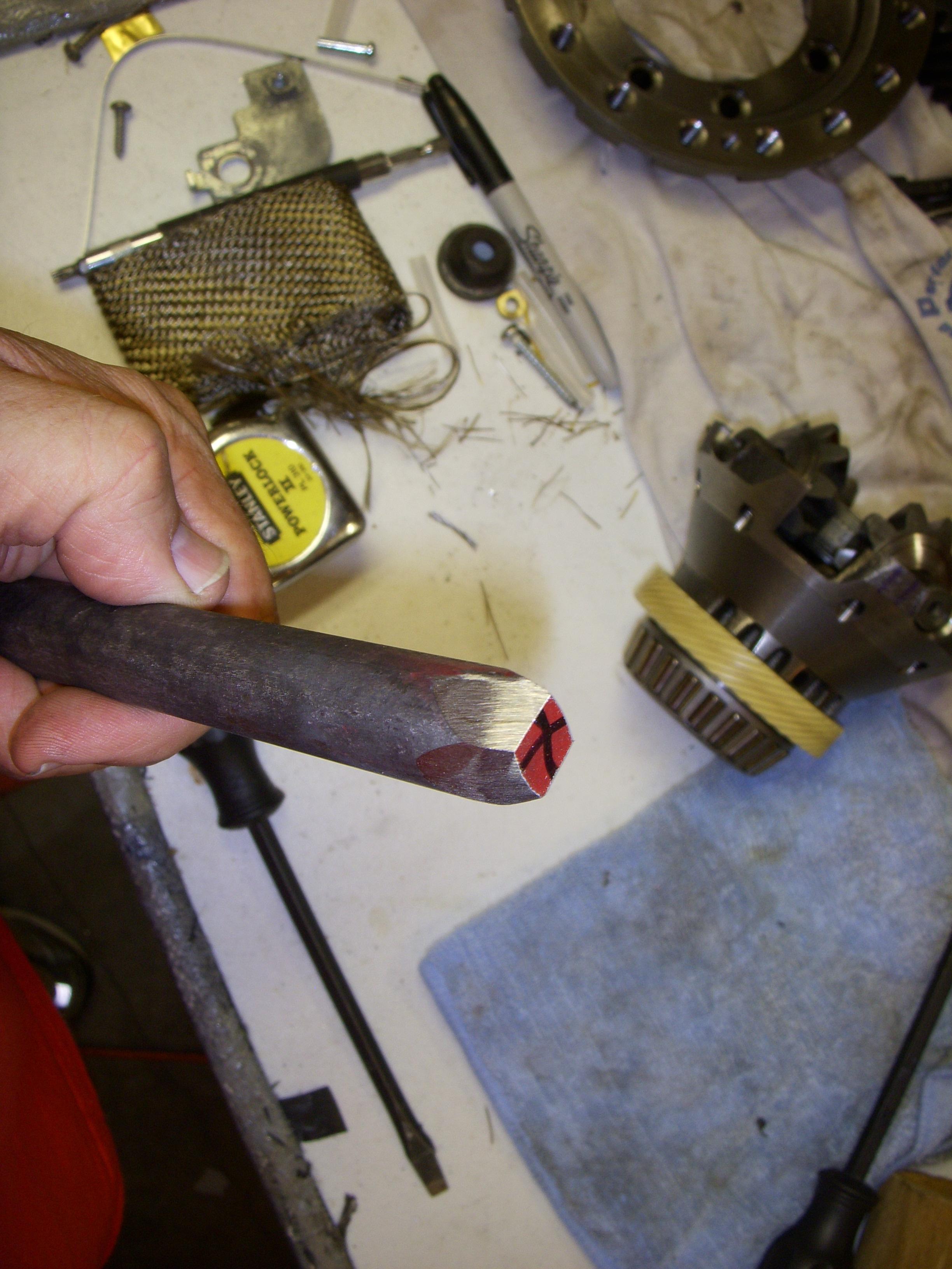

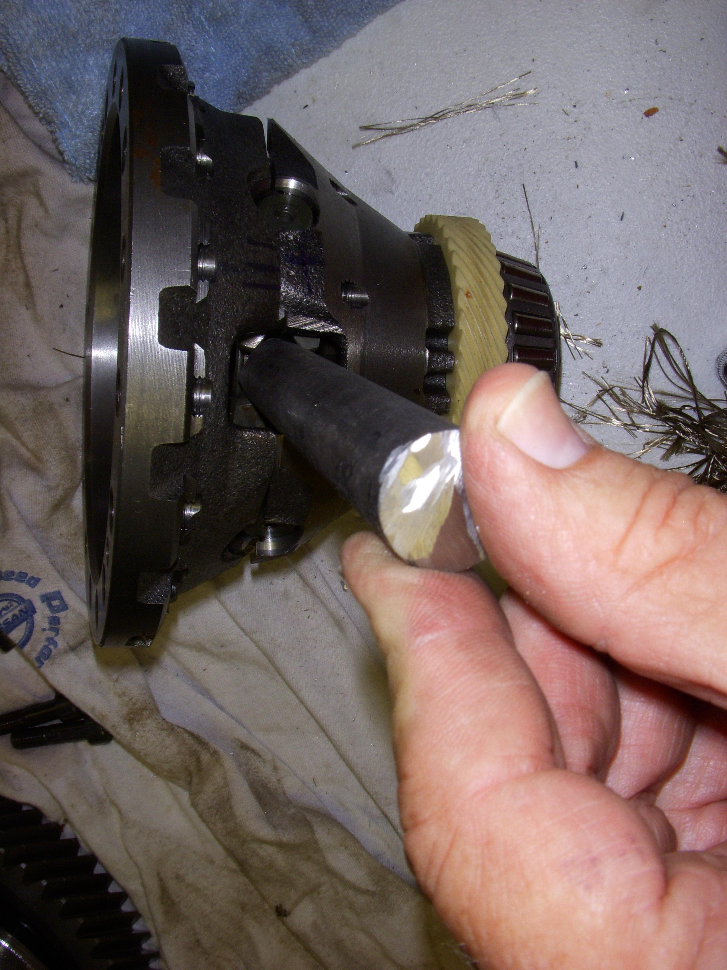

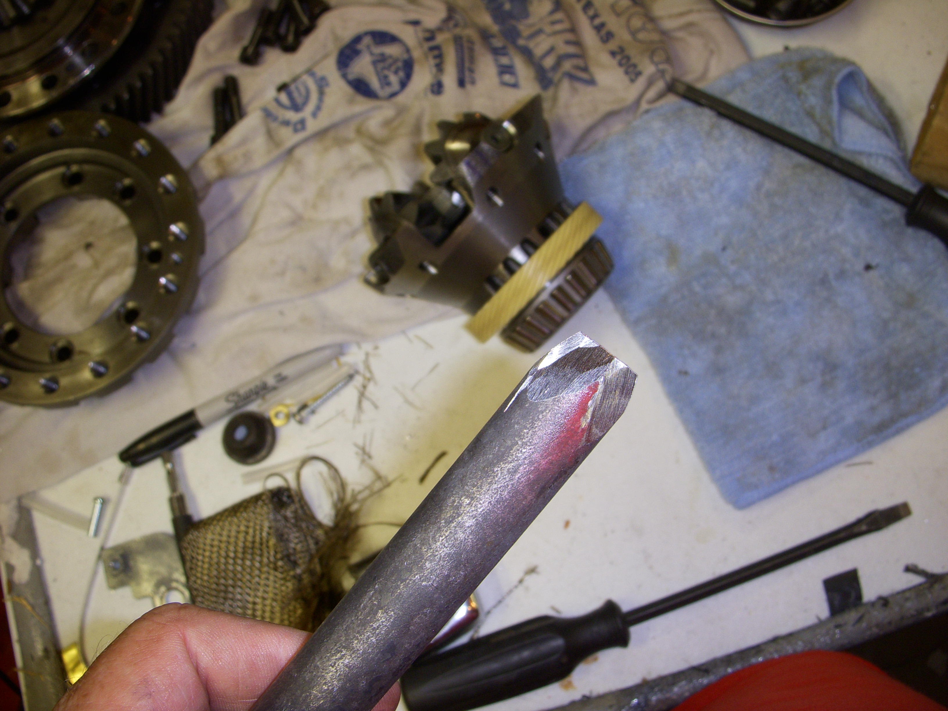

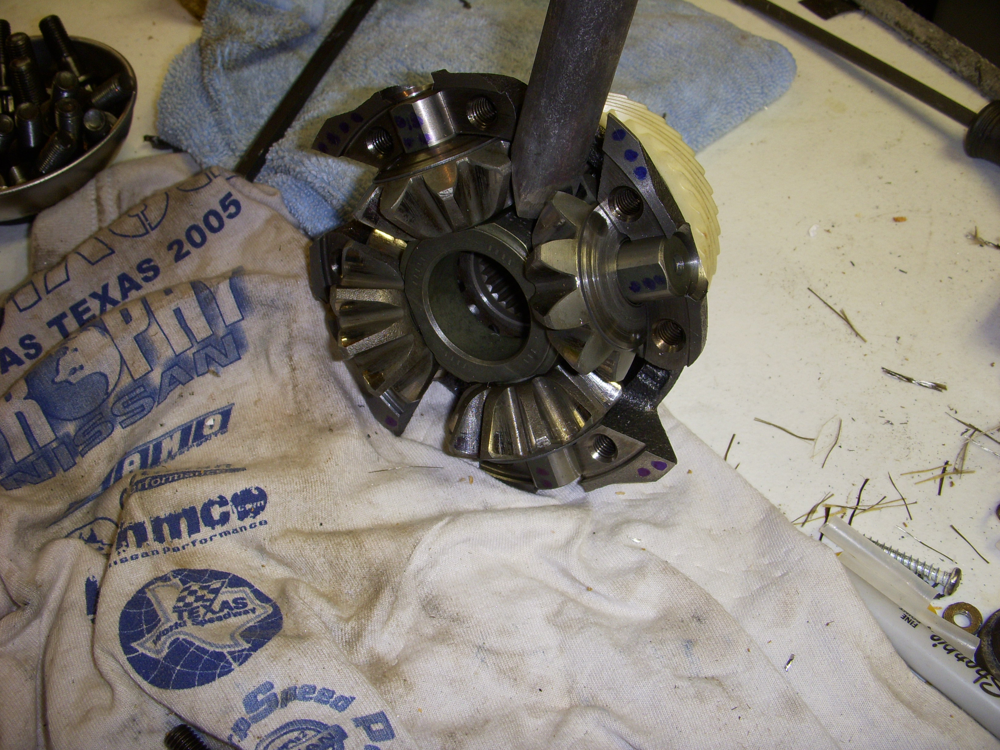

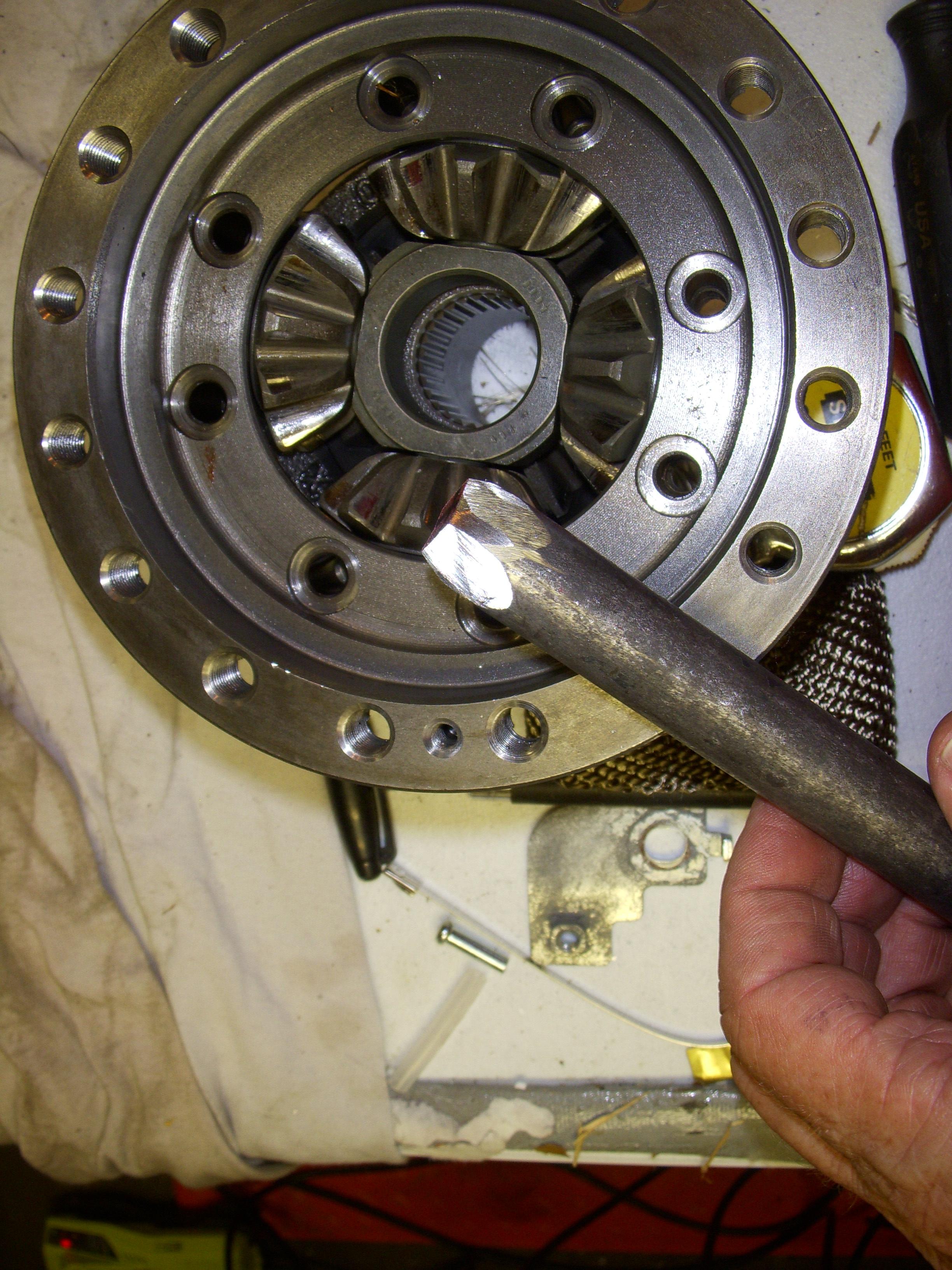

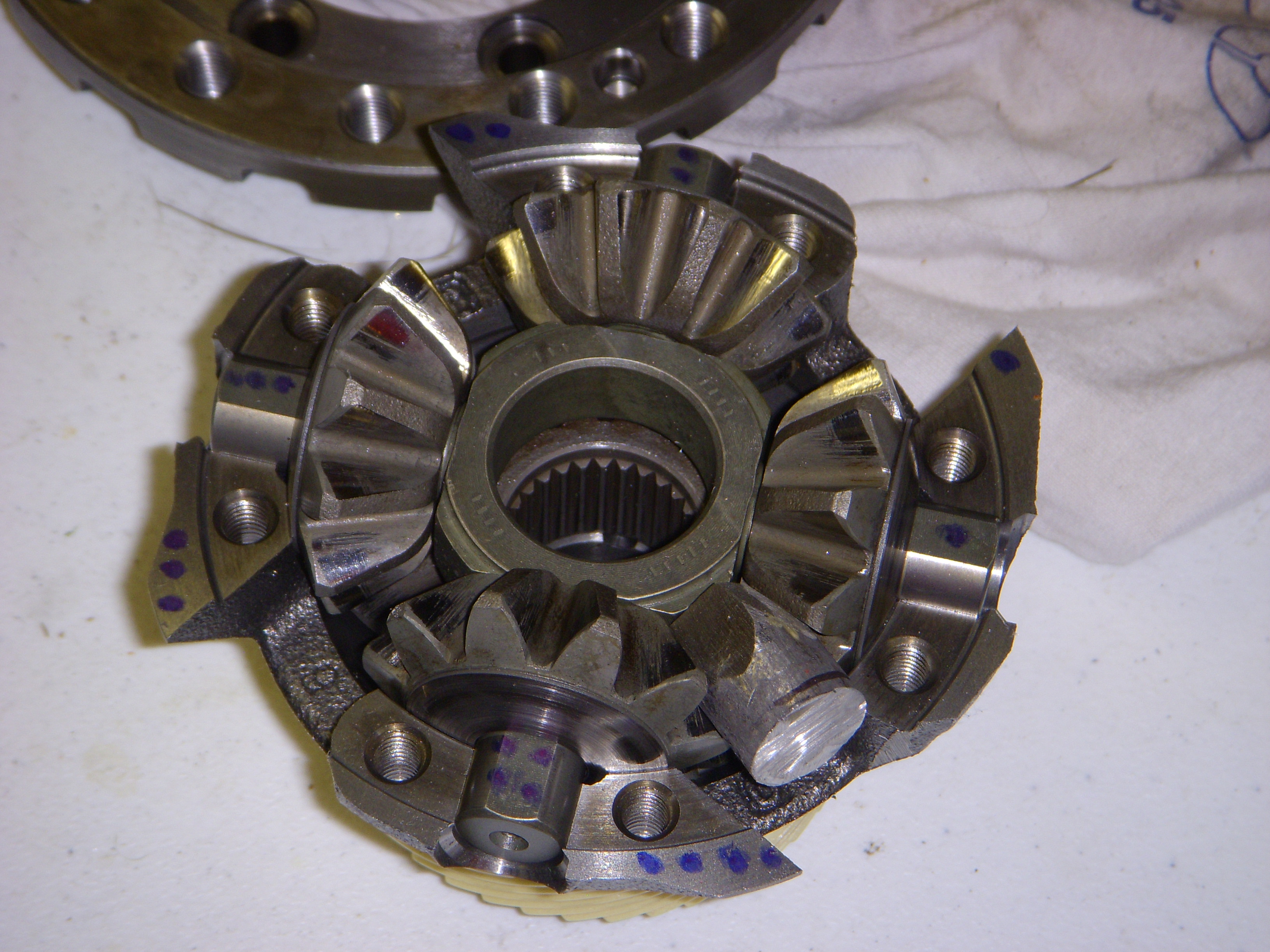

I picked a piece of 3/4" steel rod yesterday that I think I can cut up and grind down and make four pieces to fit between the pinion gears to lock up the diff. If this looks good, I will have them welded in place and then swap out diffs in the car.

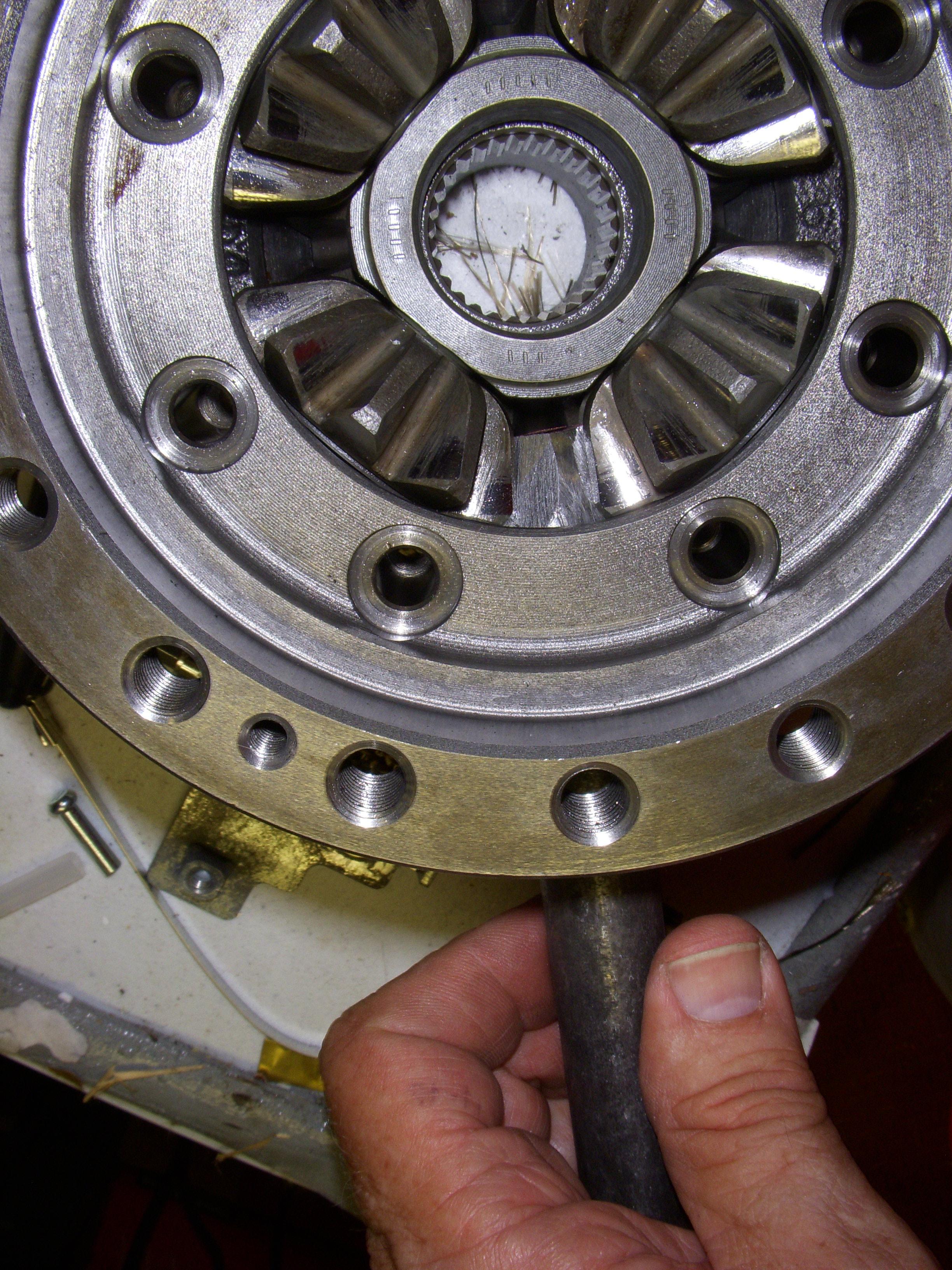

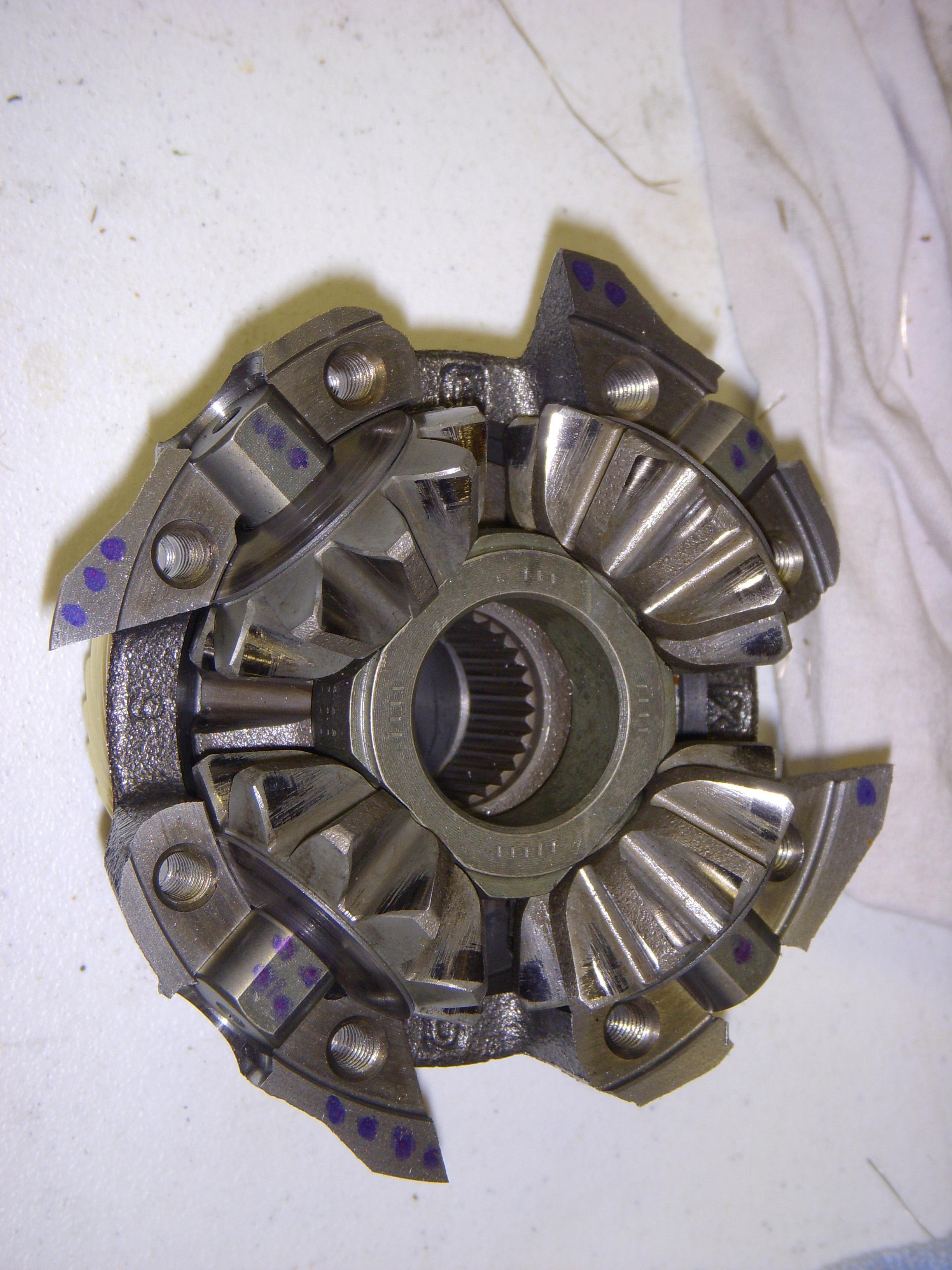

Did more work on locking diffy
I cut off a chunk of the 3/4" round bar and used a body grinder to shape one end to insert between two adjacent diffy gears. This might actually work... Cut off the end piece, insert between gears, TIG-weld in place, repeat. Now if I just had a good welder - and I could weld... Hmmm, anyone recognize the T-shirt on the work table? From some annual event with Maximas??

get a lincoln 140 or higher gas welder, put the gears and rod in the oven for about 30mins on 400 and go to town. Then put them back in the oven while it's still warm but off and let them come back down to room temp

I 've been thinking about what to do with the differential if I can lock it up with tapered chunks of steel welded into the gears so it can't rotate. It's been a pain to swap out the entire differential since I need a shop to drop out the transmission and then it goes to a transmission shop to install the replacement diffy after checking all the clearances and changing shims if needed. This is an expensive transmission so I don't want to have a bad diffy blow it up before I manage to do it myself.

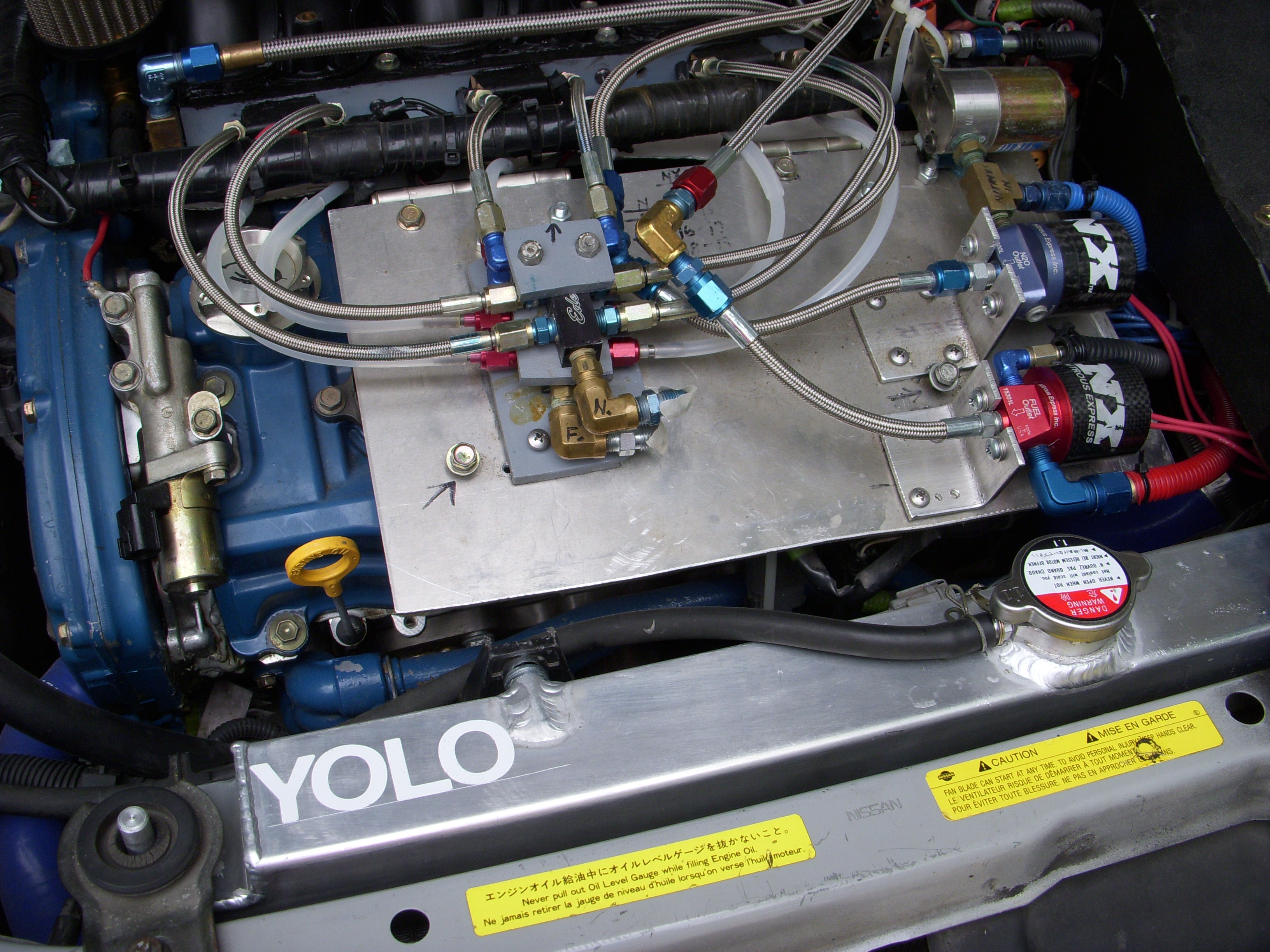

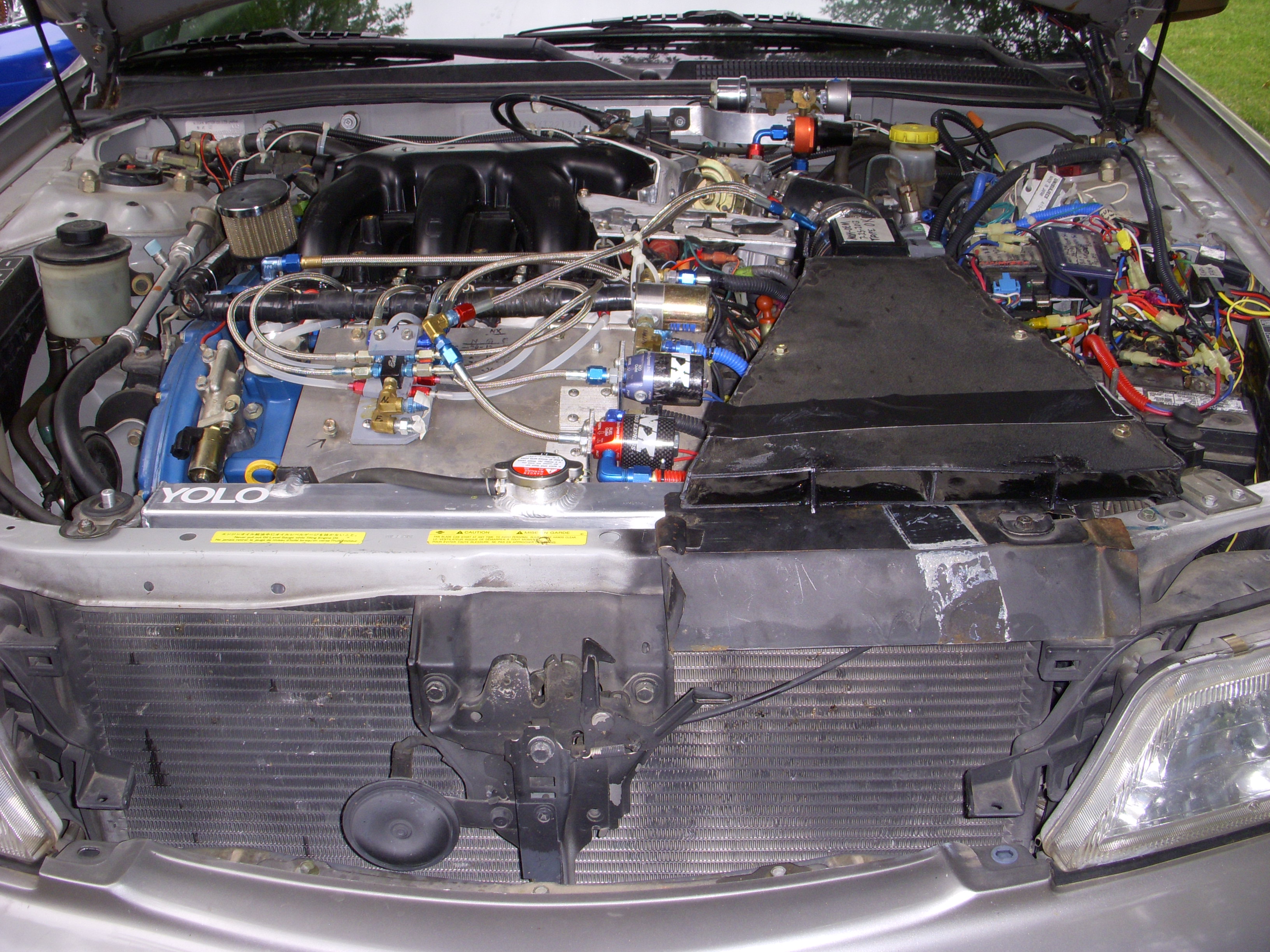

New radiator

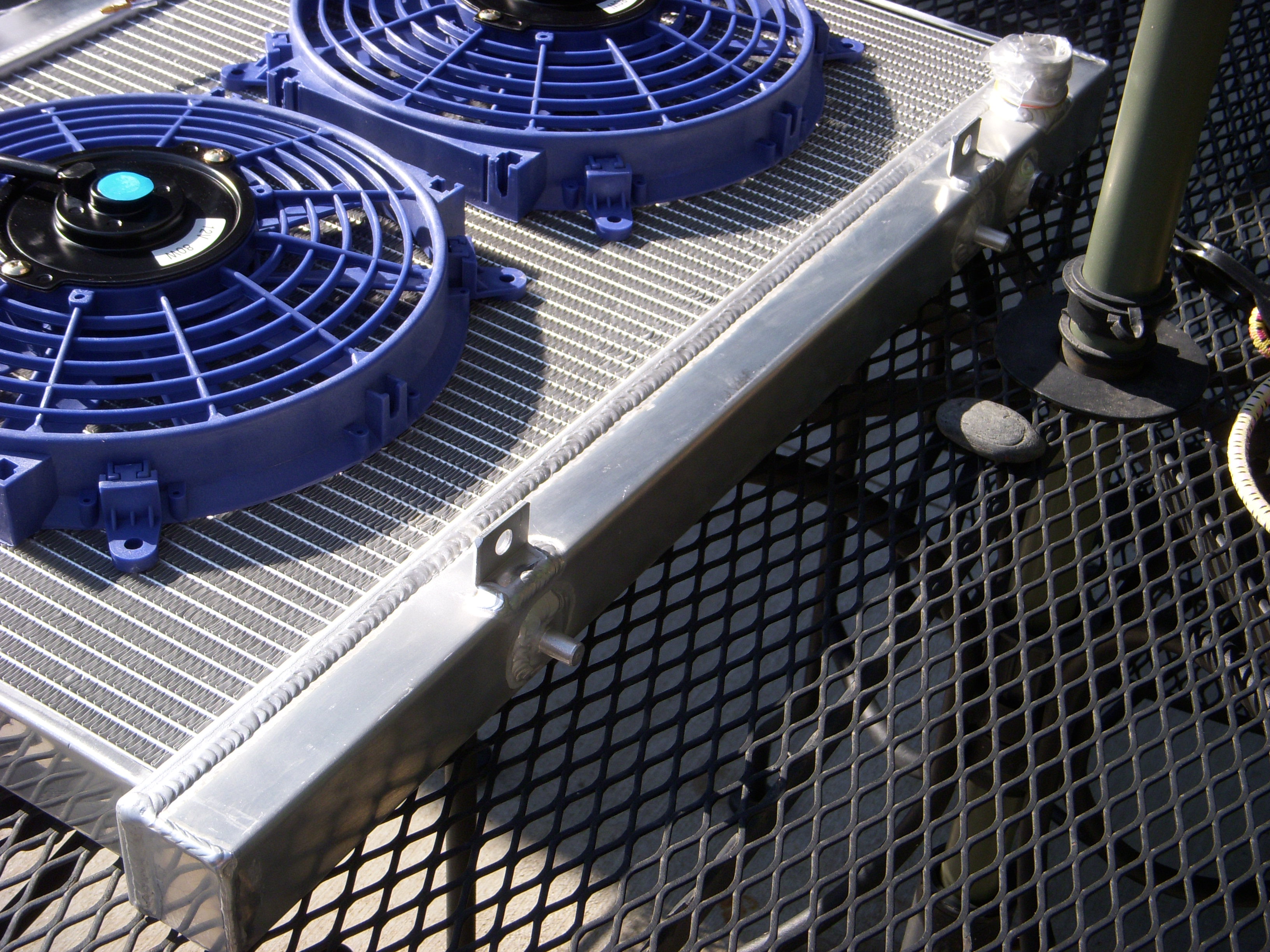

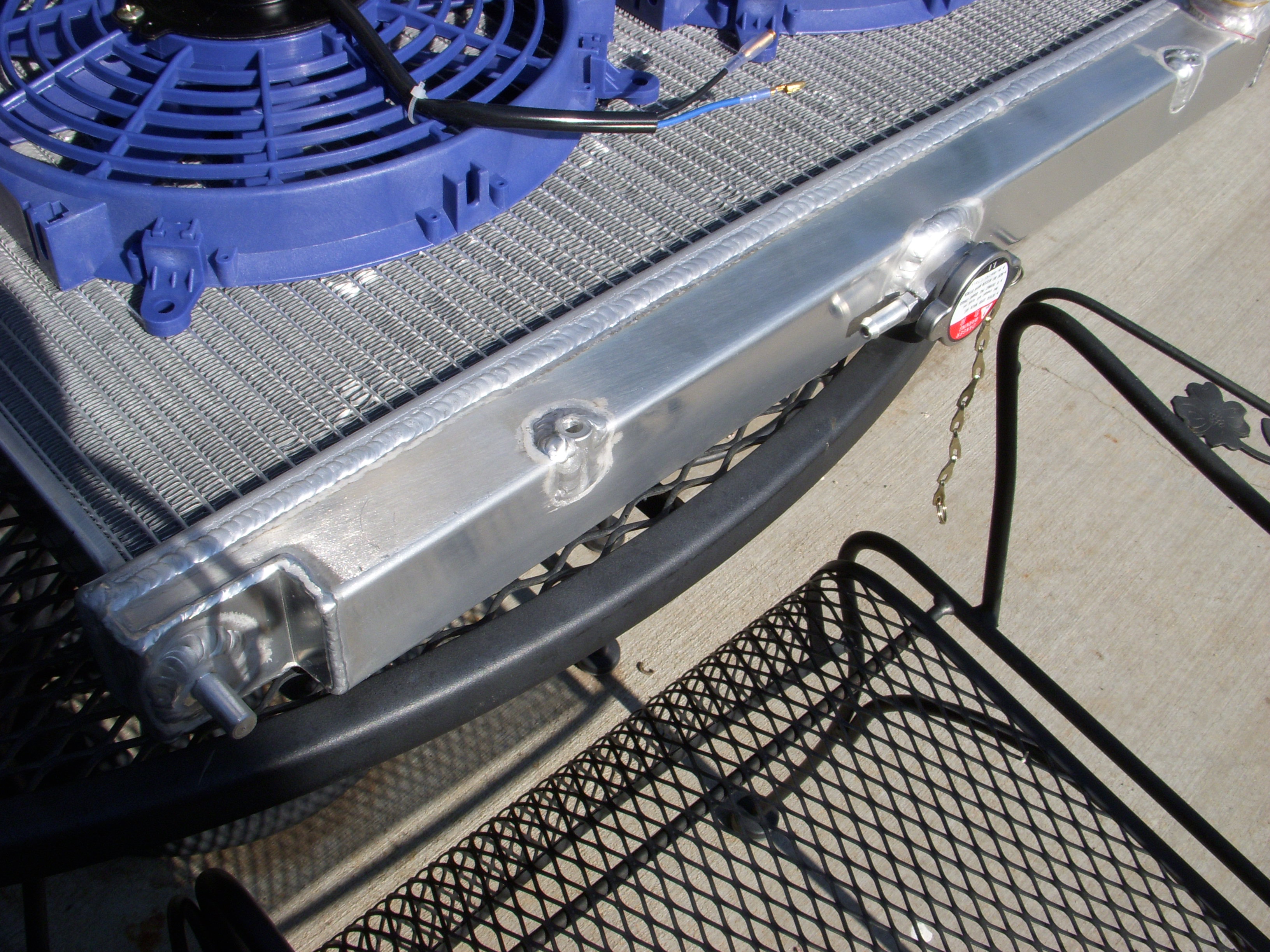

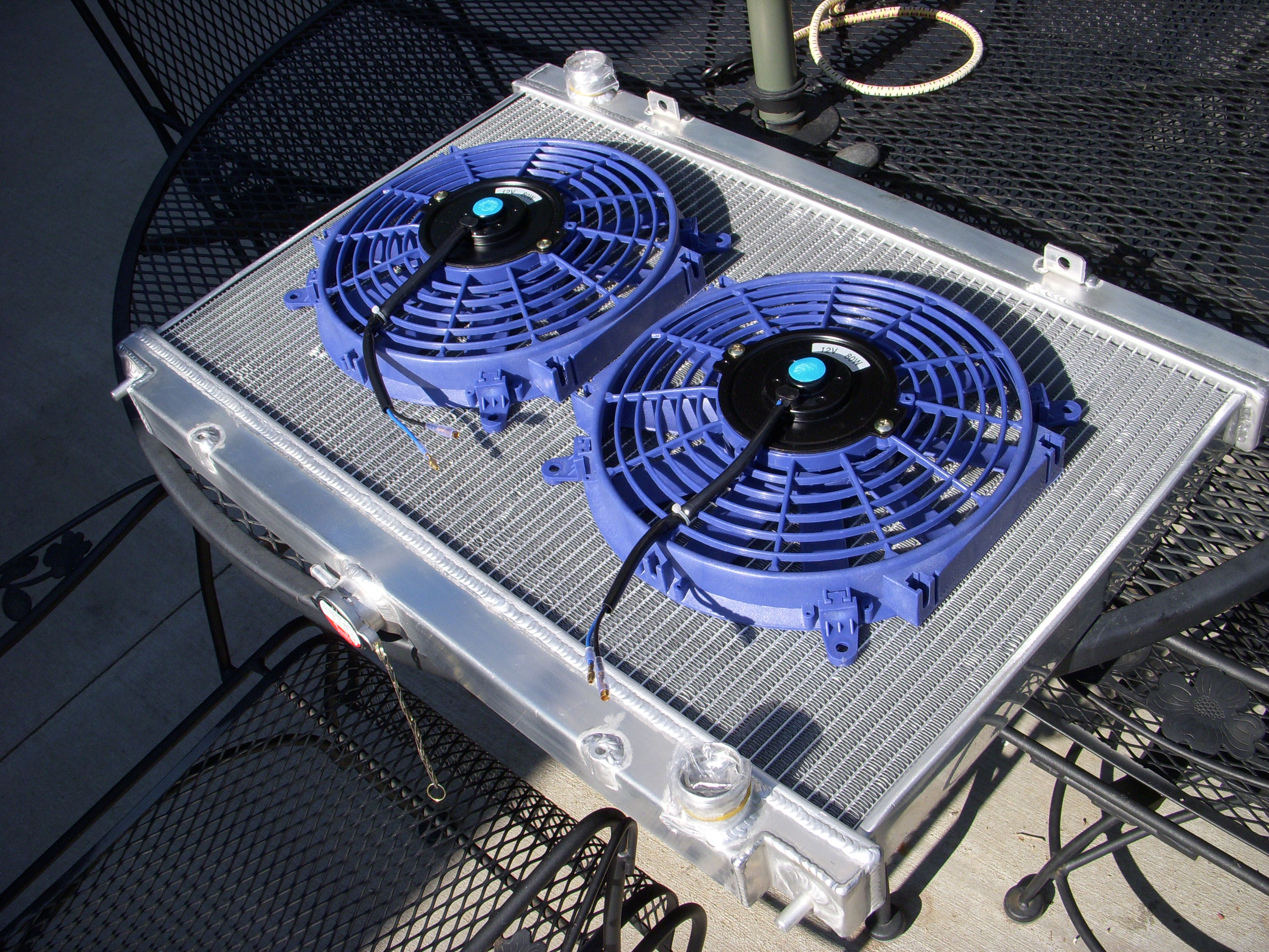

Last night I installed the new eBay radiator in the Shark, and decided to keep the OEM fan assembly because those fans were bigger than the ones I got with the radiator. Once I was done I put in another bottle of Red Line Water Wetter - just because...
The OEM radiator is on the top of the new one. The core is at least twice as thick, plus aluminum tanks on top and bottom. Only thing is I had to connect the automatic tranny directly to the B&M cooler. No big loss here - the tranny now runs 20-30* cooler. The OEM fans fit on the new YOLO ( not KOYO) radiator after I tapped the top two holes with a M5 tap.
It will take some track time to see how the new YOLO handles the heat from nitrous, but I have high hopes.

I though I would look around for info on Quaife diffs first, before welding gears together, and a short Google search turns up a LOT of Quaife diffs for the 95-2001 Maximas. Here's some of them:

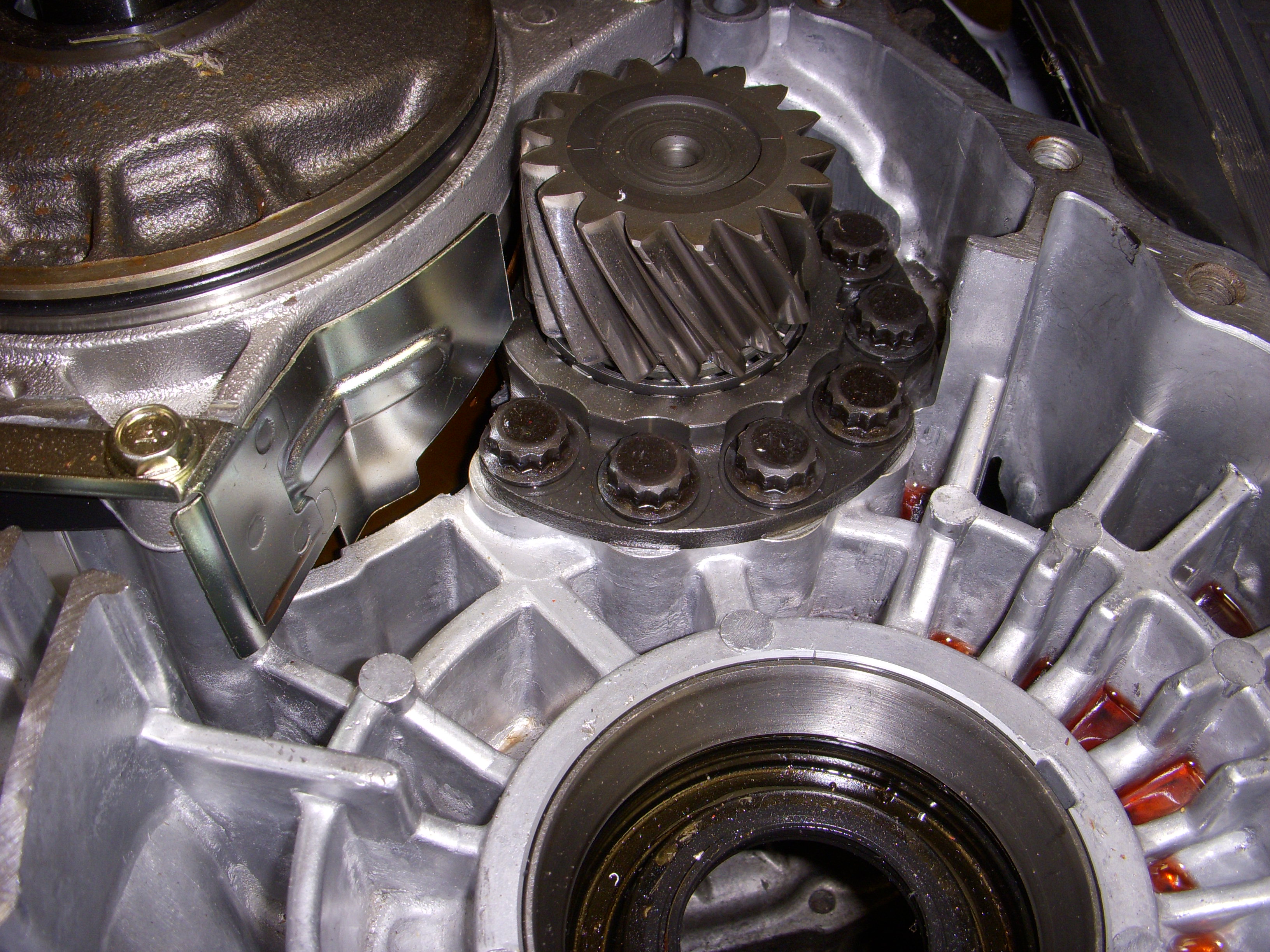

Ring and Pinion for 4AT automatic

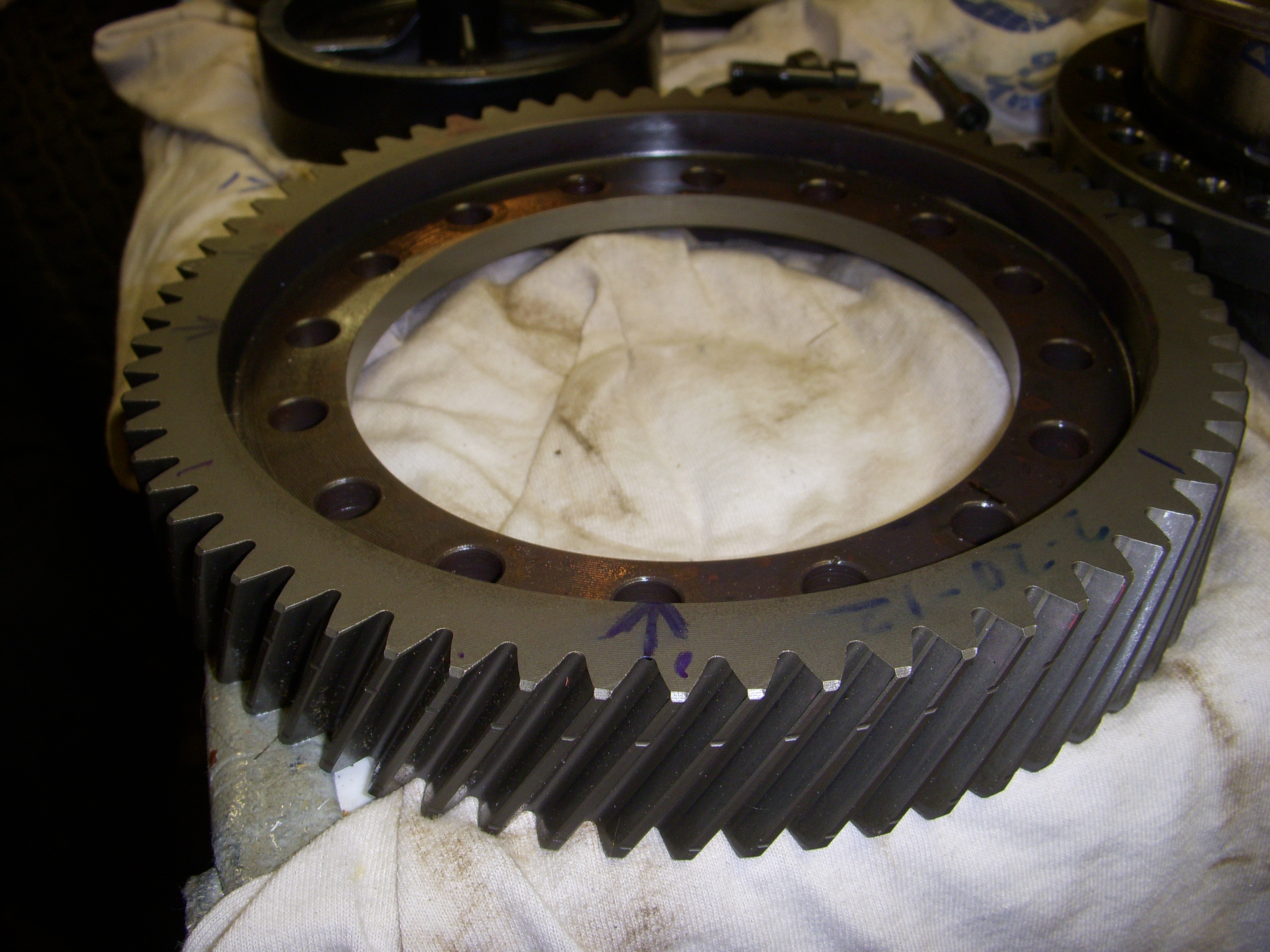

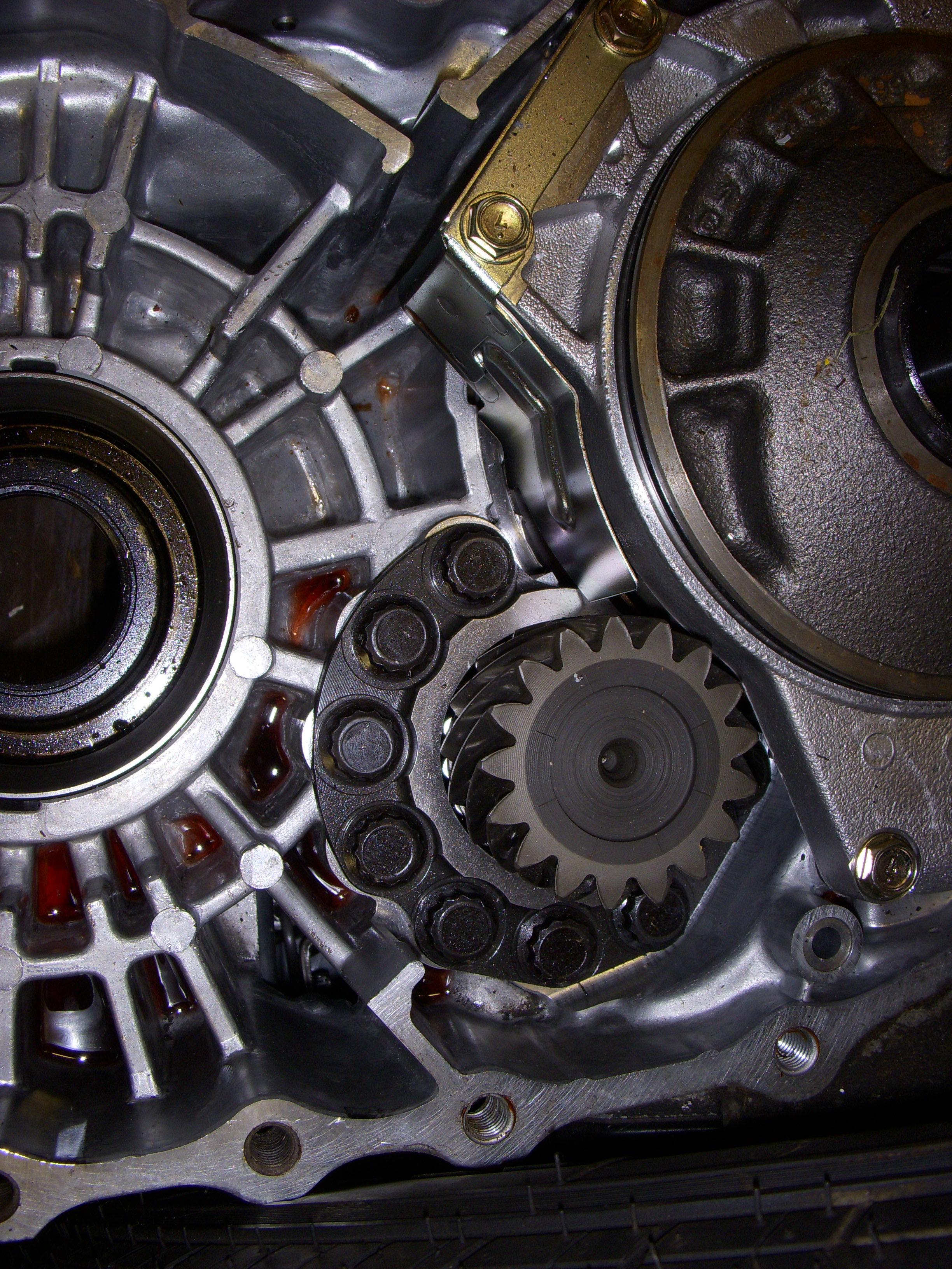

Pix of the ring and pinion gears from the blown 2001 automatic sitting in the garage. There are 17 teeth on the pinion and 60 teeth on the ring gear - that's a 3.53 ratio.
EDIT: went back to Photobucket archive and re-counted the teeth on the ring gear. Oops - there are 66 teeth on the ring and 17 teeth on the pinion, for an effective final drive ratio of 3.882.
Nothing really new here - but I wonder if the pinion gear with shaft can be unbolted and removed from the transmission? I'll try this tomorrow - since I fried the insides of this one a couple of years ago, I don't care what happens. Wouldn't it be great if the gear ratios can be changed by just swapping these two gears? Naw... I'm not that lucky.

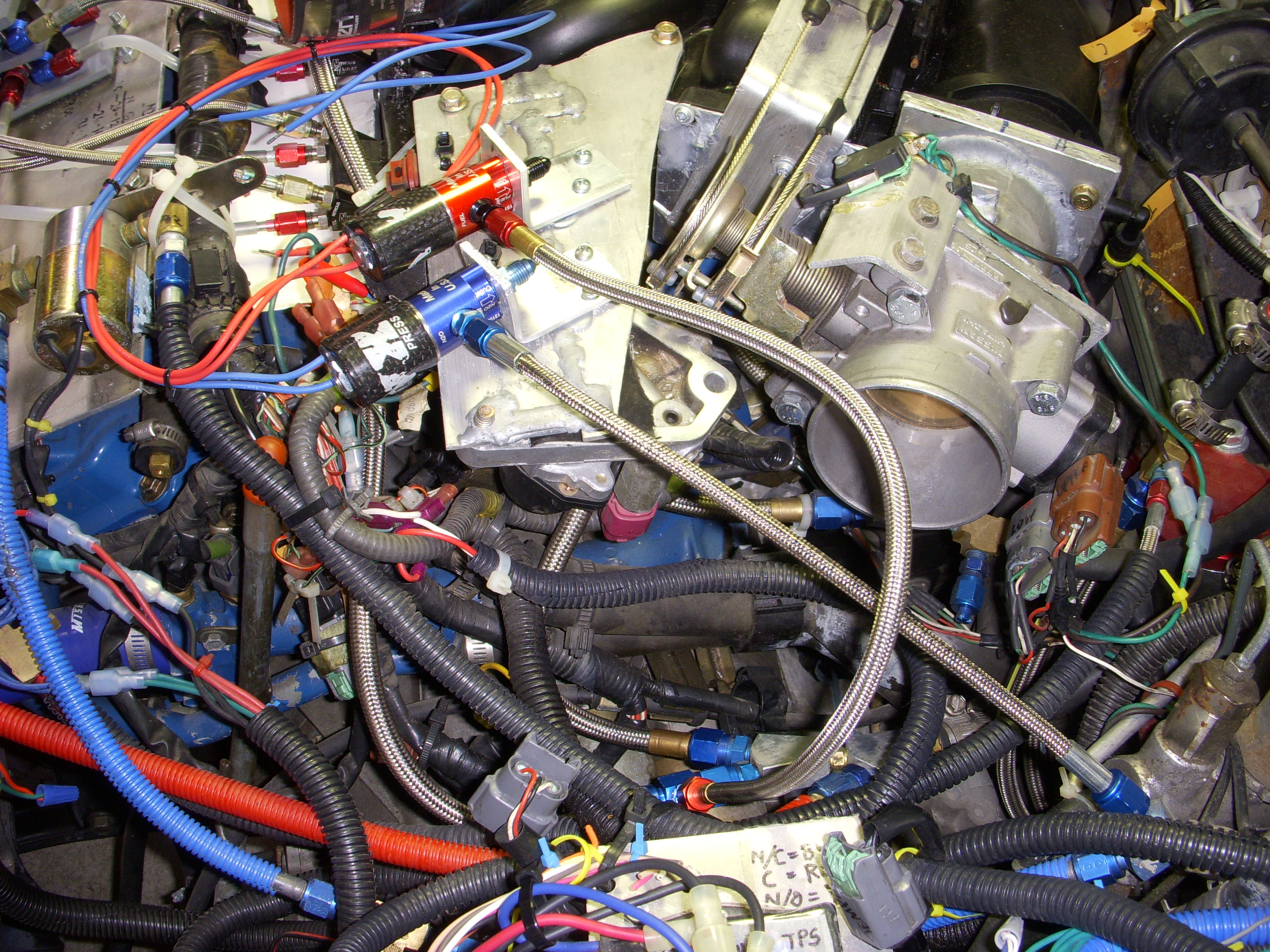

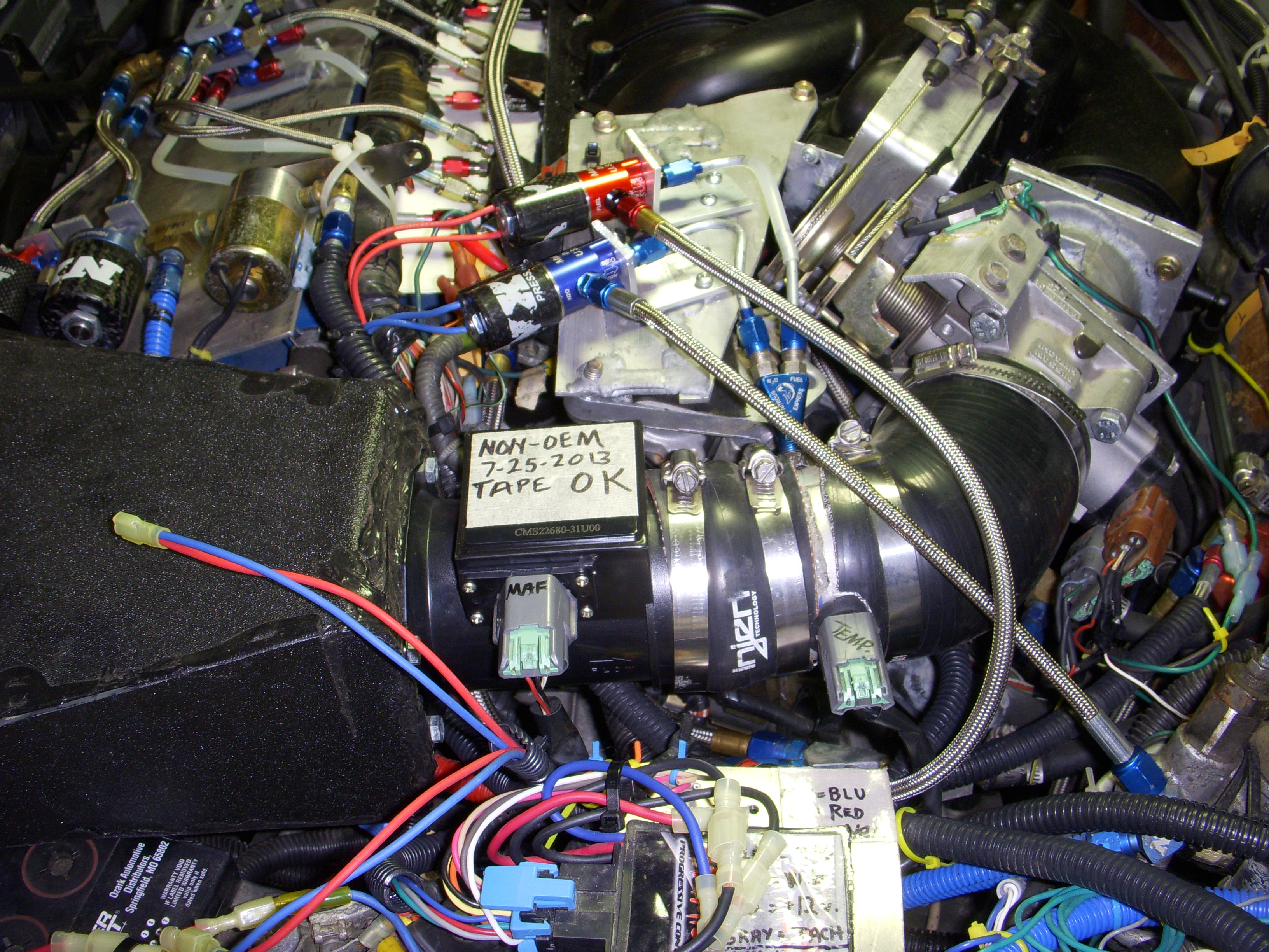

Finished the launch nitrous system

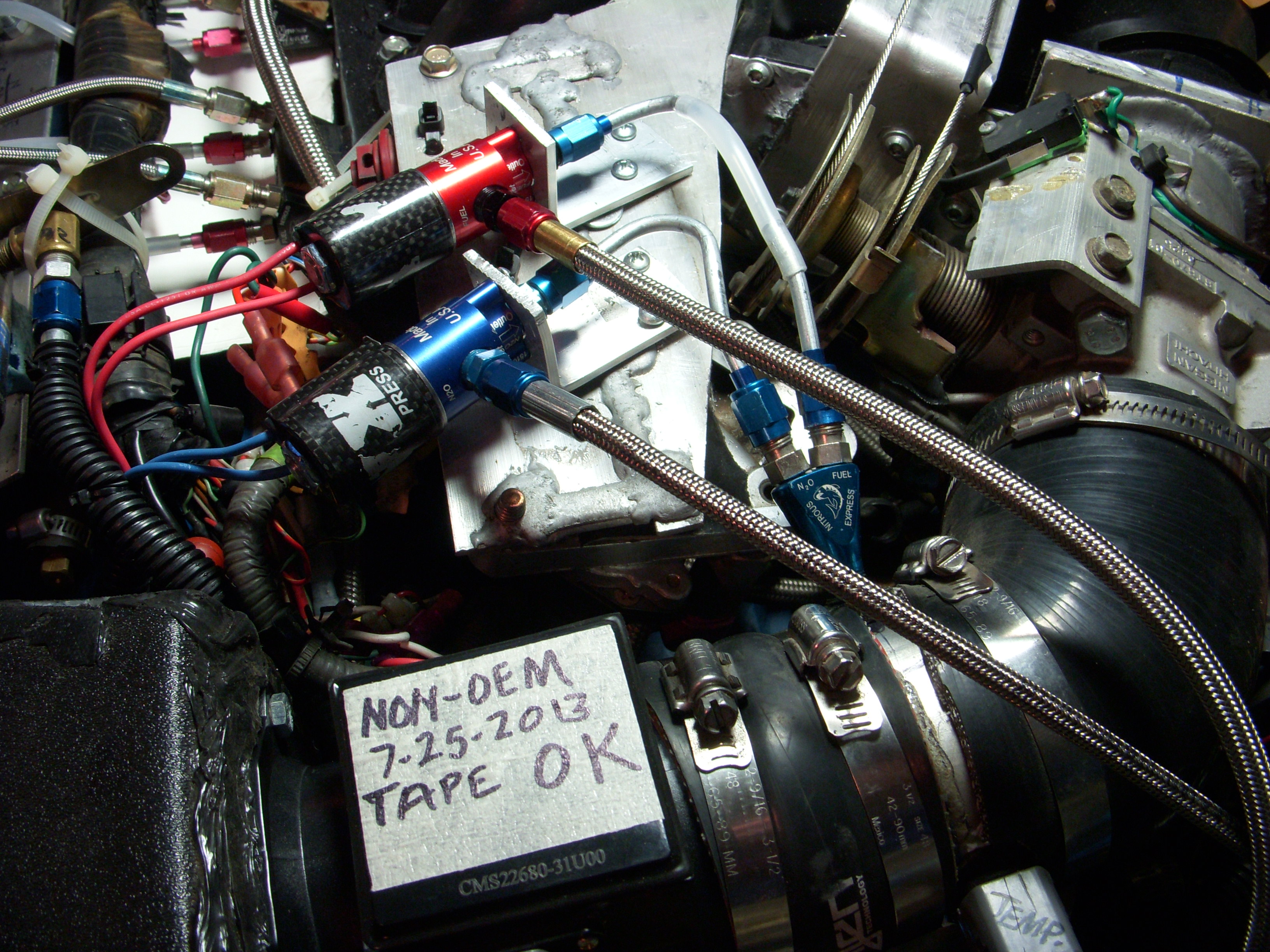

Today I installed the two new fuel and nitrous solenoids (solenoids so cute) so that they are connected to fuel and nitrous and mounted very near the NX Shark nozzle just in front of the TB. I used a 6AN gauge adapter to pull E85 off the front rail feed and the remaining 4AN Y-port off the 6AN nitrous feed pipe from the trunk.
Fuel tap:
pix of the mounted solenoids - some pipe bending gonna be done here.

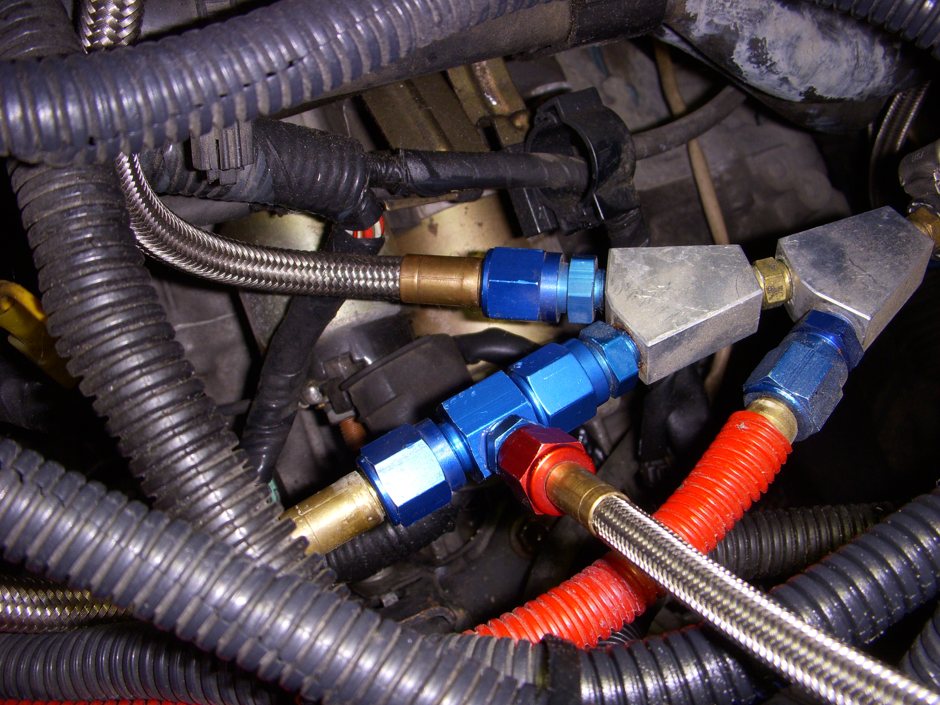

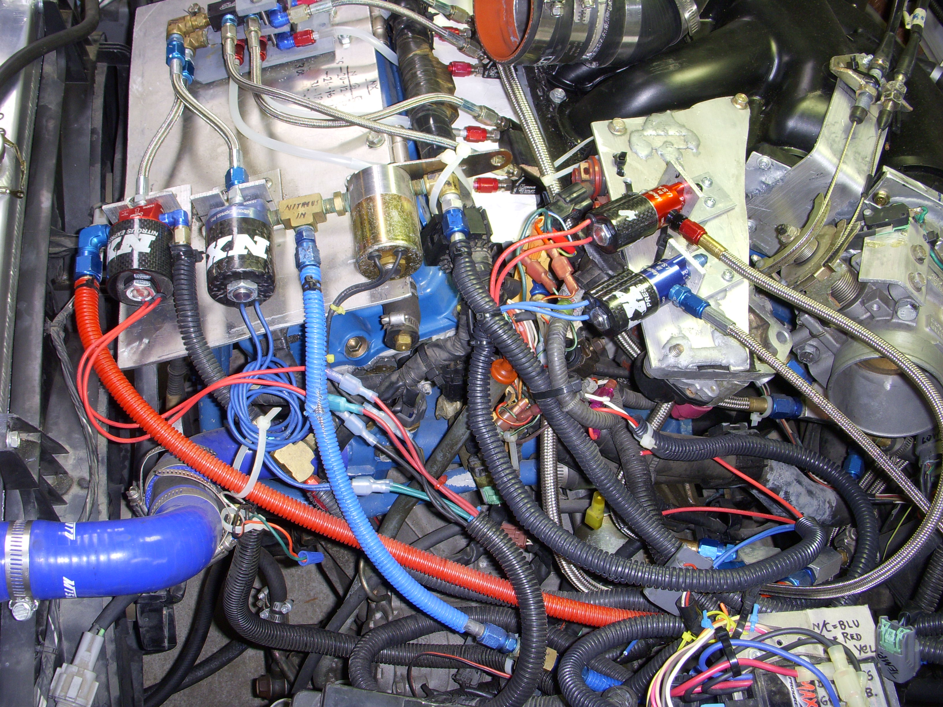

Just when I think I can't get anything else under the hood, I go and put something else under the hood.
Hmmm.. looks like I need another pix for the completed job. OK - i found it: Notice the tape-tuned custom MAF. I like these. Snappy...
And BACON - no engine work is complete without BACON !! And some stuff from the garden.. OK, my wife's garden - I'm not allowed close to the vegetables.

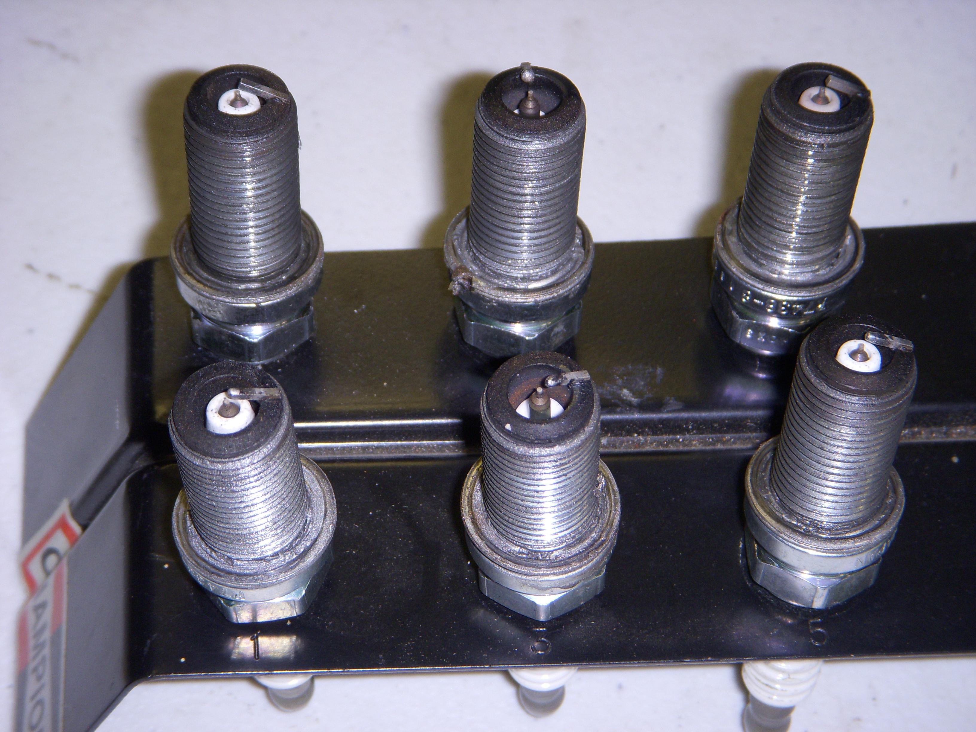

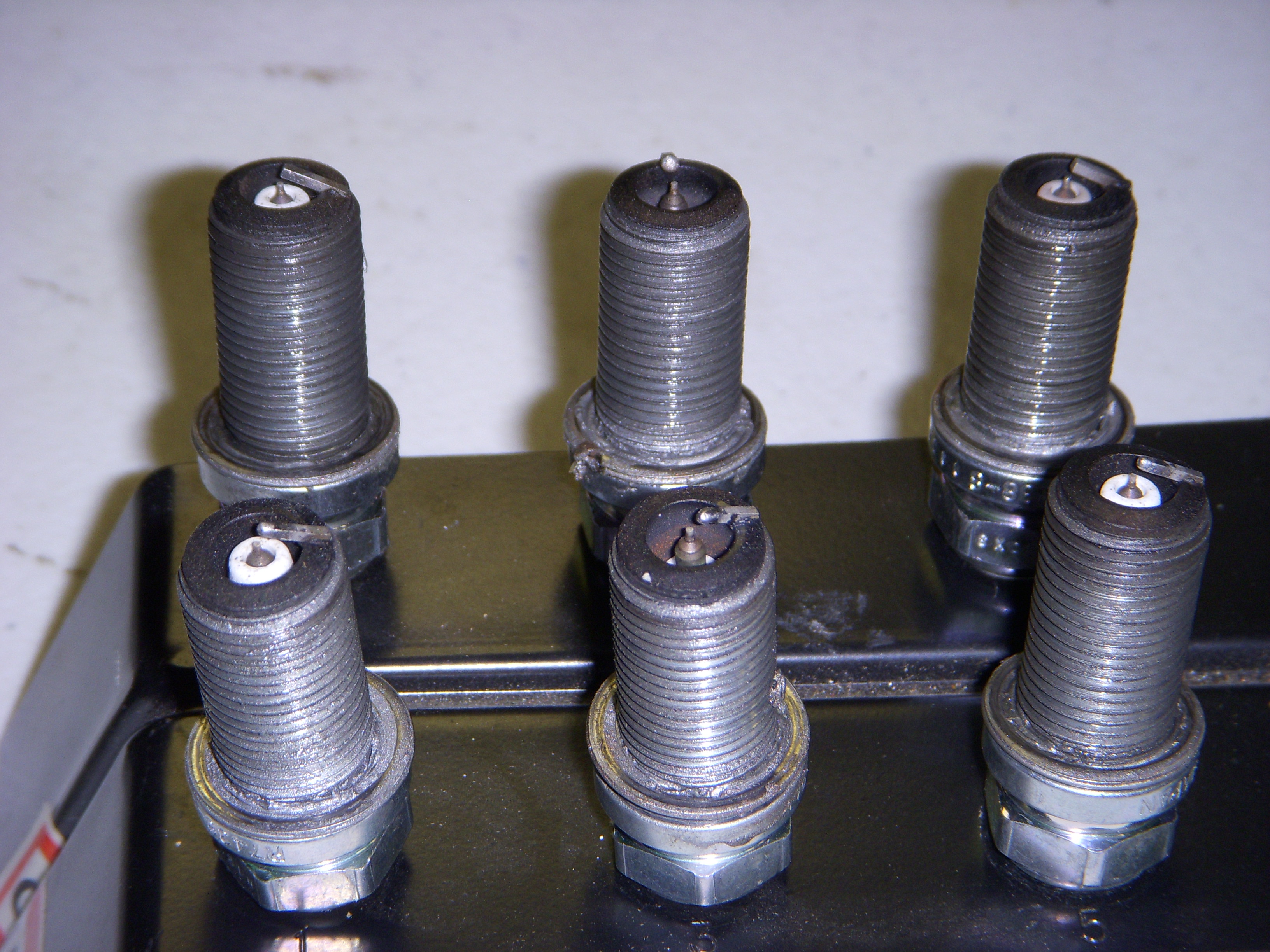

I made three passes, two to figure out the launch with a 75-shot and one to try the direct-port system. I missed the launch timing badly on the first try and puttered through with a 13.3, I think. (slips are still in the car). The second pass was better - nailed the launch and immediately both tires broke loose and I drifted to the left on the greasy track, got out of it and back in for a 14-sec ET. Sigh. Went back to the pits and enabled the direct-port stage then went back for another try - in the other lane.

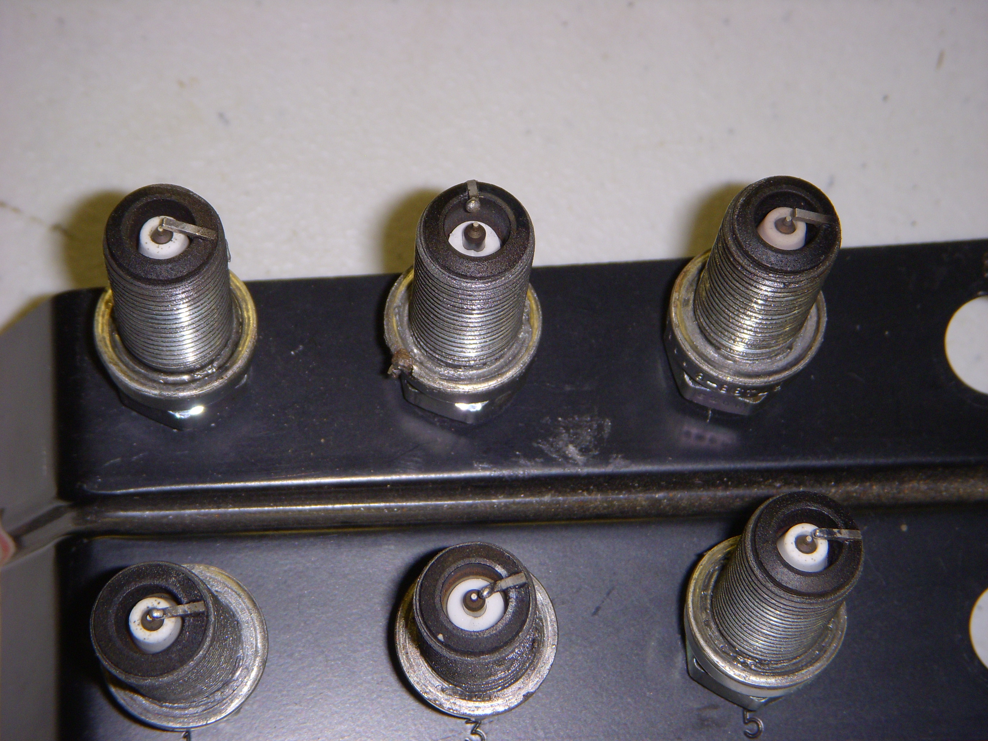

Launched OK and engaged direct-port in second gear, pulled hard, then lost power when going into third gear, so I let up and coasted thru the traps. ET was still a 13.0xxx. I parked the car after that one. Sigh..
The engine seemed fine when I unloaded the car on Saturday, but I had other things to do. Sunday I drove it around for a few miles and everything seemed OK, so I waited until 9:30AM, and after weighing the bottles (used 4.1lb nitrous Friday) and warming them I went out on on-ramp patrol. I was able to get two runs in 2nd and 3rd gears WOT on direct-port, and Lambda stayed around 0.80-.83, which is fine, but I felt high-RPM ignition misfire in both gears, so we went back home. There was no sign of what caused the direct-port system to cut off in 3rd gear, but I'll check programming on the Max3 controller.
I checked the codes and there was the codes for Cyl 6 misfire and general misfire showing up in the reader. I ordered 6 more NGK R7438-8 plugs which should be here on Thursday, so Friday or Saturday I'll take off the top of the engine to get to all the plugs. I had gapped to .035 so I'll lower that to .030 and install the new plugs and go out to play yet again. It's possible that I have a damaged plug, too wide gap, or coil voltage needs to be raised from 16 volts to 18 volts.

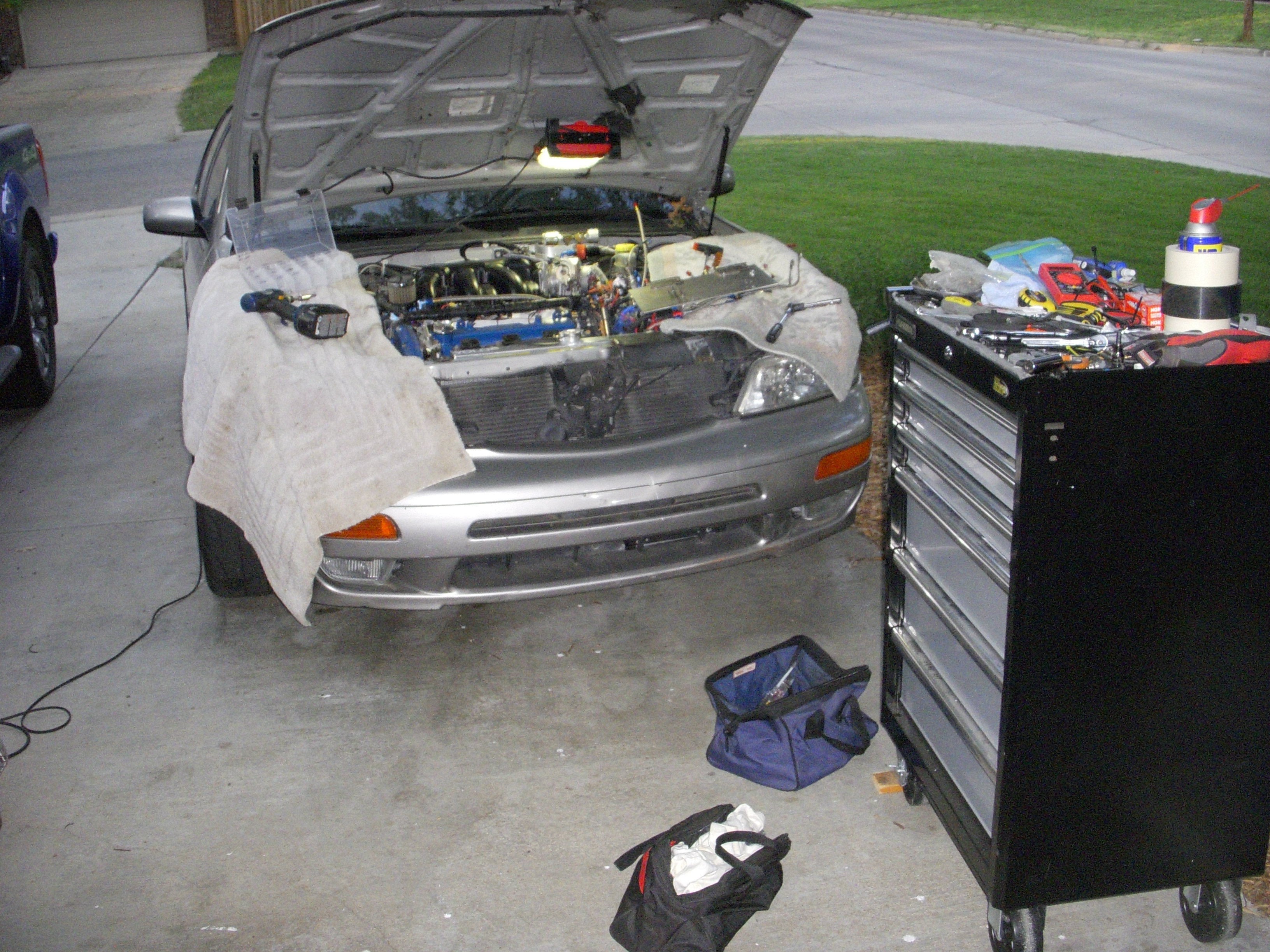

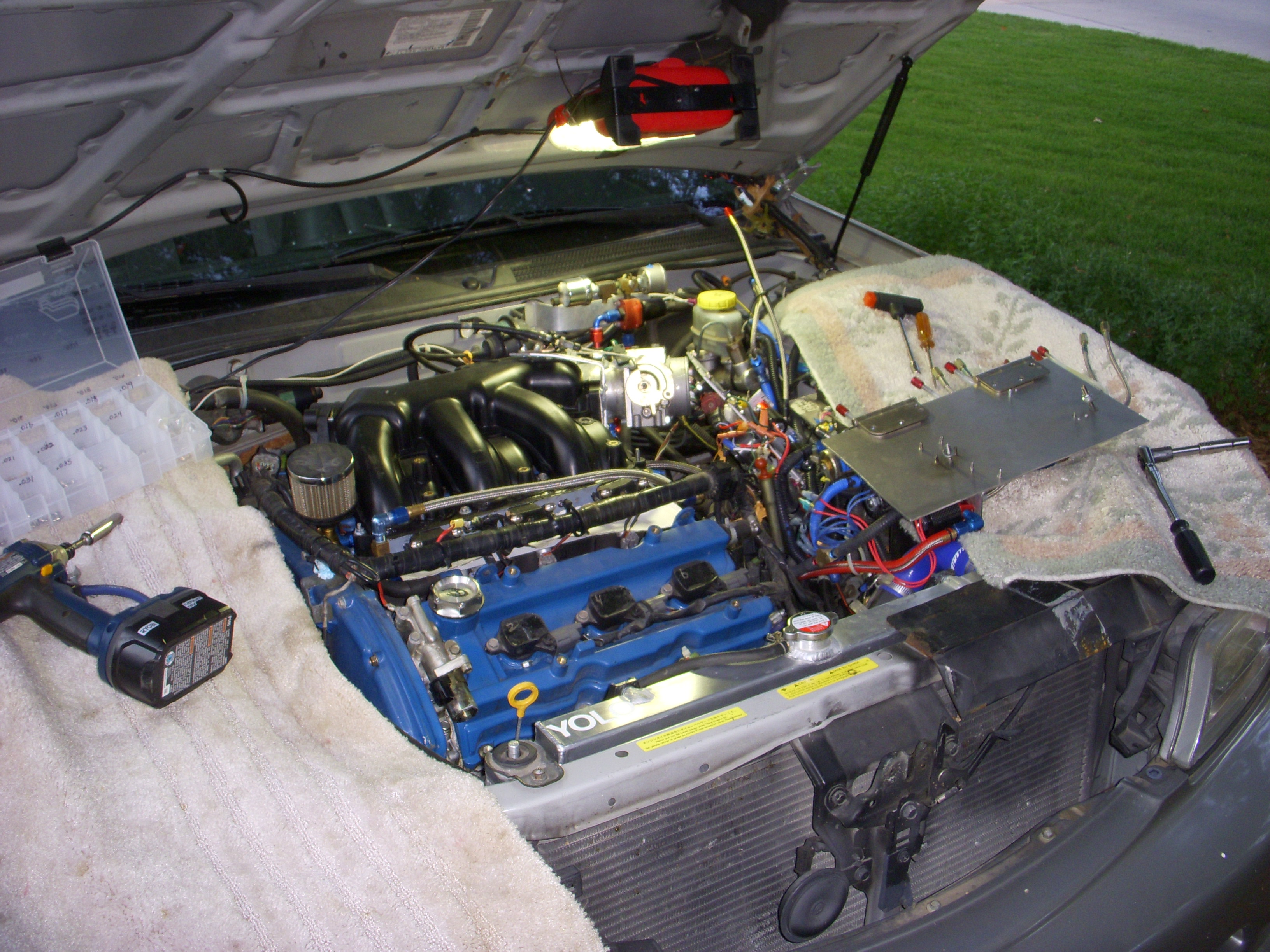

Changed spark plugs tonight - kinda grim...
I pulled down the top of the engine tonight to get to all the plugs, and replaced each with the same plug only gapped to .030" - because I could. The plugs looken grim, with detonation on the center cylinders and some ground electrode melting on others.
I have photos of what they look like.They're sitting in a spark plug holder rack, and cylinders are numbered 1-3-5 in the front row and 2-4-6 in the rear row. Maybe you can see missing insulator porcelain on the center plugs. Last run at the track was with a 75-shot for launch and then the 75-shot plus the 150-shot direct-port stage. This was a combined nitrous shot of 225-shot, which shouldn't be a problem. Apparently it is...
Under the hood... with nitrous plate removed. It takes about 1 1/2 hours to change plugs.
