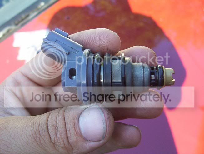

Would a 370cc injector from a blacktop sr20det work?
http://www.northwestnissans.com/boar...ighlight=370cc
Old Aug 17, 2005 | 10:55 AM
slimer's Avatar
A couple of Blaxxx's? Lawls.
Joined: May 2002
Posts: 5,529
yes, those will work.

When dealing with used injectors, should they be flow tested before purchasing?
Old Aug 17, 2005 | 12:23 PM
slimer's Avatar
Joined: May 2002
Posts: 5,529
you should because they ultrasonically clean them too, sometimes they flow test to more than what they were originally rated at. I used to use witchhunter, he puts new pintle caps and o-rings on them, but he sends them dry, which isn't good for the injectors. I would pm superdave2 because I think that he now has an ASNU machine (what they clean and flow test them with.) He sends the injectors wet.
