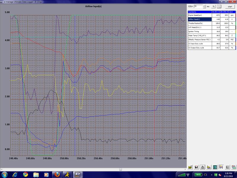

So the shifting thing I finally logged the weird shifting thing:
http://i17.photobucket.com/albums/b7...funnyshift.png
Don't look at the attachment, it is too small. I assuming the tires are spinning but I'm not noticing?

updated with weird shift log

you say it happens in boost and not in boost, doesn't sound like spark blowout to me. i never experienced spark blowout when not boosting.
with regard to the lag after shifting:
where is your maf at? not just before/after turbo but how much distance between it, your turbo, and your throttle body? and where is your boost sensor located and where is it getting it's reference?

B) RMT setup, I have an Injen midpipe so the maf is is there. So there is a big distance from the maf and the turbo. The greddy boost sensor reads from the vac tube on the 00vi, it is those metal tubes(ones for pvc and the other is a vac source)

Is the lag after a shift something like in this video? I think it has to do with the difference in the amount of air that is actually entering the engine (passing through the throttle plate) and the amount of air that your ECU and emanage THINK is entering the engine at that time, given that they are metering air from a different spot (combination of your MAF sensor and the adjustments the MAP sensor are making). There is a little bit of a lag between when the rush of pressurized air from your turbo flows past your maf and MAP, and when it actually starts entering the cylinders and creating the cylinder pressures that your ECU is expecting. In that little bit of time difference, the ECU is pulling timing because it thinks more air is in the cylinders than there really is, it adds more fuel because of the same reason, etc. The result is a bit of time when your car is under-timed and overfueled, until that mass of air your turbo is flowing actually starts entering the engine.
All that being said, it was fairly rare for my car to stumble like that, but it happened on occasion. Of all the videos I have of my car, that vid is the only one in which it has that hesitation. I remember it happening only once in a while. Perhaps there is more that is going on when our cars do that. Does your car do it all the time?

Yeah, is that your 3-4 shift? It is pretty similar to that. Hesitates/Stumbles and then picks up and goes

yes but I edited my post, mine did this pretty rarely. of all the vids I have of the car going through the gears, this is the only one in which that hesitation shows up, and it wasn't so common that I thought of it as a "problem" that I needed to "figure out". Only occurred once in a while.
yea, it didn't used to do it. It doesn't last long as you can see in the eu log so prob not that big of a deal.

So do you think if he either moved the boost source closer to the maf or put the maf right on the tb it would help
