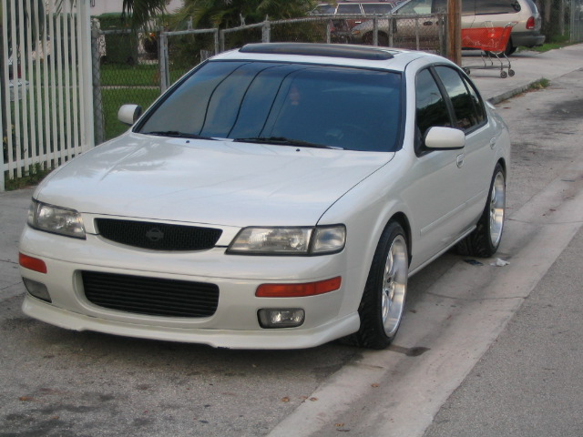

keeping the fogs is simple with 2.5 pipes, theres a triangular section on the frame on each side of the radiator which has enough room to drill out a 2.5 inch hole.you can then weld 2.5 inc mild steel sections to incorporate the section of pipe to the frame and use couplers on both sides, or just run the 2.5 piping through it if you want to stick to aluminum. one side comes up right near the lower rad hose, the other on the other side pretty clear of everything. you can fit a huge cooler and still keep the fogs.
Such a nice front end!!!!! And I hate the 95-96 bumper.
I like how the intercooler just looks like a grille.
Looks so perfect and mean. Cant wait to see what this puts out boosted man.
