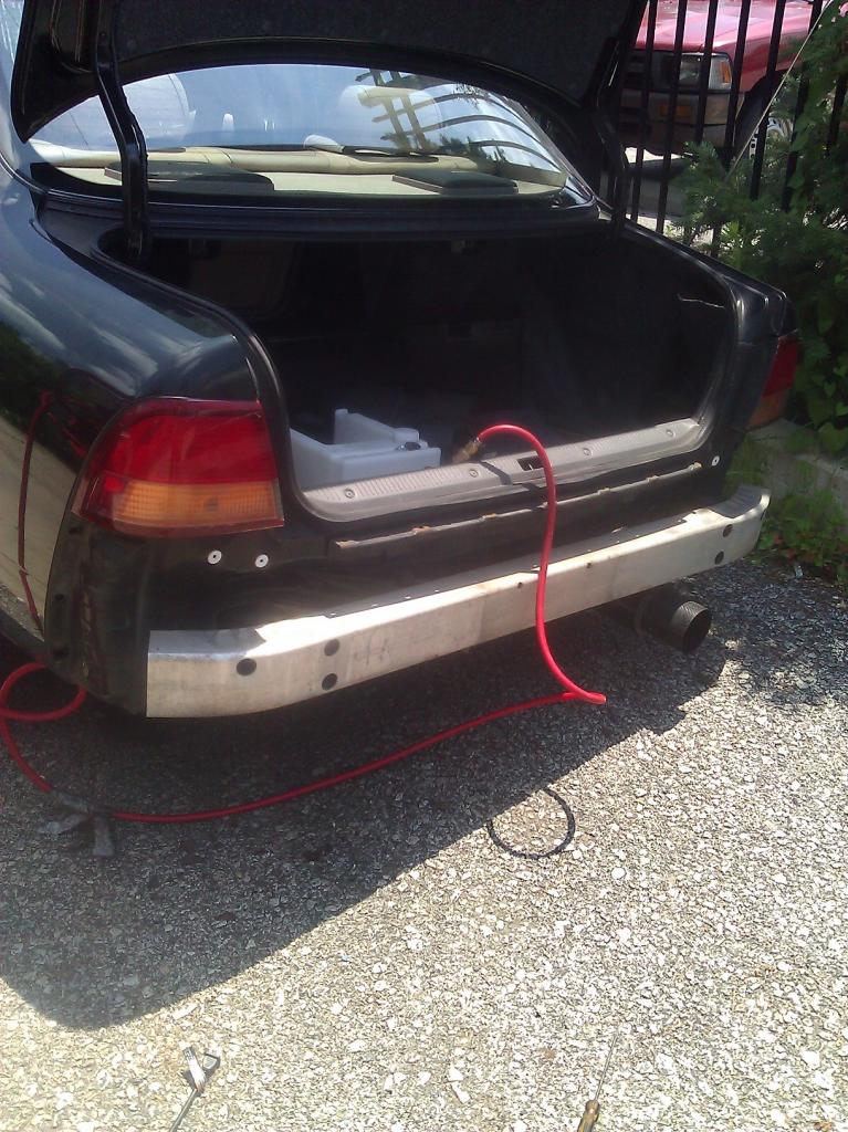

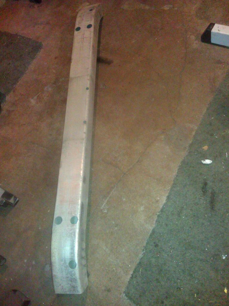

scored a 95 rear bumper support which is about 20lbs lighter than my 97 steel support so I installed that since the car is down right now

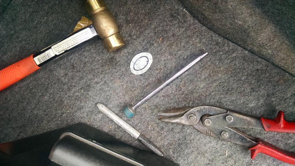

so my antenna stopped working awhile ago, I got bored ordered a stubby one, didn't like it and here are the results
made a template hammer to the curve of the body

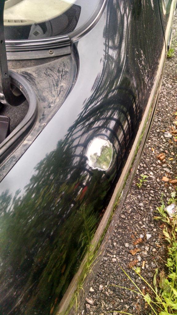

all welded in and sanded back down, time for some body filler and primer

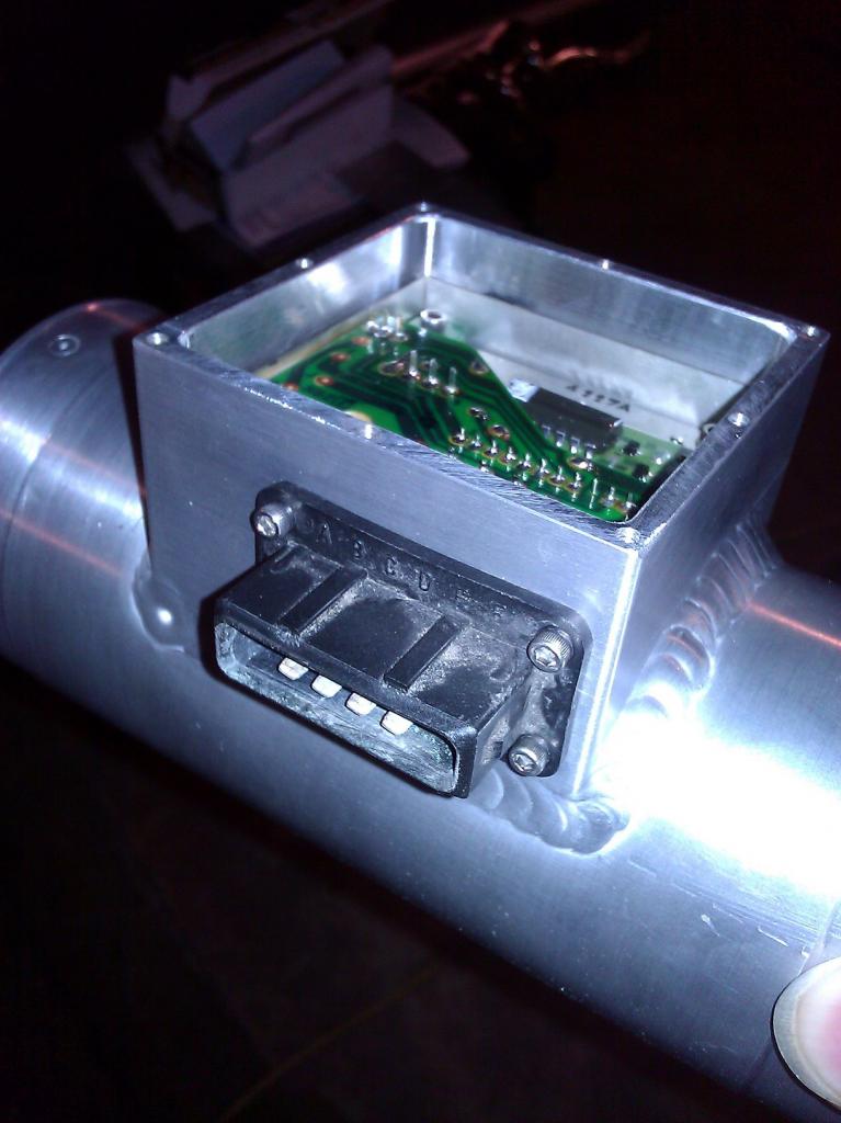

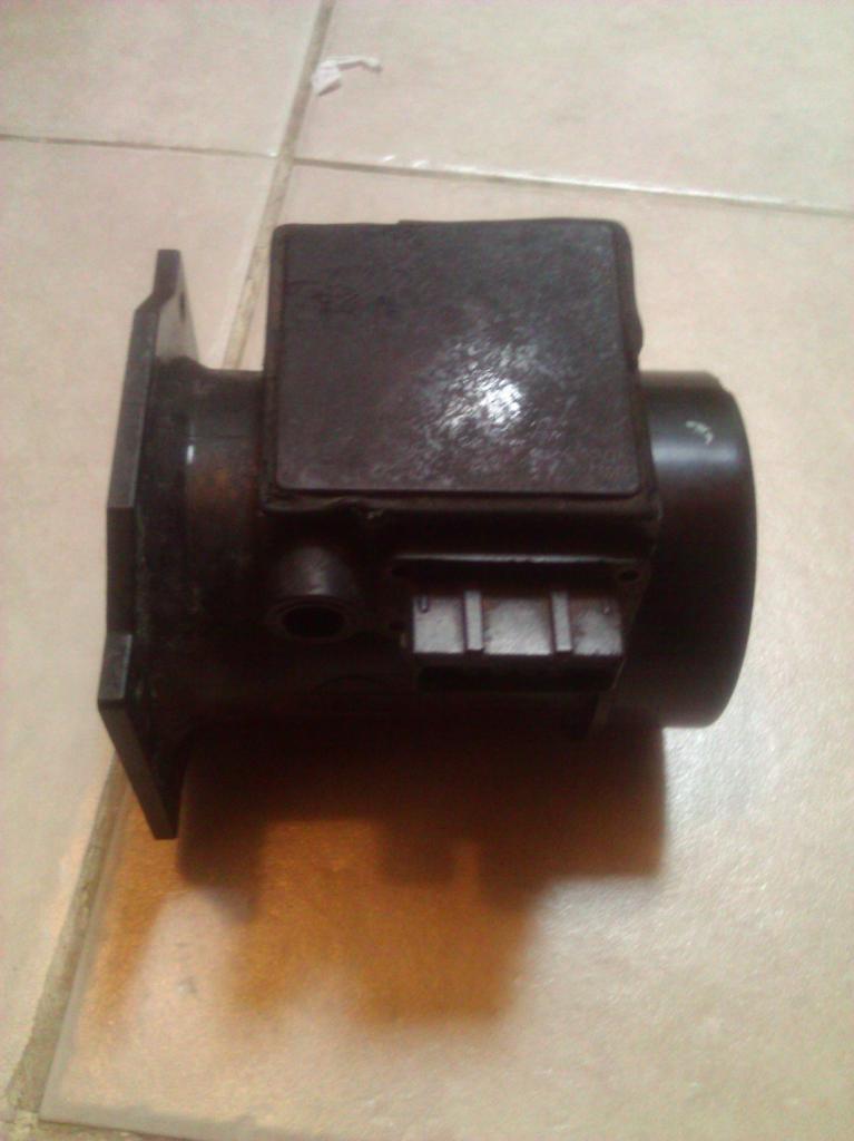

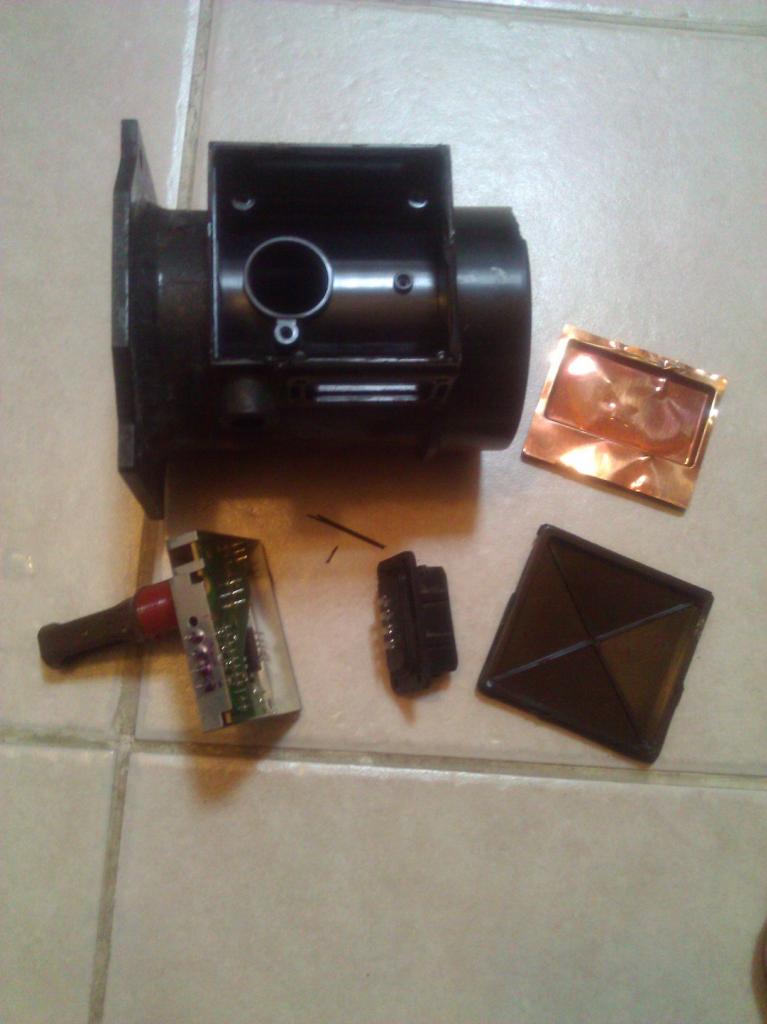

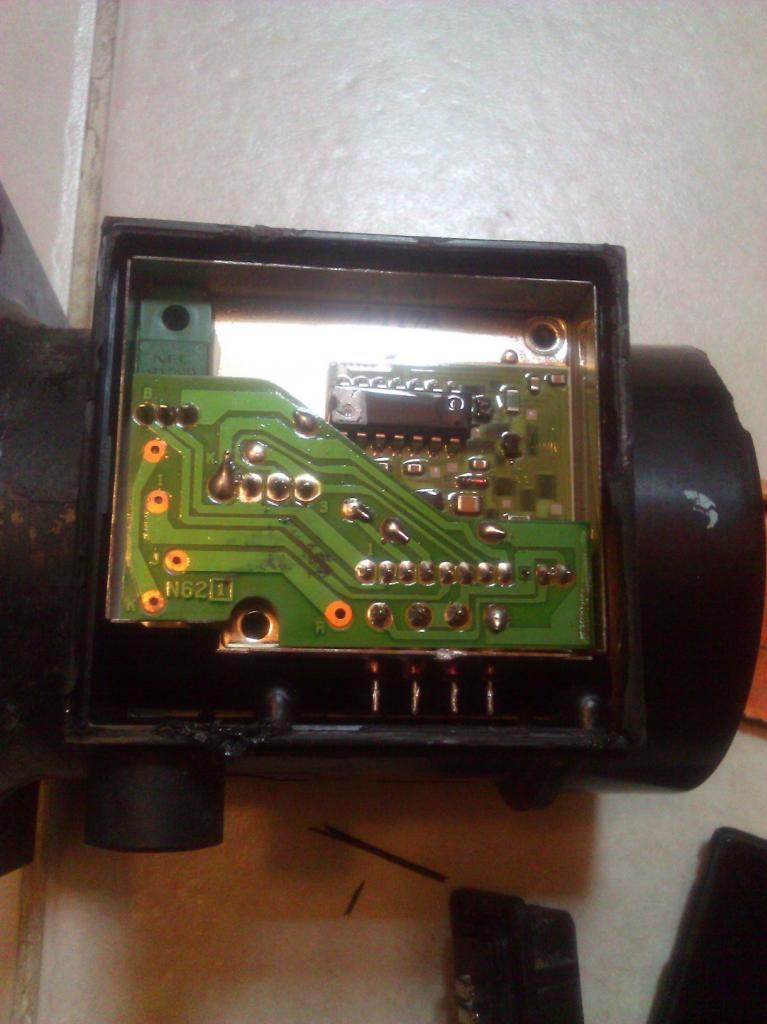

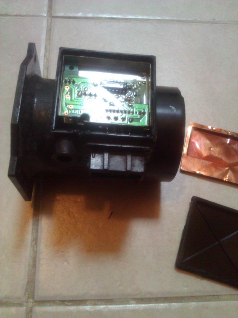

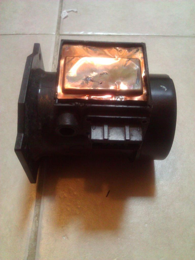

ok so a common issue when boosting a 4gen is the maf blows apart so to fix that I ordered a new maf housing. I took some pics for anyone that has always wondered have the inside of a maf looked like

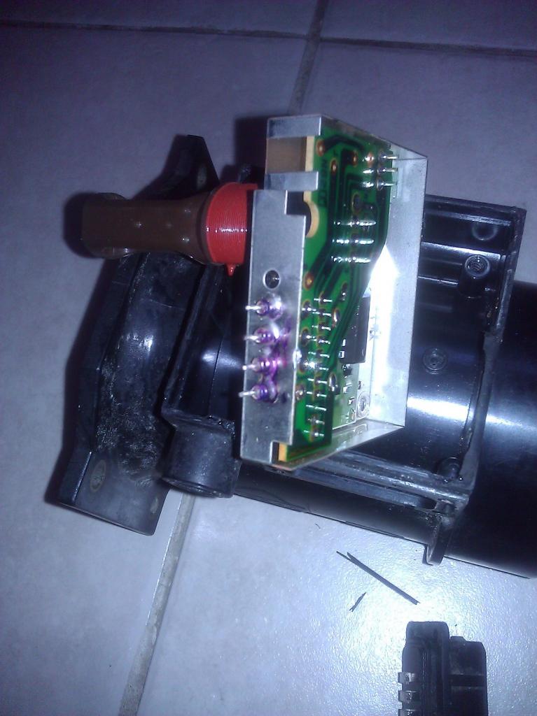

Old Sep 6, 2014 | 05:14 AM
  #298
t6378tp's Avatar
Turbo 3.5
iTrader: (69)
Joined: Dec 2005
Posts: 7,785
From: Philly

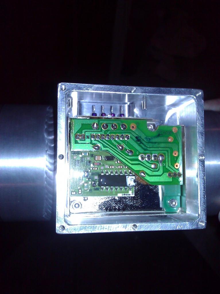

btw this is a z32 maf
Old Sep 6, 2014 | 05:22 AM
  #299
t6378tp's Avatar
Turbo 3.5
iTrader: (69)
Joined: Dec 2005
Posts: 7,785
From: Philly

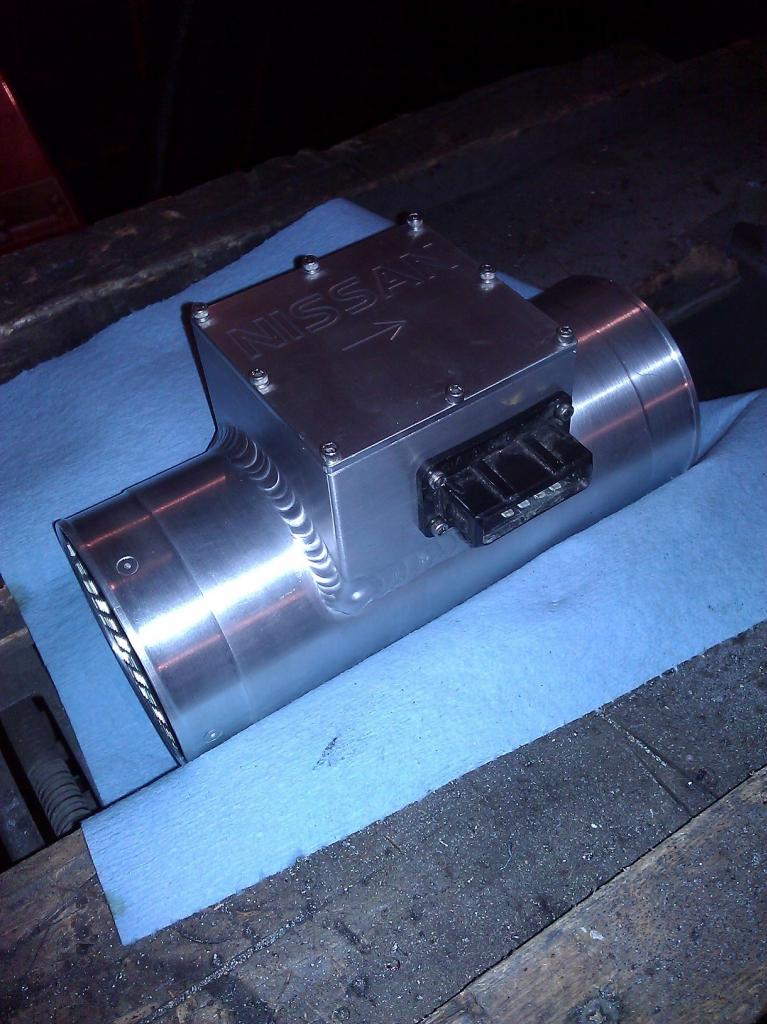

Old Sep 6, 2014 | 05:25 AM
  #300
t6378tp's Avatar
Turbo 3.5
iTrader: (69)
Joined: Dec 2005
Posts: 7,785
From: Philly

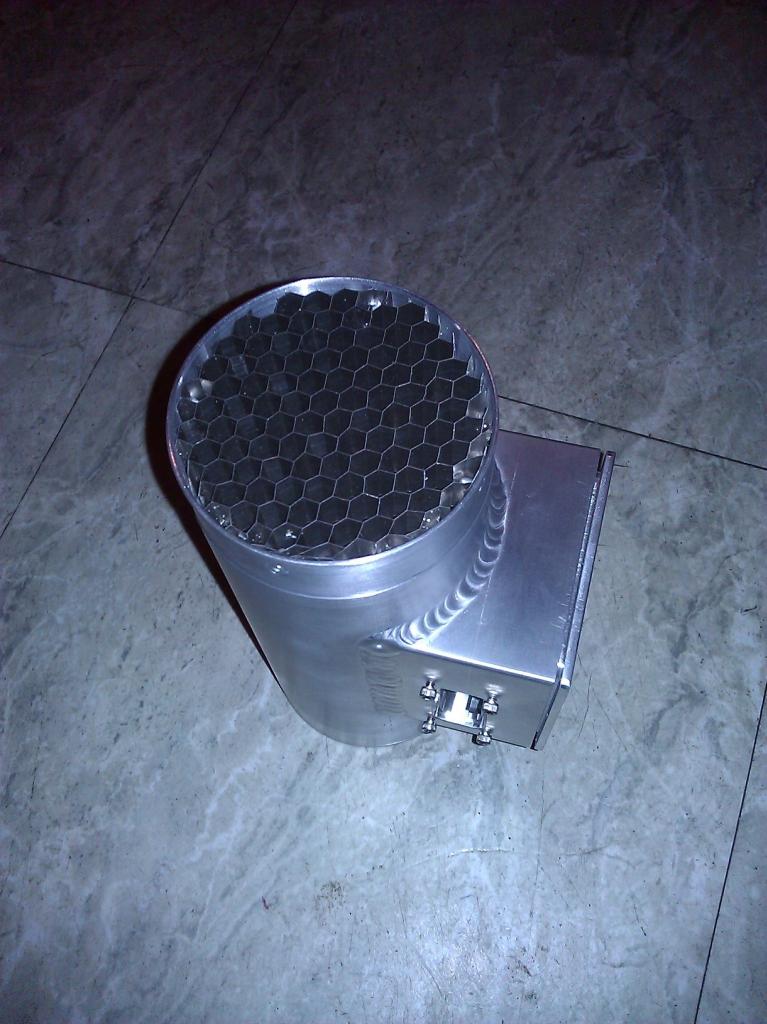

Link to where this can be found?

Did you add the honeycomb or did it come with it?

it came with the honeycomb
http://www.ebay.com/itm/3-0-OD-76mm-...960a2b&vxp=mtr

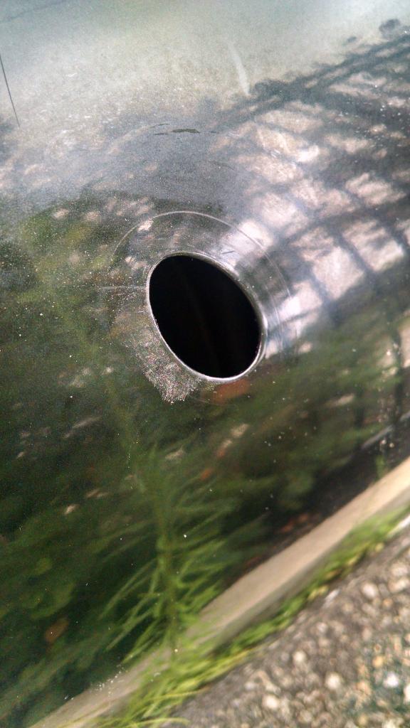

so my power antenna doesn't go all the way down and I hated the stubby so I deleted it
made a patch panel to fill the hole and welded it in and grind it back down

all done just need alittle bondo and paint

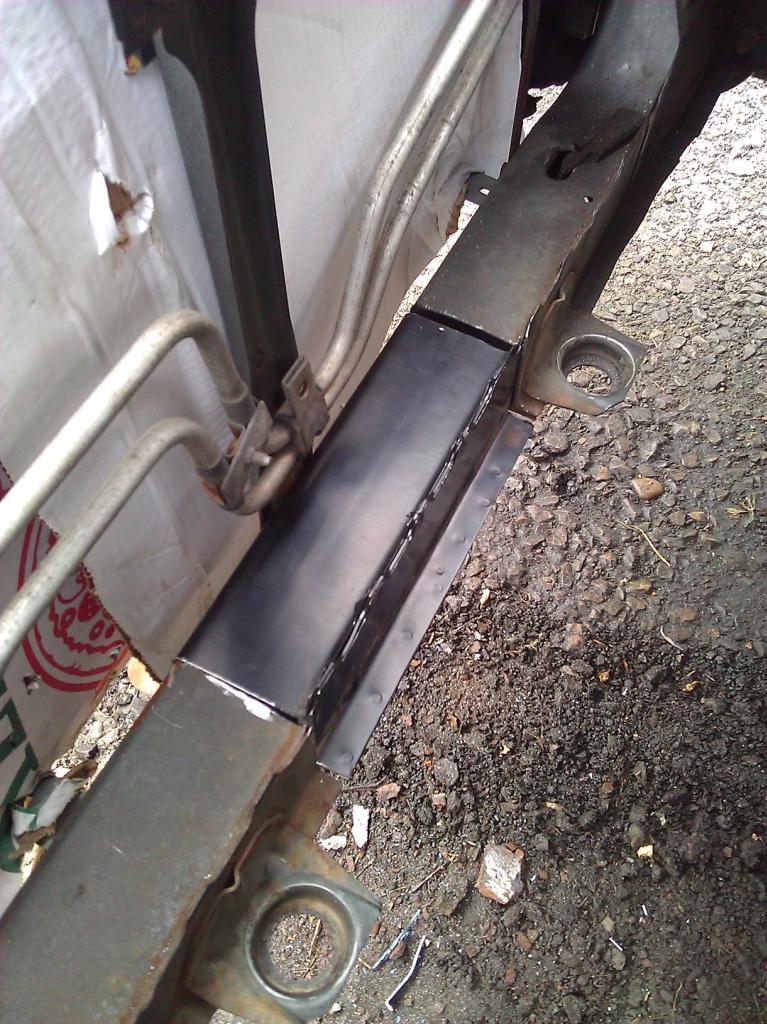

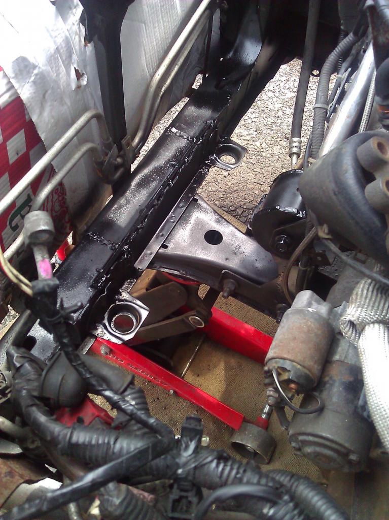

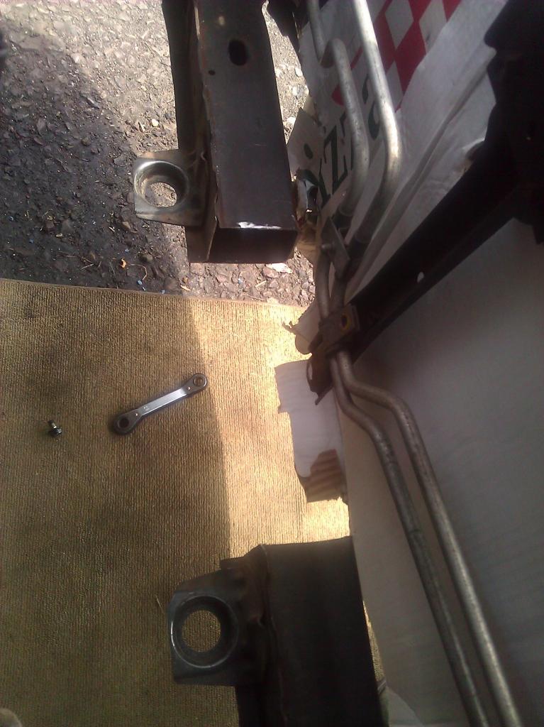

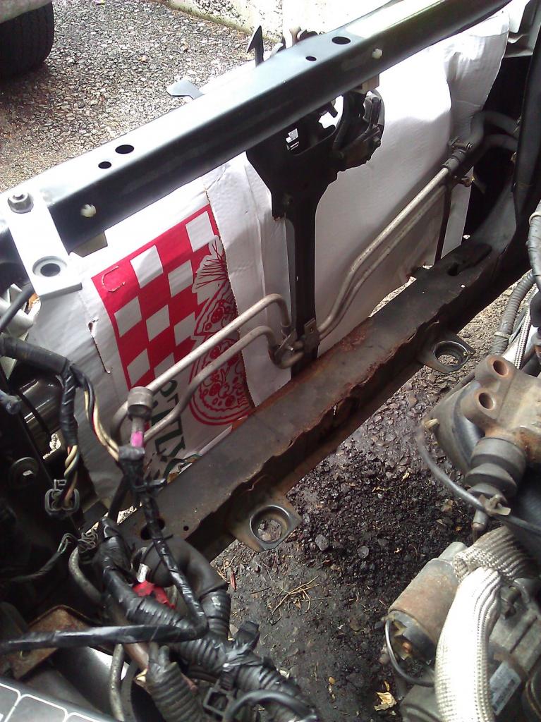

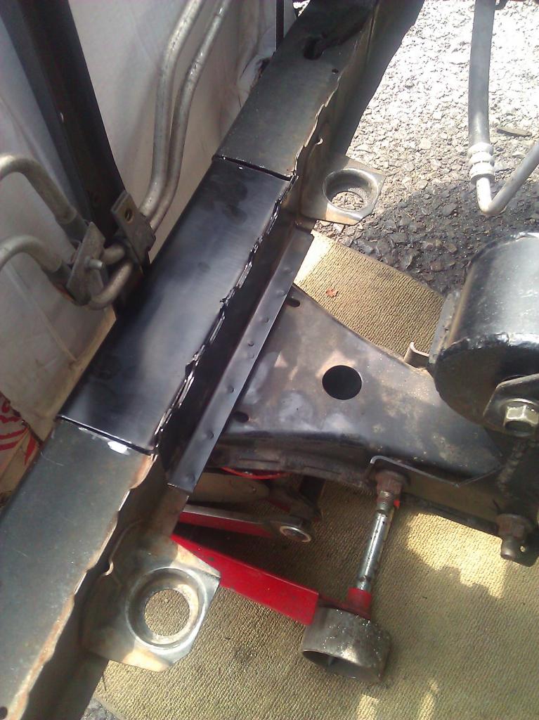

ok so the bolts inside the rad support tore off so I bought a replacement rad support from a local org member for a 5.5gen cut off the center section and replaced it
Old Oct 19, 2014 | 05:02 AM

From: Philly

bolted it all up before welding to make sure everything lined up

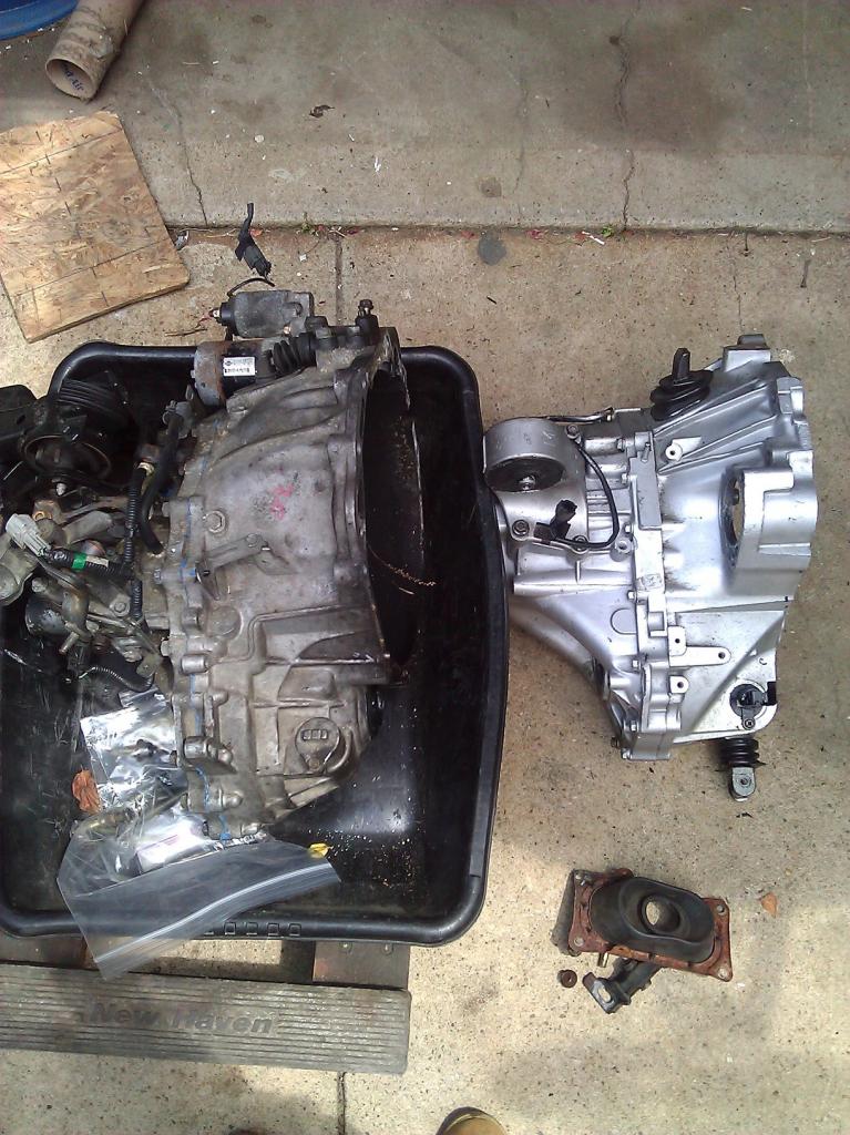

so I got a great deal on a full 6spd swap, Mmmmm turbo 6spd 4gen sounds good to me

got everything just waiting on modding flywheel and clutch

6spd trans vs the 5spd

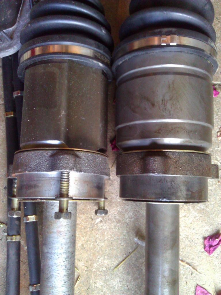

5spd passenger side axle vs 6spd axle
