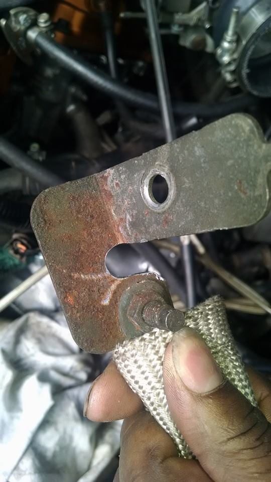

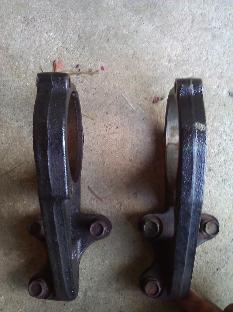

6spd axle bracket vs 5spd axle bracket

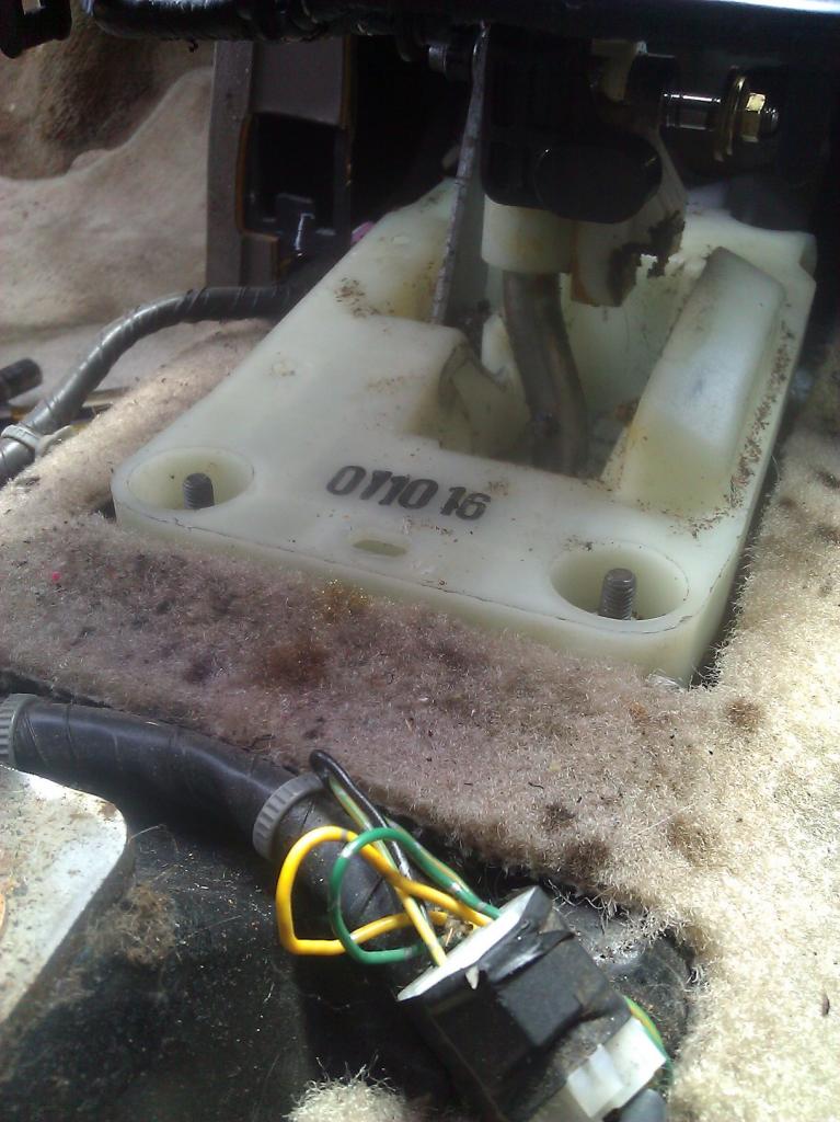

when removing the 5spd shifter and linkage which had a boot to protect it the 6spd shifter is left exposed. in the pic you can see the exhaust is right below it. I was to just leave it which was a big hellz no

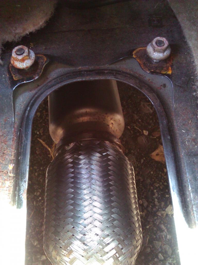

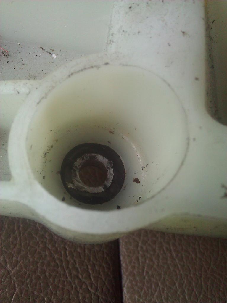

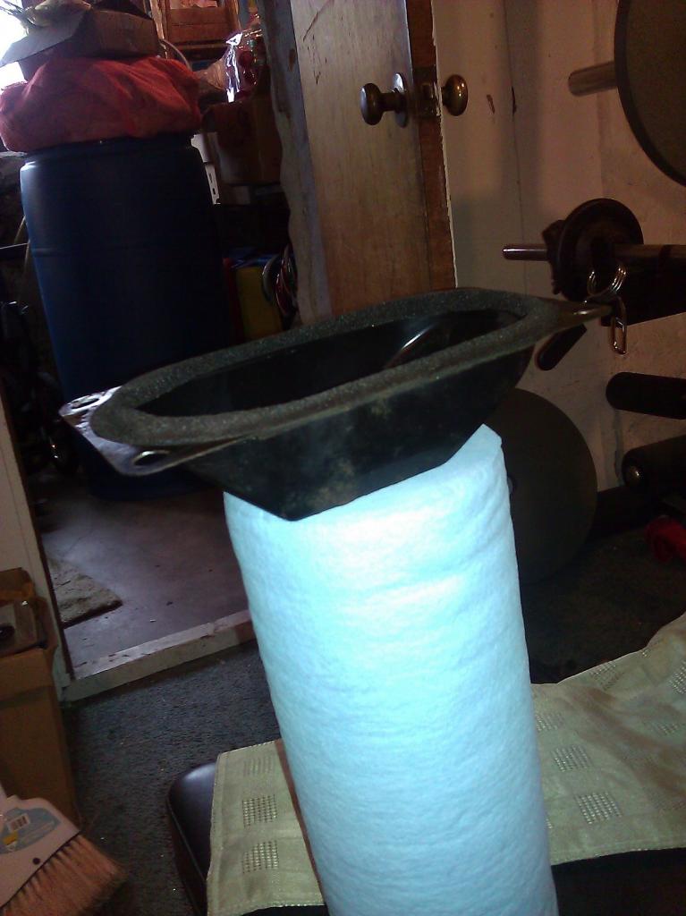

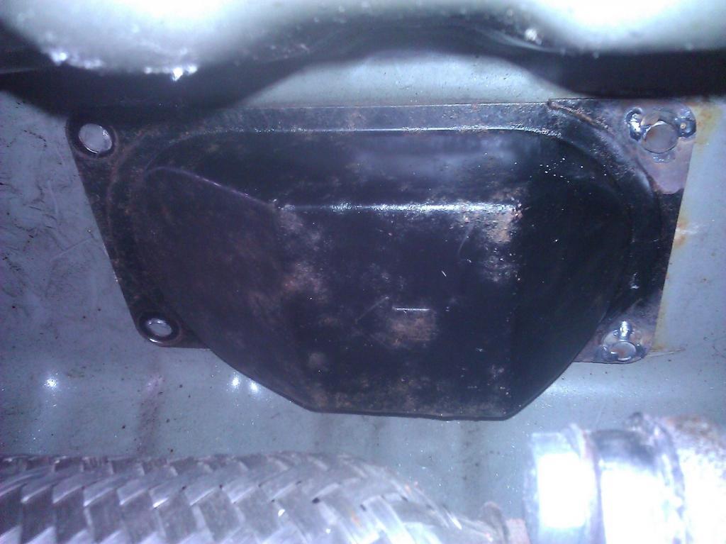

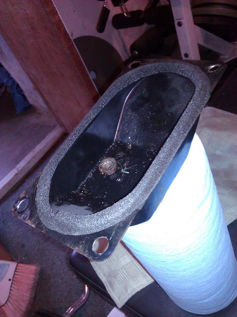

so under the advice of a OG I went back to the parts car and got this, it's a cover for the 6spd shifter to protect the bottom

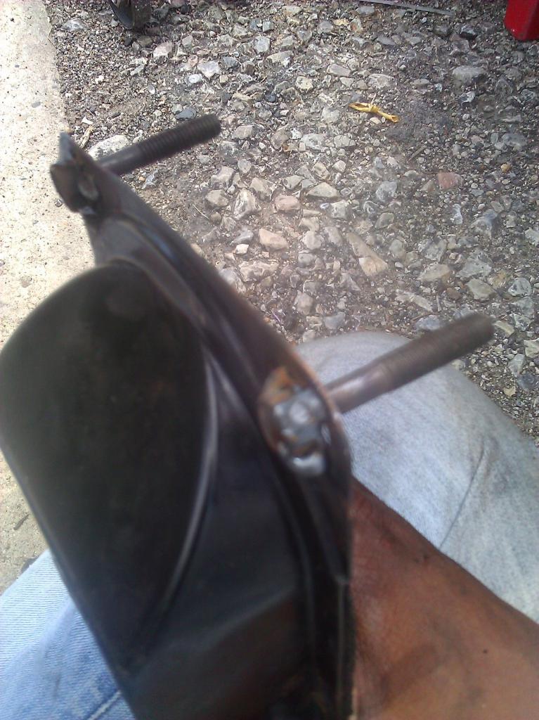

did have a extra set of hands at the time so I tack welded these bolts to it

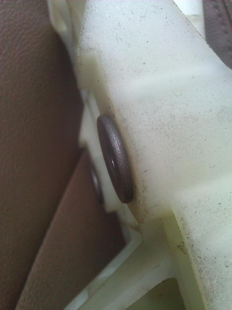

it's a direct bolt in for a 4gen and lines up great it had a foam weather stripping on it but I use clear rtv just encase

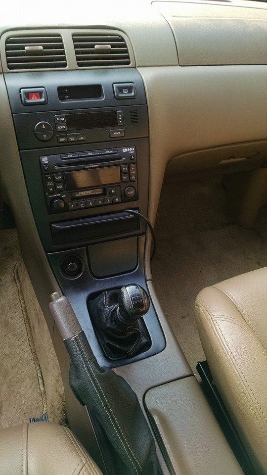

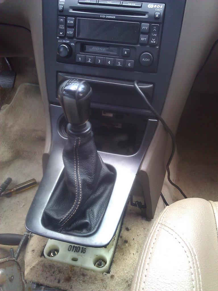

shifter installed

sneek peek

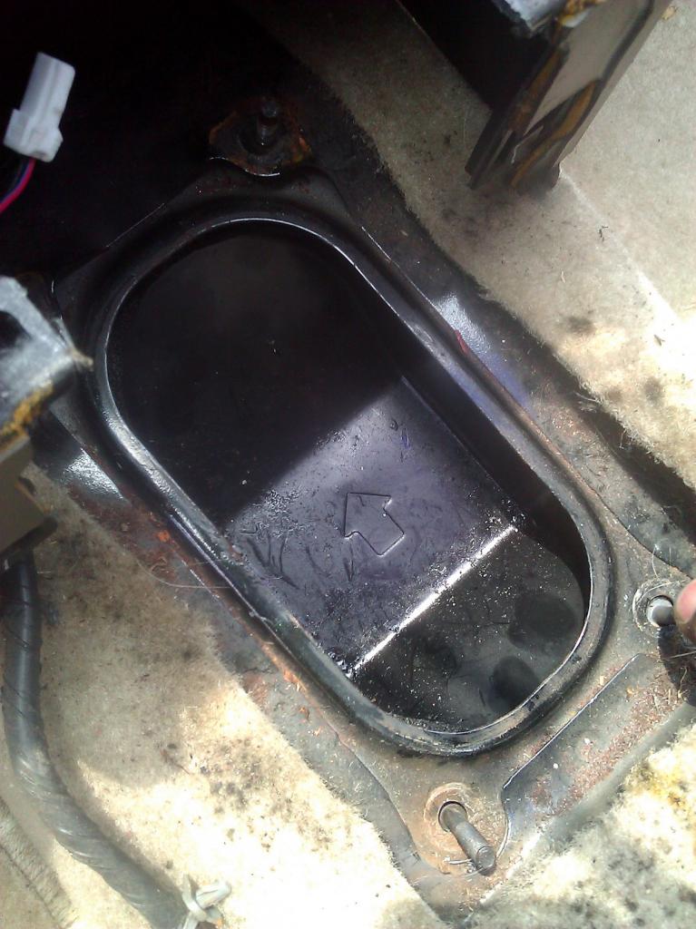

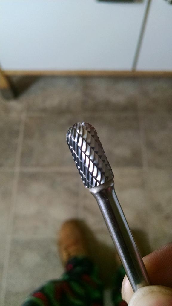

bought this to make a hole in the firewall for the shifter cables, this was a real pain in the ballz to do while the motor is in. My car was a factory 5spd not auto so the hole ws not there

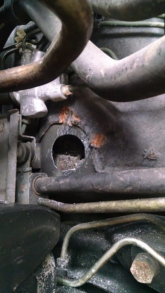

hole done and I got lucky and was able to use the factory bolt holes, fyi I'd suggest moving your ecu while doing this

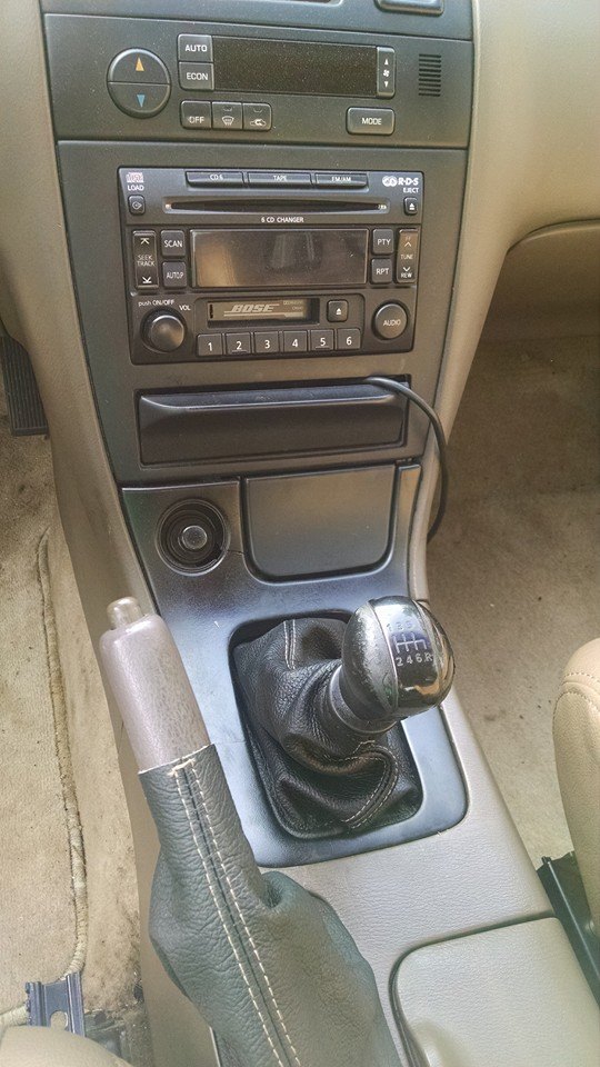

interior all back together

Hows the shifter with the new 6speed? Just curious as I am about to do this soon enough and I have an auto trim.
Old Jan 1, 2015 | 06:35 AM
  #336
t6378tp's Avatar
Turbo 3.5
iTrader: (69)
Joined: Dec 2005
Posts: 7,785
From: Philly
shifter is fine, it doesn't have same connect feel as rods but whatever

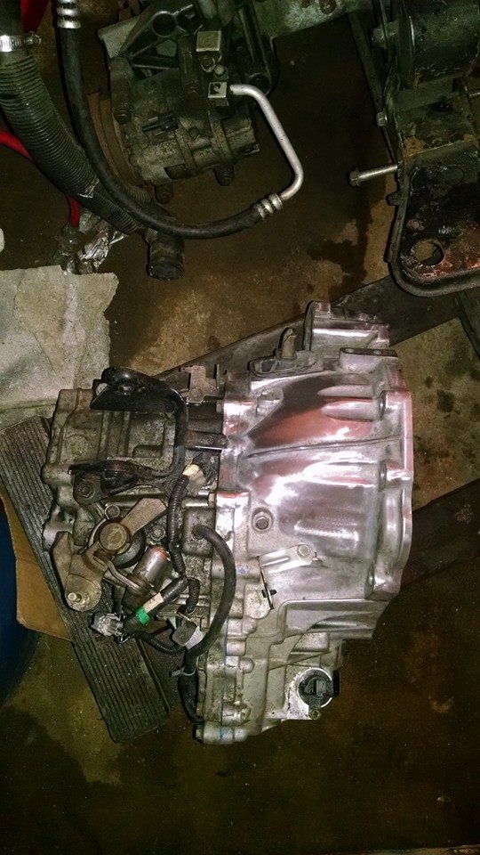

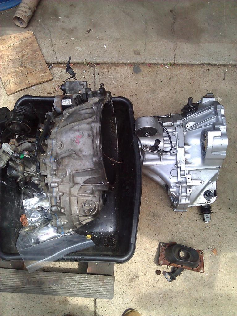

old 5spd trans is out and small compared to the 6spd, time to clean up the 6spd alittle too

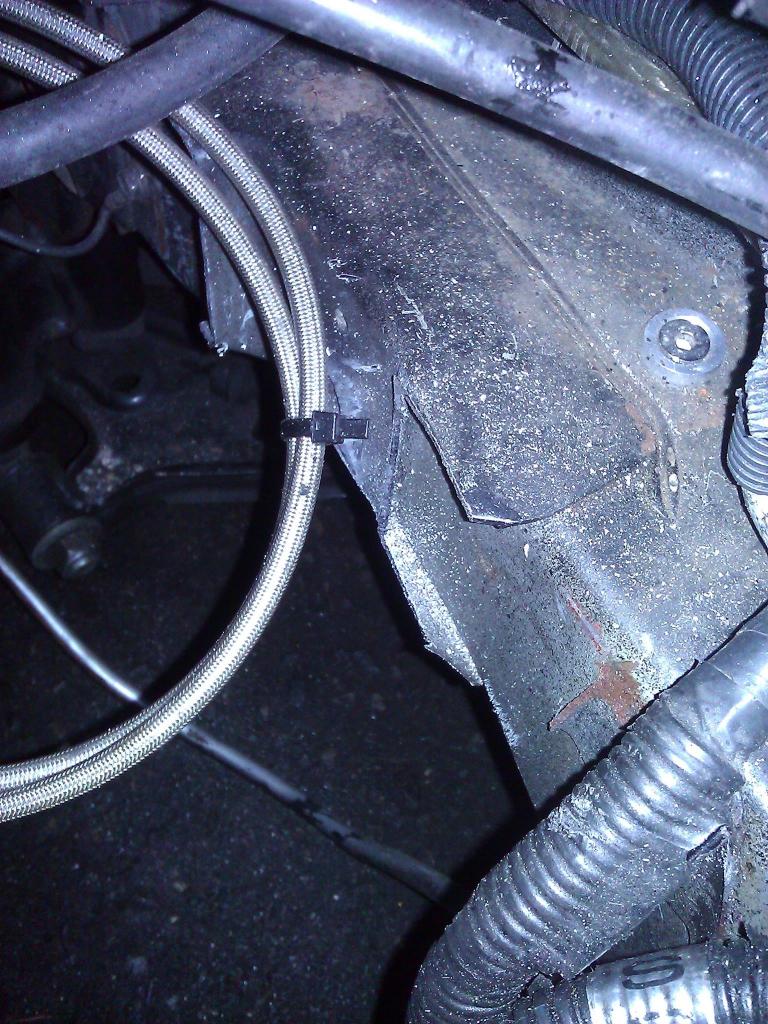

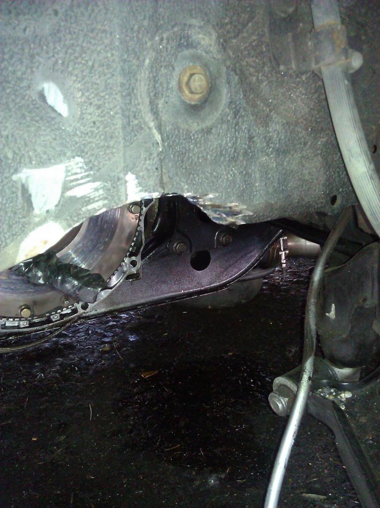

notched the inner fender to make the install easier

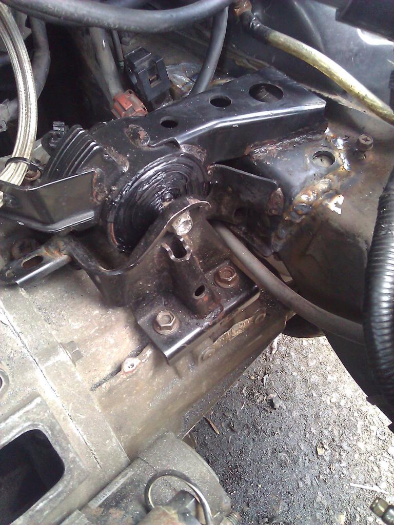

used a empty 6spd trans to locate the trans mount and weld it on

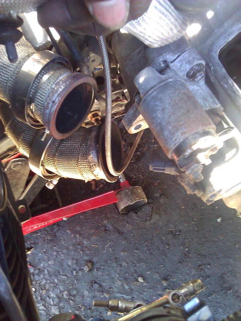

had to grind the engine the ground to clear the ss clutch line on the slave

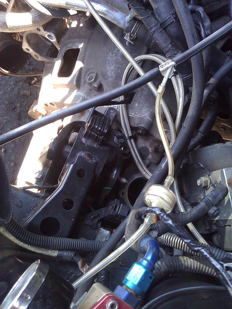

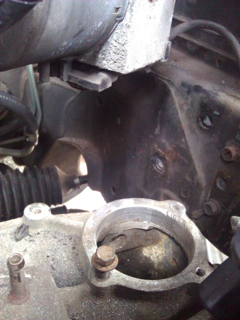

soooooooo it looks like my turbo kit will not clear the starter, I'll deal with that at another time

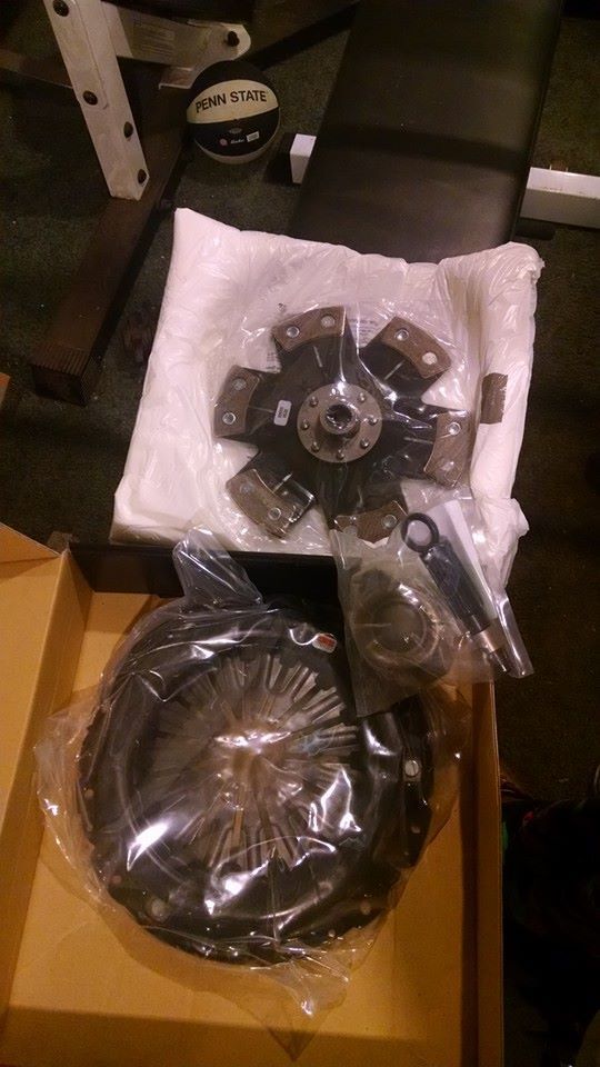

new CC stage 4 unsprung clutch

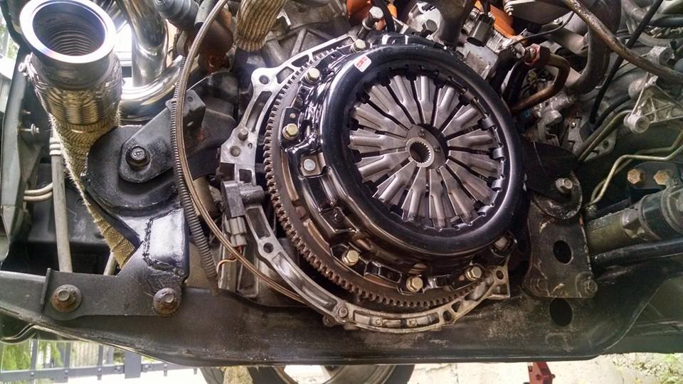

clutch and 6spd swap flywheel installed now time to make a new turbo kit

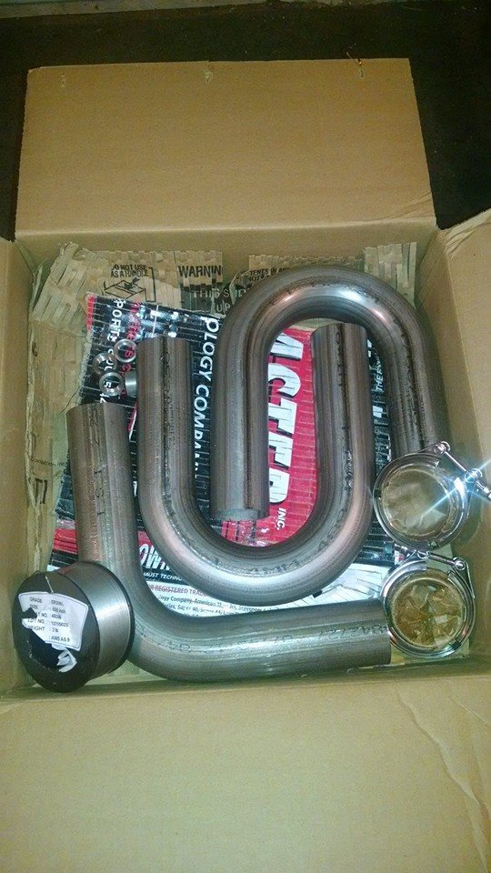

so the old turbo kit did not clear the 6spd starter and it was easier to just make a new than than mod the old one so I sold it

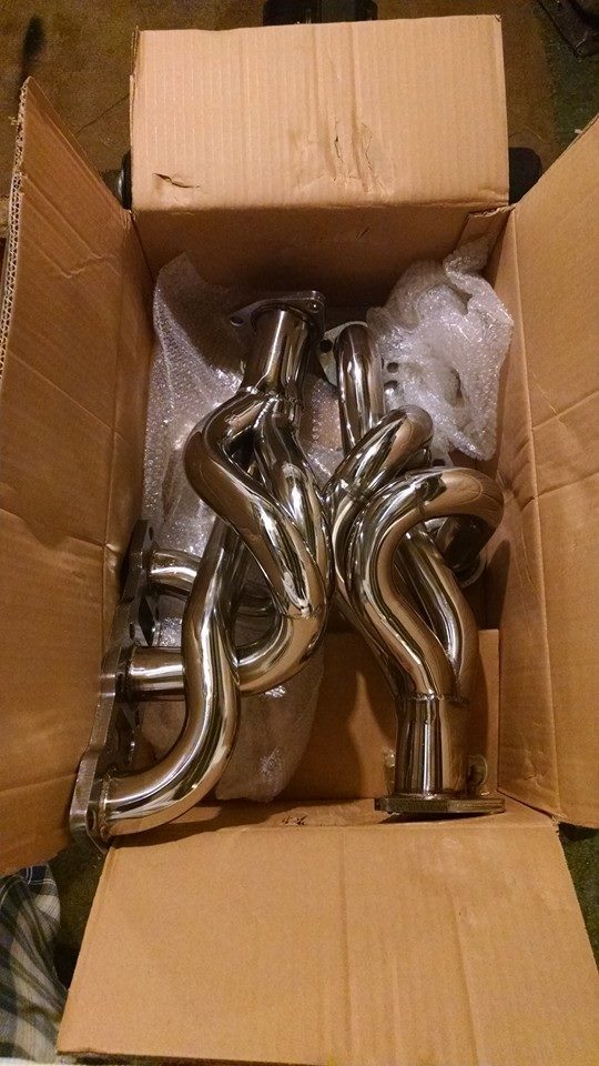

going to try something new this time, here's alittle sneek peek
Old Apr 11, 2015 | 01:21 PM
  #360
Quickywd01's Avatar
iTrader: (16)
Joined: May 2007
Posts: 3,078
From: NorthernNJ
Reverse header setup is going to be amazing!!!
