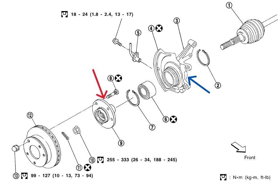

I'm replying to an old thread, but I'm hoping that there is someone out there still reading this stuff....
I have three broken studs (hub bolts) on my daughter's 2002 Maxima (5th gen). I thought that I could easily remove the hub and hammer out the bolts. After reading other threads about removing the wheel hub, I think it might be easier to get a PhD in String Theory Physics or worse, try to understand the value of bitcoin. LOL
Per the attached drawing from the service manual, can I simply rotate the wheel hub until the hub bolts (RED ARROW) align with the opening on the knuckle (BLUE Arrow) and hammer the bolts out towards the drive shaft?
Is there enough clearance on the knuckle to allow the hub bolts to be removed this way? If so...
1) Do I put the transmission in NEUTRAL to rotate the hub into position, then put the transmission back into PARK to lock the hub while I hammer?
2) Is there anything more specific (other than disconnecting & moving the brake caliper and ABS sensor) that I need to know about, beware, do, or avoid when doing this procedure?

You only need to remove the wheel, caliper/pads, and rotor. Put the car in neutral and spin the hub for maximum clearance. The new stud/bolt can be pressed in with a spacer and a lug nut or get a specific tool like the Lisle stud installer 22800. https://www.lislecorp.com/specialty-...stud-installer

Yup, it's pretty simple, I recently replaced all of mine with a big hammer and the Lisle tool JSutter posted. There's no need to remove the hub from the car.
