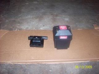

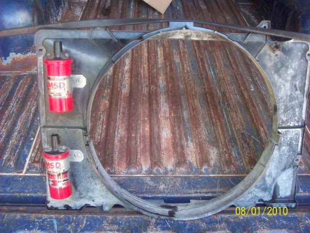

Yes in my opinion those Nissan epoxy coils do suck and don't last that long for the amount of money you put down! I'll be honest the evidence as I experinced alot of coil missing under load during normal accelerations and The coil would test fine....Well I got tired of them on my D21 Hardbody( no problems for 10 yrs) and I replaced them with the most reliable coils I ever known since being a kid!!!!! Oil filled coils never failed and if they did it was due to the oil leaking out of them! I never saw my Dad or Uncle ever replace one on the many cars we had and some for a longtime.... Here my fix for the 1990 Maxima with a VG engine that I'm running an Ignition box on..but any oil filled MSD, Jacobs, Mallory, Unilite, Pertronix will work....There's a plug for the tranny on most Nissan that you can cut off of any junk yard car and make this a PNP setup....
Maxima ignition coil

D21 ignition coils (8 plug system)
