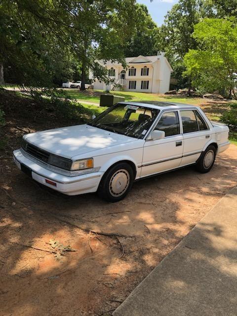

First off, this is my first maxima in a few years.. I've owned many 3rd and 4th gens, mostly black on black se manual models, which have become hens teeth in any generation, and this is the first 2nd Gen I've actually owned (not counting the 2 tone taupe 86 an ex girlfriend owned that actually kind of got me into maximas in the first place over 20 years ago) . Picked it up extremely cheap from a dealer who wanted it out of his back lot but had to tow it home.
I've got it up and running and other than a hole in the muffler somewhere it runs and drives smooth and quick and doesn't appear to be too poorly maintained. However there is an electrical gremlin or 2.. The AC, blower motor, wipers, and radio do not turn on, plus there is a clicking sound coming from the dash and a Sensor light on.
I don't know if it's all related but if anyone has a clue where to start I'd really appreciate it.
