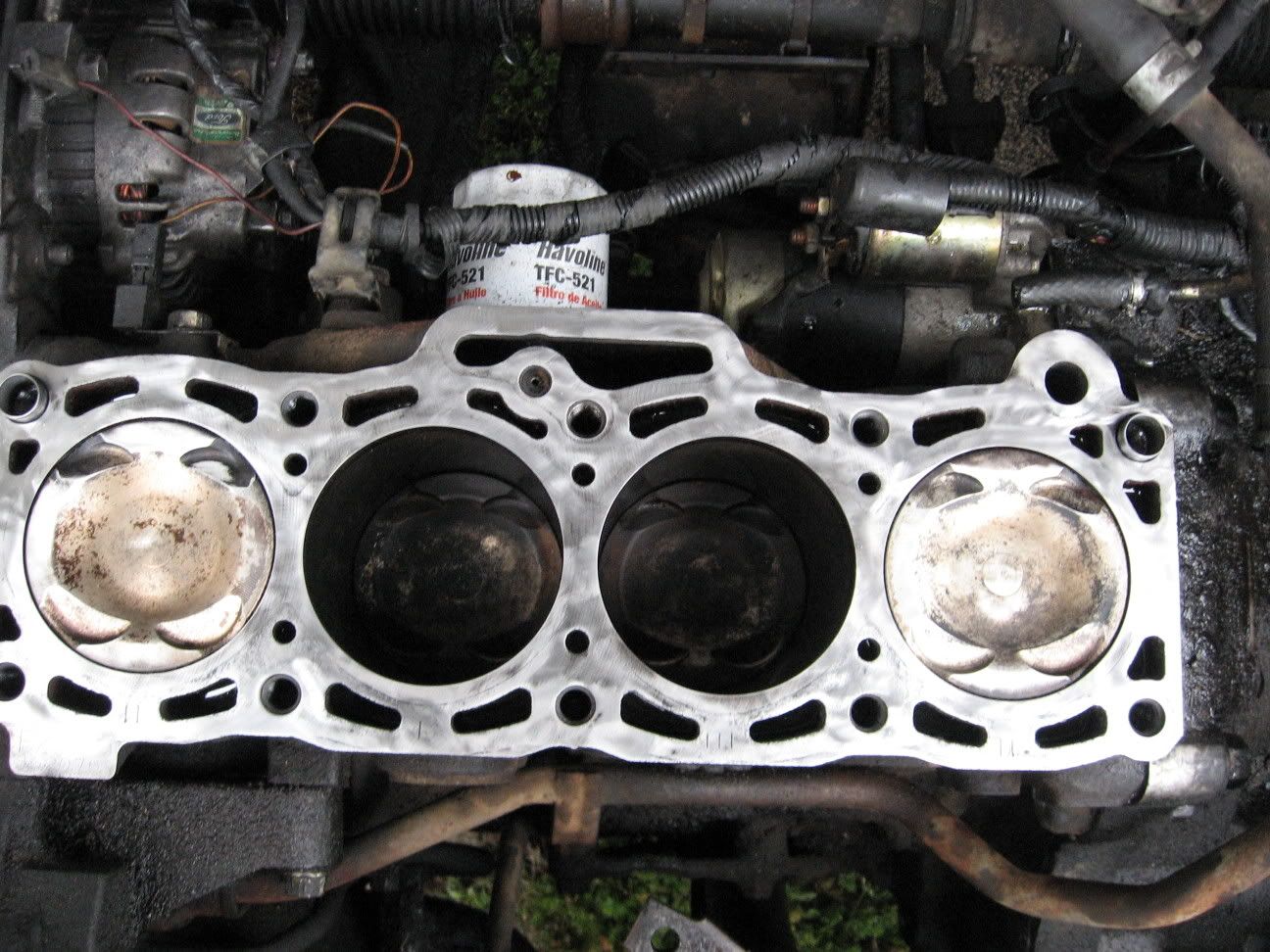

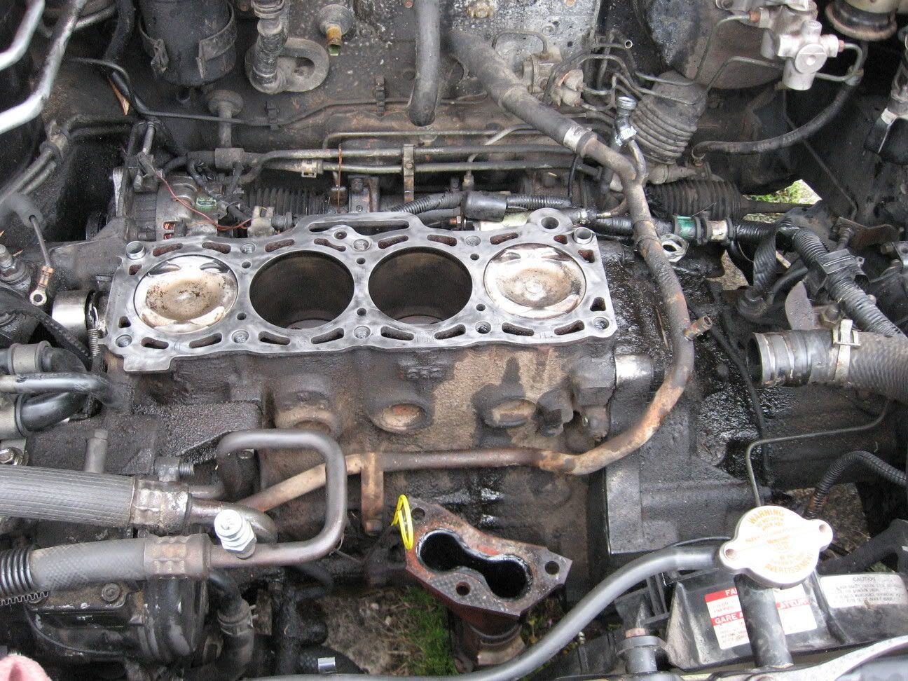

o ok. always along the same place? mebbe a little piece of old gasket stayed stuck onto the LIM? same thing happens with head gaskets. i spent an hour buffing my friend's deck when we did his. an hour later... has bad rings so compression is 30psi short across all cylinders but at least the head is on good. so mebbe you should double-check to be sure there's no obstructions or anything on the mating surface.

nono what we were doing was a head gasket. we polished his block's deck for an hour with a felt pad and a diegrinder... you don't use RTV on a headgasket.
