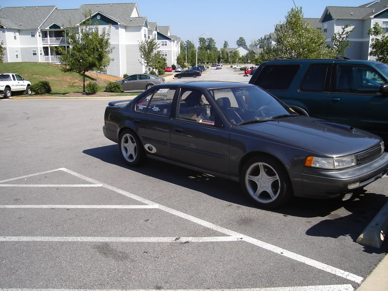

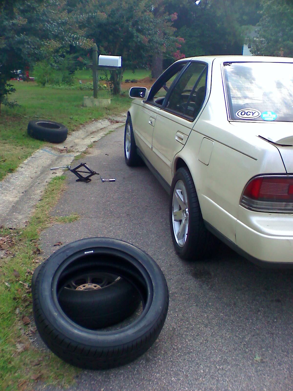

Meanwhile the 17x7 5.5gen wheels fit just fine... offset of +40-ish.

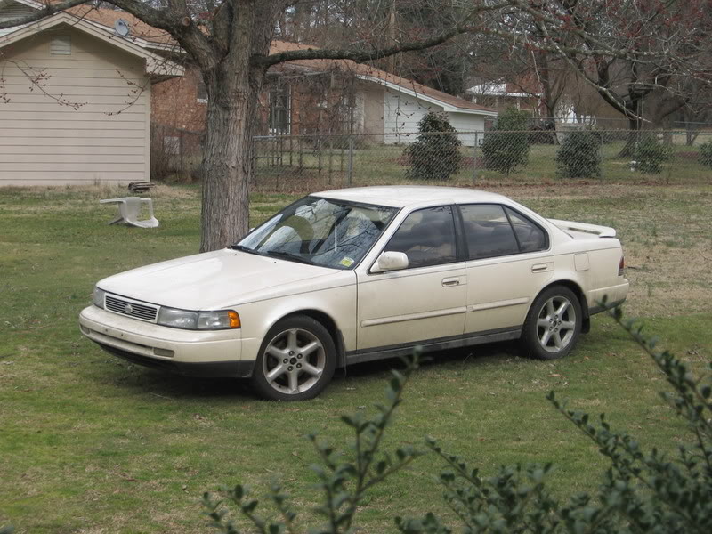

Old Mar 17, 2013 | 07:29 AM
TonyJr's Avatar
Joined: Sep 2011
Posts: 1,048
https://i.imgur.com/nxfdpi9.jpg
Thanks for your inputs just install the rims n it look great. I just need to lower it n paint same color
