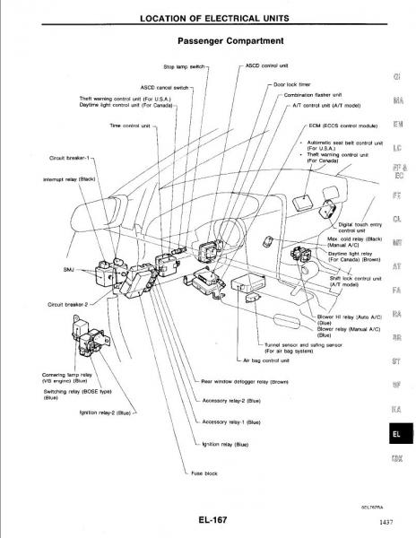

In this attached diagram, what module is the correct one to check? I didn't see any with the name you were describing.
Thanks for your help. I hope I can get this damn thing fixed.
Can't seem to zoom in much on this diagram. Did you unplug the regulator to stop the window from going down?
