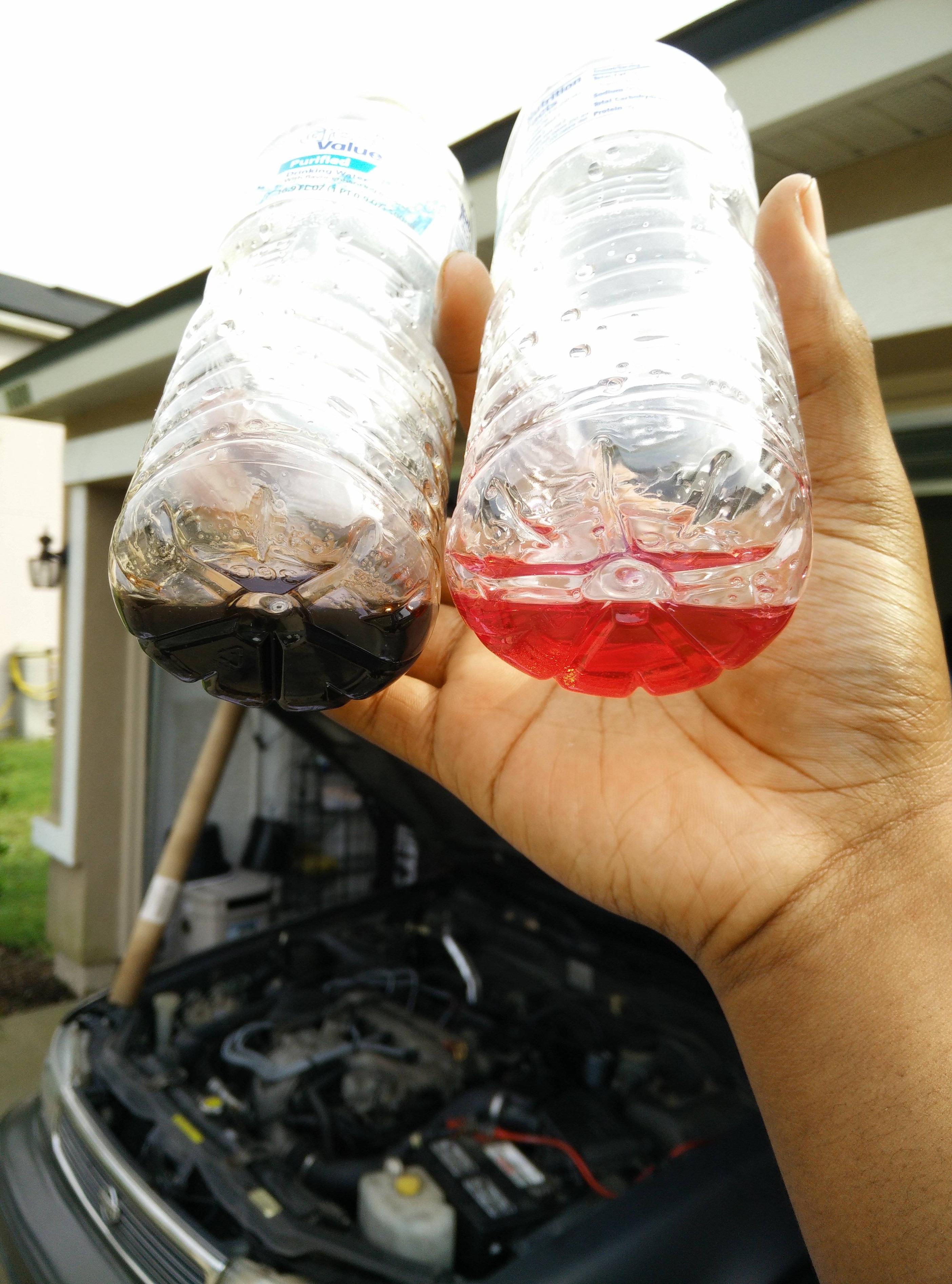

Old Apr 28, 2015 | 09:12 AM
Ray229Harris's Avatar
Joined: Jun 2013
Posts: 85
From: Fl,USA
Originally Posted by ac max 92
Check your fluid level and change the fluid if it's a brownish colour. See if that helps then check back.
Gonna repeat the process in a week or two and check back again.
